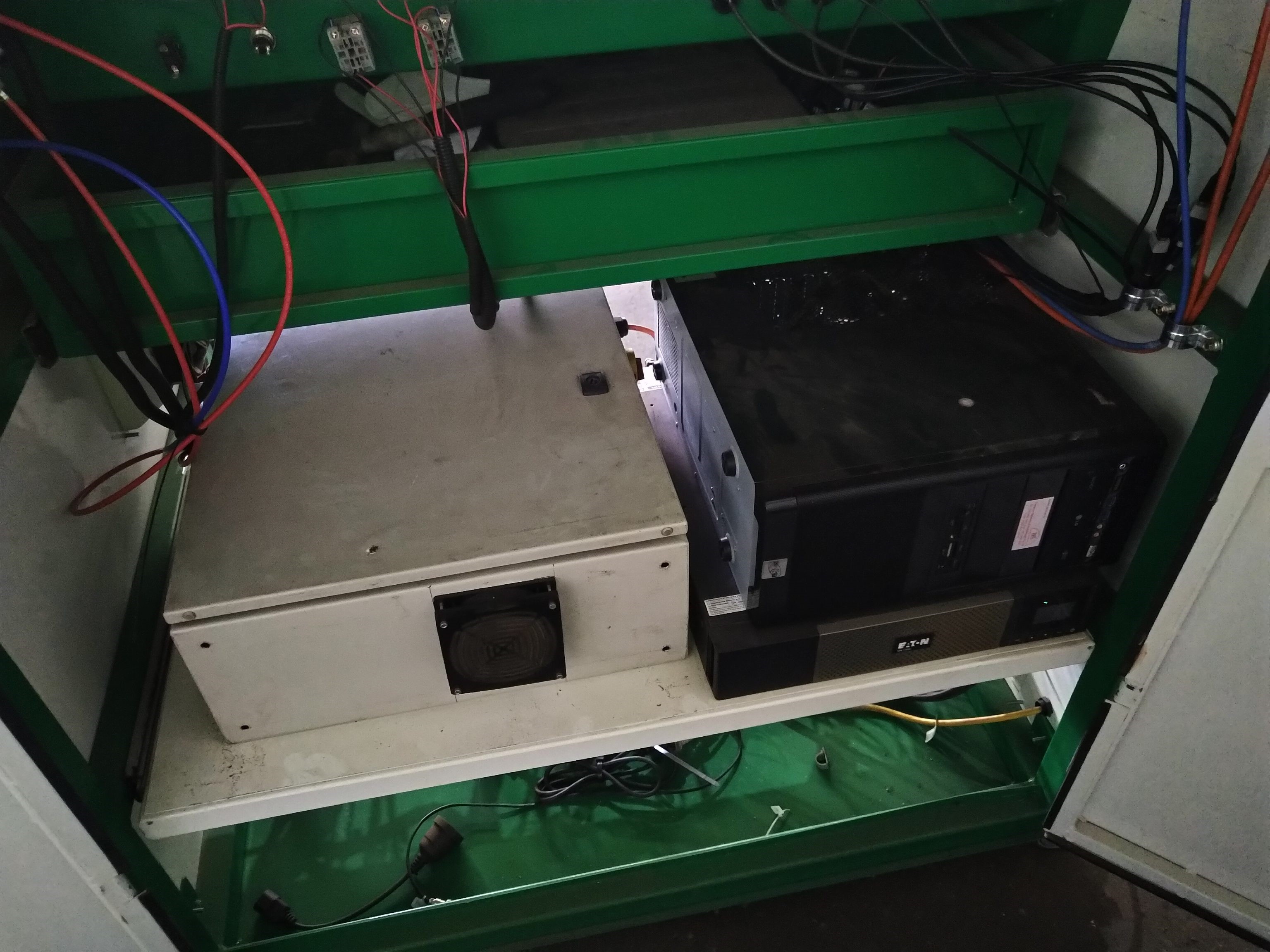

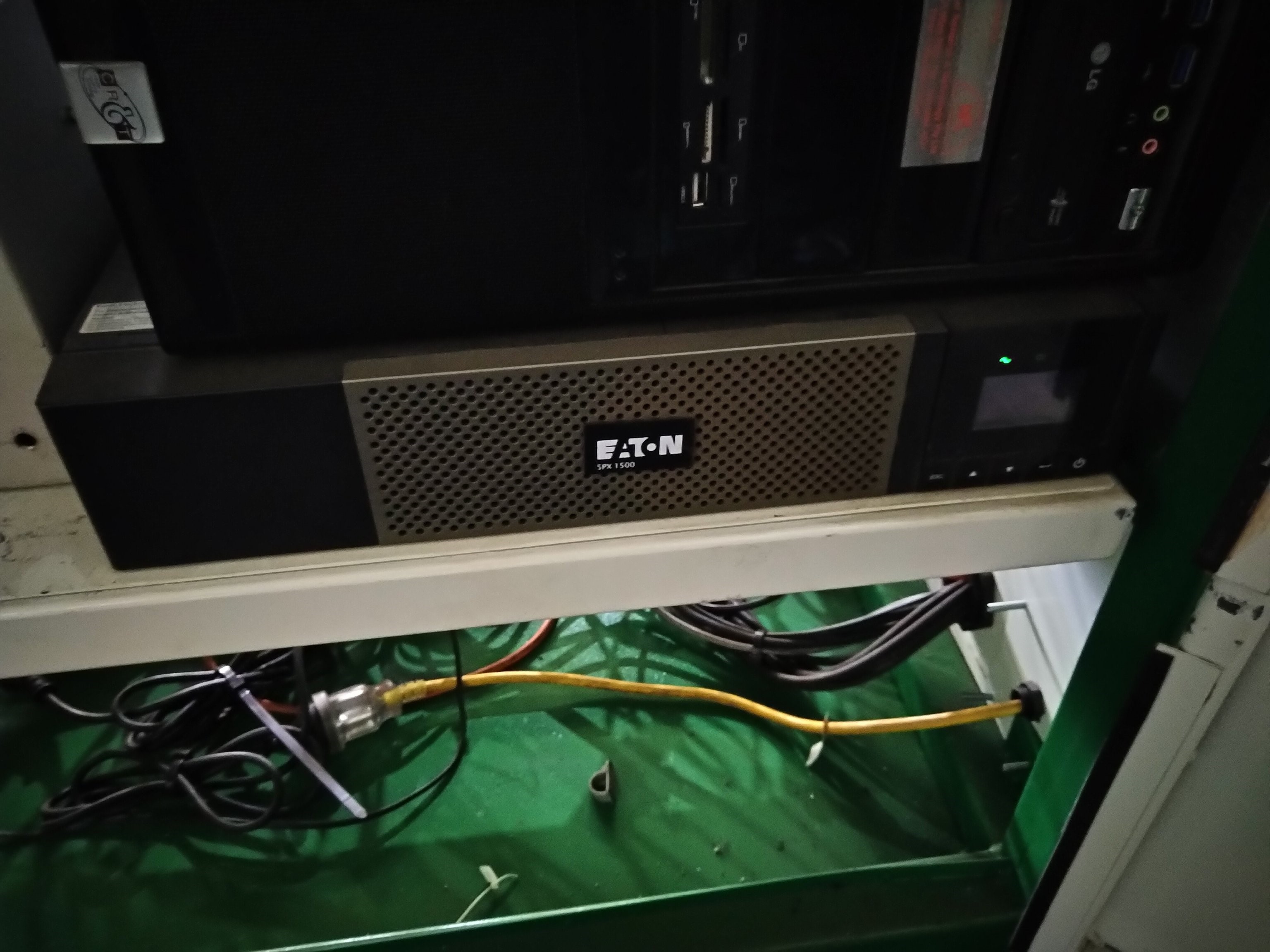

This is my UPS, its a Eaton 5XP 1500.www.eaton.com/nz/en-gb/catalog/backup-po...n/eaton-5px-ups.html
The tech I worked with to size the unit told me to stay clear of the standby UPS's in my situation as they are not fully online like Rod mentioned. I did look at those UPS's from officeworks and asked the tech about them and he laughed.

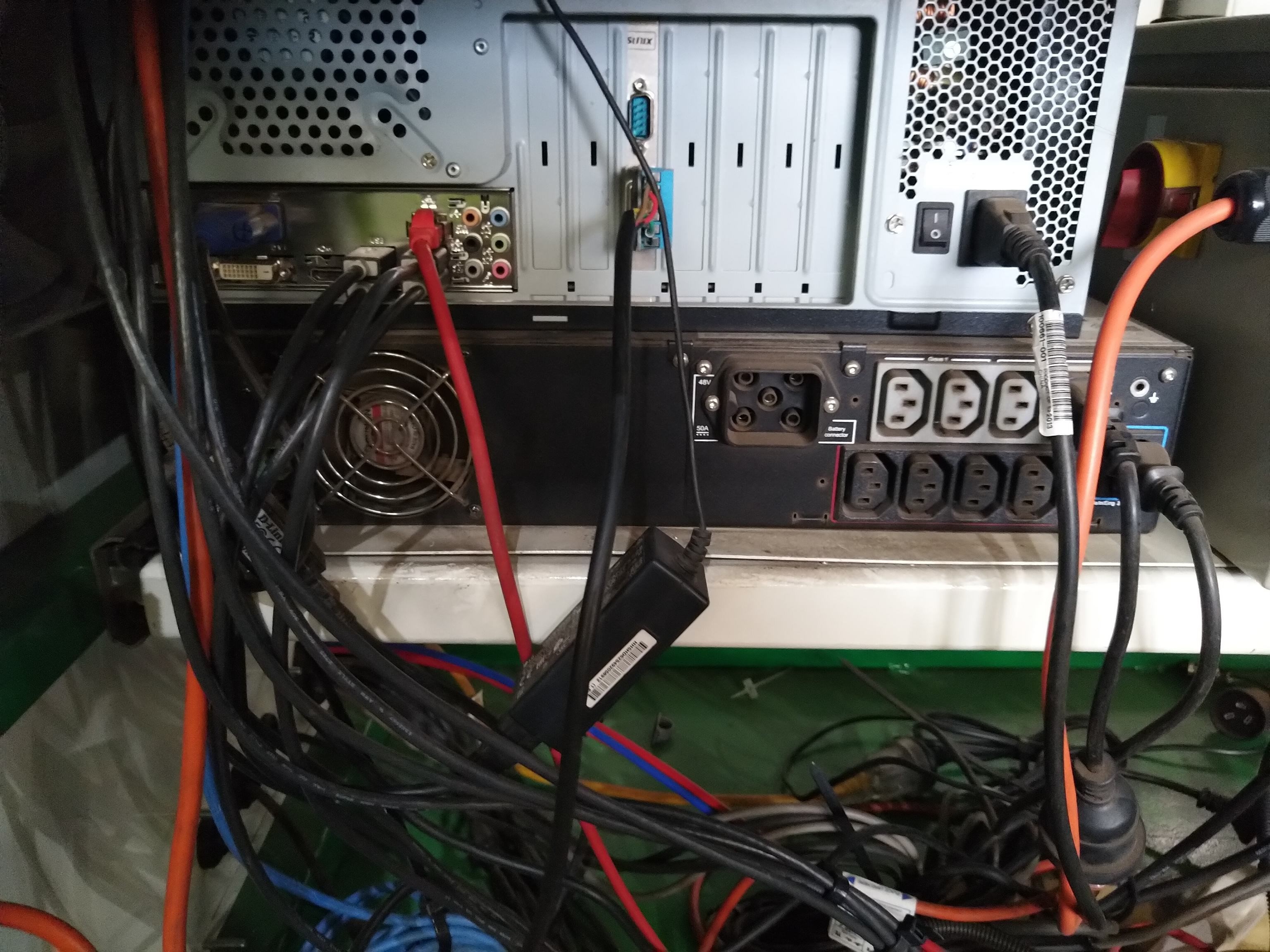

this Cable "Junk" wilkl at alot of EMI and latency try to clear this up

If you referring to my pictures, yeah the cables are a bit messy but they are longer than the space I have allows so I have bundled them up as well as I could. I has been a lot worse in the past! But I do have a couple more cable management glands I have been meaning to install to make then a bit neater. Another project on my list!

bundle worst case
keep the power away from the signal
and also PC cable like USB separate
and offcause the Mouse is the thing to keep at clear as you can it will get you the Police radio with less then 10cent parts
the mouse internal coil is the most reson people got latency it takes frequence from air like hell
