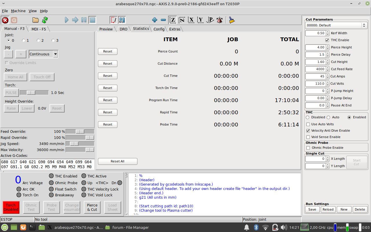

Oh no, not LIKE Tommy, BY Tommy :evil: , as you're the one insisting in high precision probing for plasma, that is inherently "not precise" in the world of CNC. Achieving 0.1 to 0.2mm precision on plasma is magnificent as that will depend on a lot of factors, from the material being cut to the quality of air used for cutting and everything in-between. Older transformer plasma sources will change the cut width from power fluctuations, new inverter ones are less dependent on power quality as they have big capacitors to deal with that and current regulation.
Back on topic:
Using 2186 build
Hmmm.... statistics are reset, i did not do that, will check why is that reset later. Still, the total run time and probe times are there, so 17 h run time, over 6h probe time seems to much, granted the amount of pierces there is astronomical.
Now as i figured it out, i will lower the probe height and probe speed some more and see how much that saves in probe time.
Bottom line is, this is the worst case scenario and i am the only one bothered by this, so i will adjust my settings and move on.
Thank you all, yes even you Rod, as you are the "Chuck Yaeger" of the plasma world, always on the cutting edge of testing new features and dealing with the issues.
