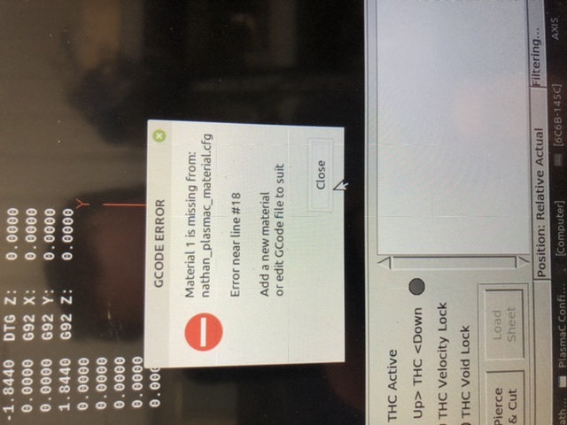

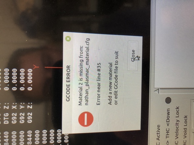

Replied by tommylight on topic THC not showing on screen
You posted them twice, so we can see them.
That error is due to choosing material number 2 in SheetCAM, but there is no material number 2 in PlasmaC, so you will either have to choose material 0 in SheetCAM or add material 2 to PlasmaC.

In fairness, for 100% clarity, Material 1 is missing as well... So same advice as above, but with Material number 1... Sorry Tommy
