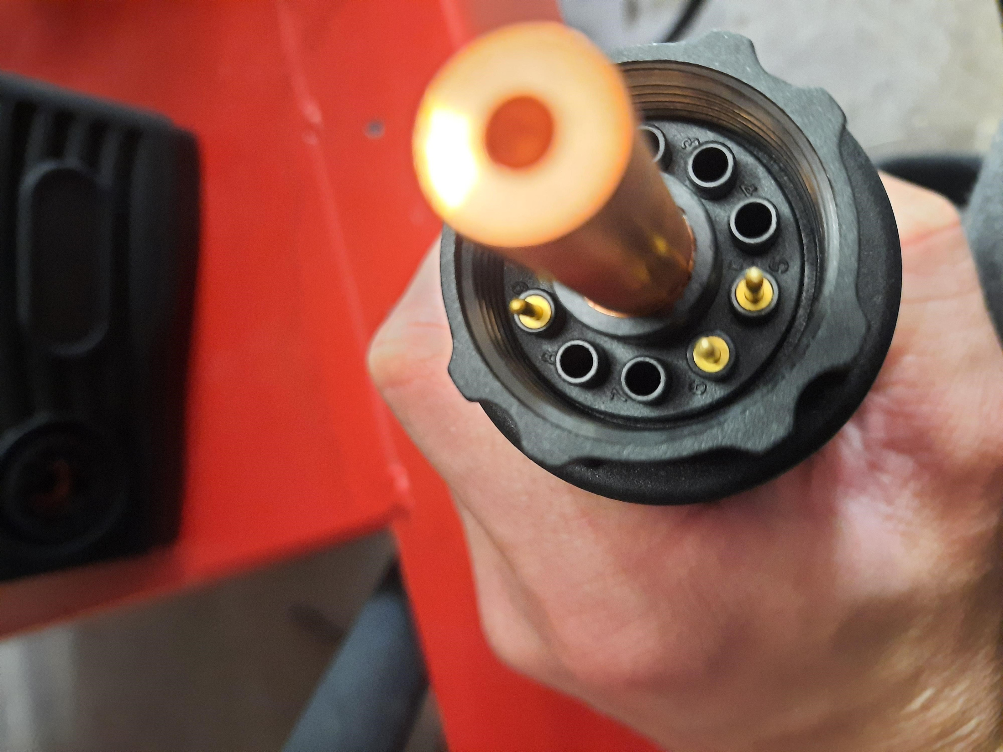

Replied by tommylight on topic Plasma no ARC OK and torch fires when machine is turned on
Did the machine torch come with the machine or was it fitted after ?
Some torches use only two wires to fire the torch and check if the torch cap is on, so when removing the hand switch they will be stuck on.
The only solution in that case would be to open the plasma and cut one of the thin wires from the torch and wire the torch on signal between that cut wire. That way the safety of removing the torch cap will still remain functional.

Replied by rodw on topic Plasma no ARC OK and torch fires when machine is turned on
I know PCW says you can use the spindle relay but I built mine before I read his advice so I trigger the torch using a relay on an output pin. If you do this and use a electro-mechanical relay be sure to add a flyback diode across the relay coil contacts with the band pointing back towards the output pin.
I would try that and edit your hal file before panicking too much.

Replied by phillc54 on topic Plasma no ARC OK and torch fires when machine is turned on
The main problem is the torch is coming on with the CNCport disconnected.

I would review the wiring internal to the torch. I know when I bought an Everlast and a machine torch, I had to modify the wiring in the torch to make it work as expected. I can't remember what the original behaviour was though sorry.

That points to the exact issue i mentioned above.The main problem is the torch is coming on with the CNCport disconnected.

the torch came from the company that makes the machine.
Replied by luftlupus on topic Plasma no ARC OK and torch fires when machine is turned on

going to make a call to the company tomorrow and see what they say, might be missing something internal.
ill stick using the spindle relay for now but ill keep it in mind.

So did mine. It was delivered with the machine.
