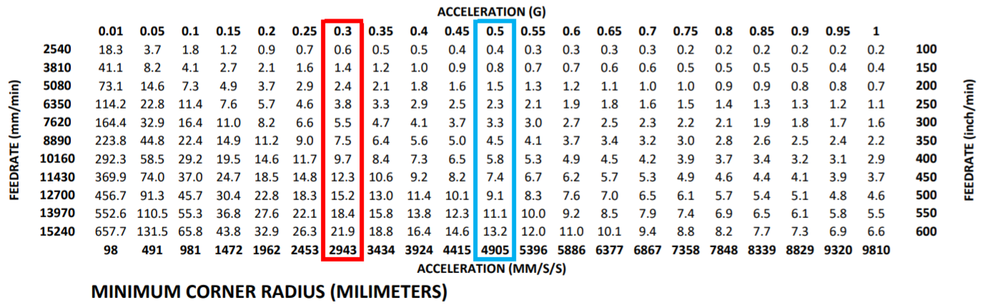

Your arc might be too tight to negotiate at cutting speed. This table might help understand whats going on re velocities on arcs if you refer to your acceleration settings

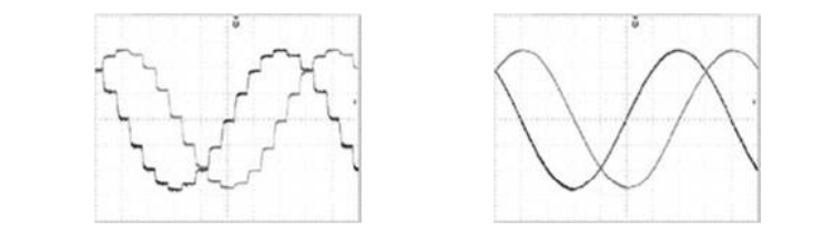

But if everything checks out, my bet would be that the G540's fixed 10:1 microstepping is not sufficient to smooth the motion. This diagram is from the Lam DS1076 manual and shows the difference in motion smoothness between 1/4 step 800 step/rev) on left and 1/128 step (25600 steps/rev) on the right. (The G540 is 2000 steps/rev)
You can see how this could introduce inconsistent motion that might result in ripples in cuts.
On my old drives, I used 25x stepping (5000 steps/rev). I am still using that with the Lams but its on my to do list to increase that.
The limiting factor becomes the step length parameters but with the Lam's they can be shortened significantly.
I've never observed a reduction in torque with high step rate frequencies.

rodw wrote: Your arc might be too tight to negotiate at cutting speed
Some of the arcs are quite large. I don't think the 10micro steps is an issue as when I had the G540 on my mill all the arcs from that were perfect.
I really do think it my resolution due to the GT3 belts and 16 tooth pulleys giving me 48mm of motion per rev. I just saw a mention in this thread and hoped (prayed) it may help this issue as I am trying to put off building some reduction sets. I guess I need to get off my butt and build them...
