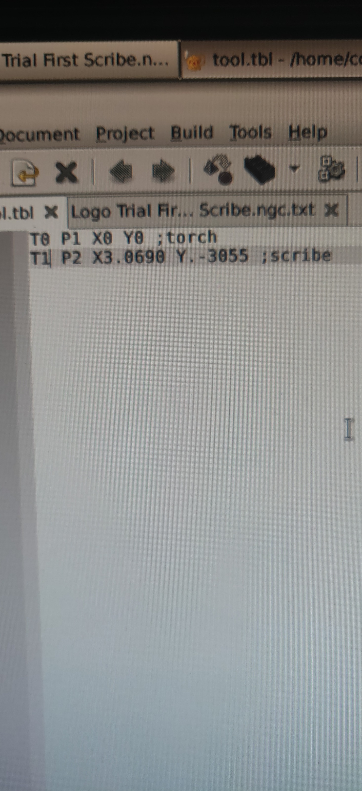

I was able to make my offset changes in the tool file, but I'm now getting an error when I try to run a program utilizing the scribe.
The error says "requested tool 1 not found in the tool table"

20 Jul 2020 16:07 #175263 by snowgoer540
Replied by snowgoer540 on topic Plamsac air scribe set up
The problem might be the negative sign in the wrong place, you have:
T1 P2 X3.0690 Y.-3055 ;scribe
it should be:
T1 P2 X3.0690 Y-.3055 ;scribe
