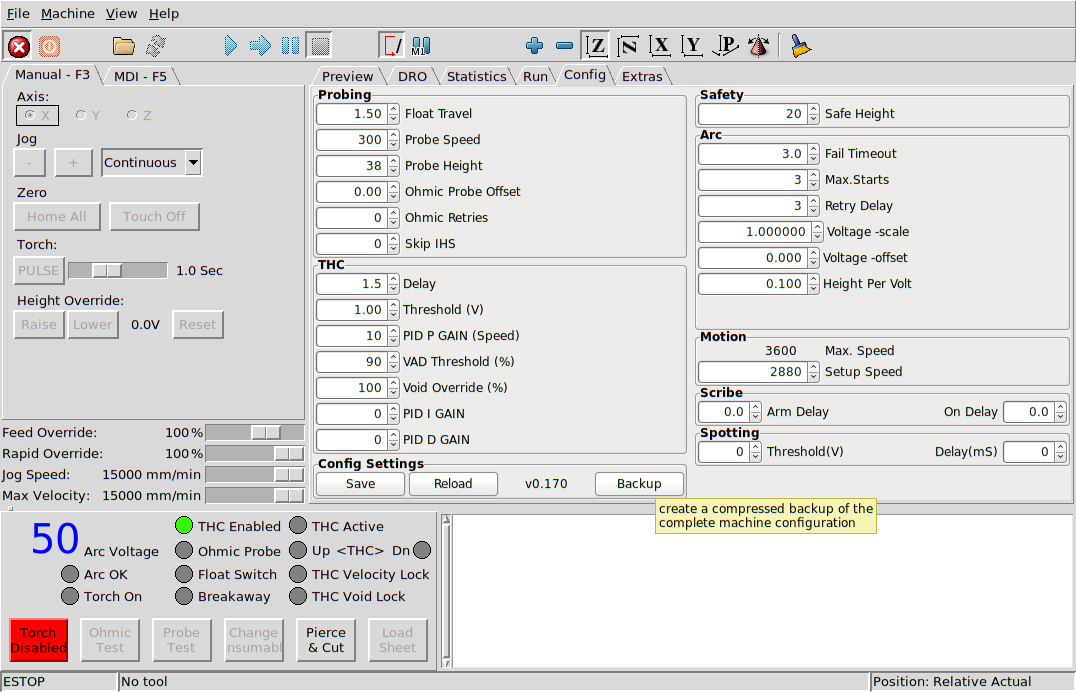

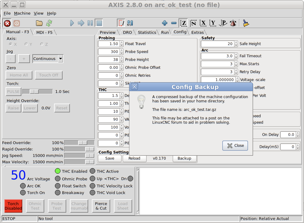

04 Sep 2020 09:55 #180639 by phillc54
Replied by phillc54 on topic Feature Request
A preview of the config backup:
Warning: Spoiler!
Warning: Spoiler!
The following user(s) said Thank You: tommylight, snowgoer540
  • snowgoer540
  • snowgoer540's Avatar Topic Author
  • Offline
  • Moderator
  • Moderator
04 Sep 2020 10:38 #180649 by snowgoer540
Replied by snowgoer540 on topic Feature Request
This is Awesome!!! Good work Phill. I suspect this go a long way to help a lot of people get their tables sorted out.
