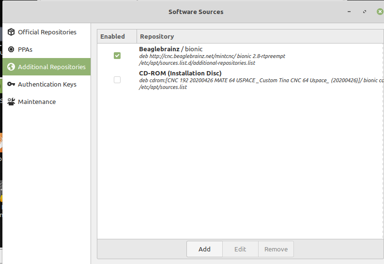

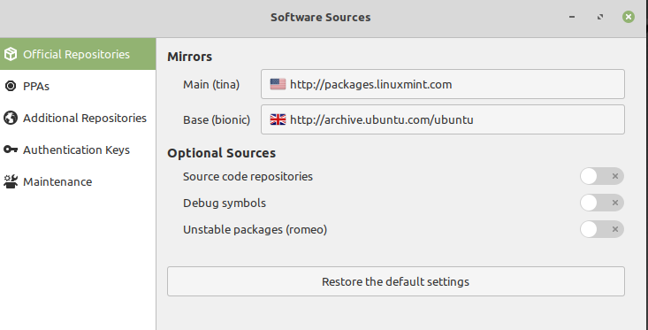

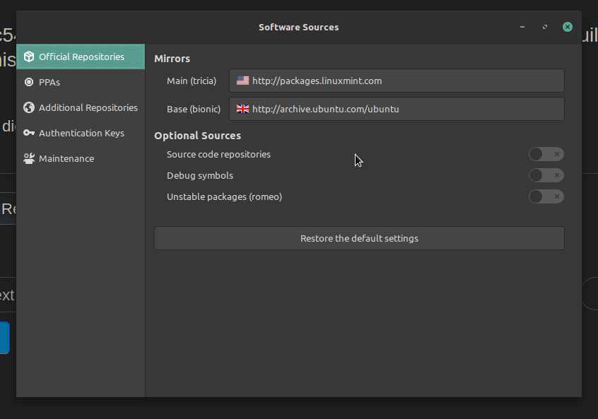

Replied by Clive S on topic PlasmaC not updating
When opening "software sources" from the administration menu:
The two flags, just click on them and choose what seems closer to you, let it update and close.
This has nothing to do with LinuxCNC updates, just Mint updates.
I see that that there is an additional rep.

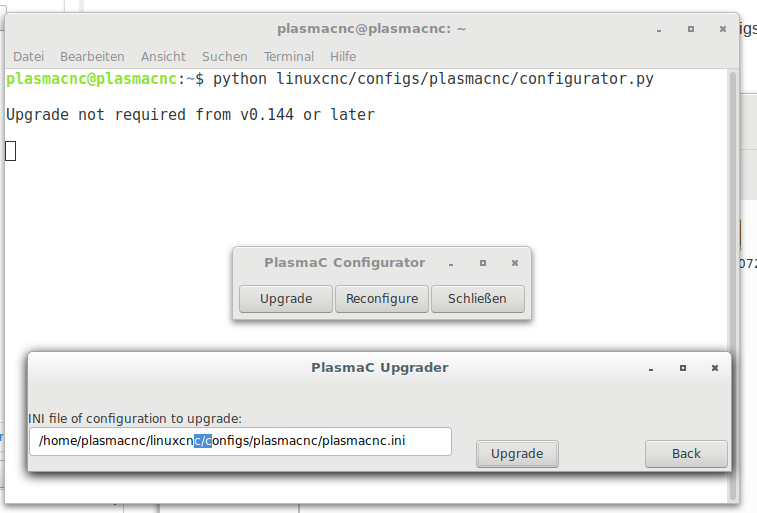

Hello,
Unfortunately, I don't get an update from PlasmaC to the latest version v0.163 - 2020 Aug 18.
I always get the message:
"Upgrade not required from v0.144 or later"
What can i do?
What can i do?

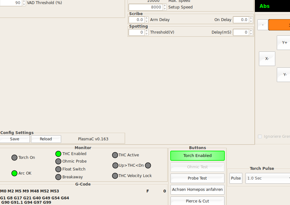

That's just the configurator portion which does not require an update every time. In fact it should do this automagically if an update requires configurator to be re-run.
On your config tab, what version do you show there?

Replied by hermann1976 on topic PlasmaC not updating
I'm sorry, command back.
Unfortunately I didn't see it.
It is the last version.
Many Thanks
Many Thanks
