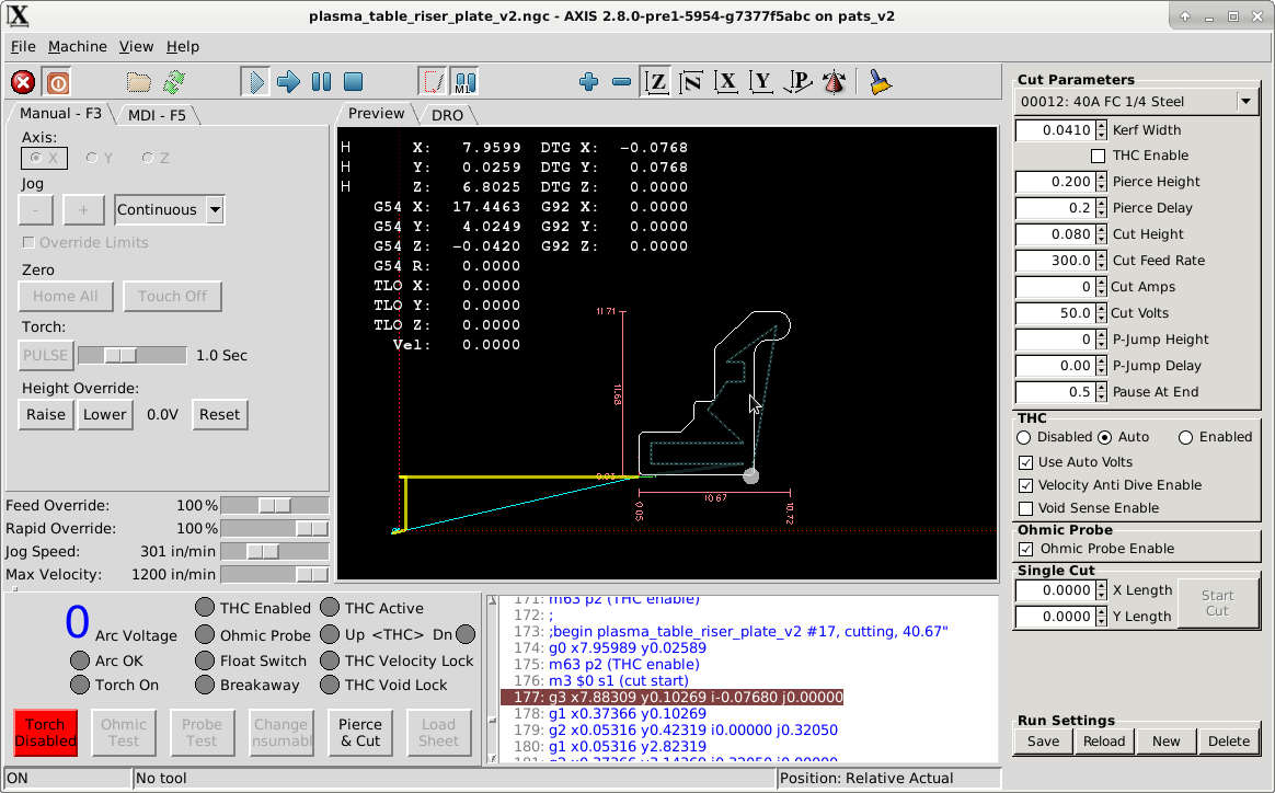

Machine configs done...all axis home perfectly.Machine jogs, Z moves up and down within limits.
Load gcode cut file to do a dry-run on (plasma off). Press play and then two of the tabs are missing (stats/config), and all of the tool files read wrong....worse thing is the Z axis will not move from gcode.
Uploading the ini, hal, and connections.hal. This is an older gcode file I've cut before on v1 of my machine.
Edit: Added pic of the screen showing the missing tabs next to the captured mouse pointer.

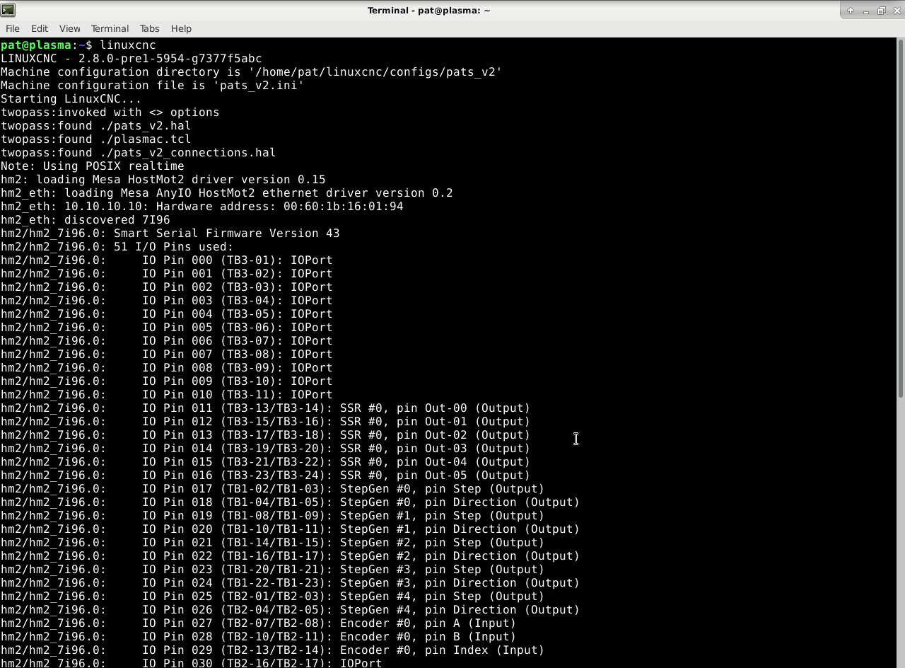

The missing tabs usually mean an error when loading LinuxCNC.
Could you run it from a terminal and check for any error messages.

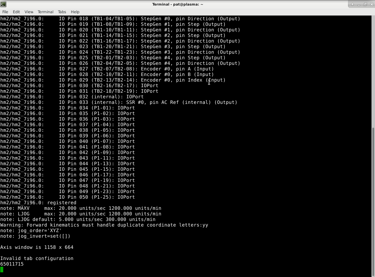

30 Jul 2020 02:00 #176446
by dvn4life1972
Replied by dvn4life1972 on topic PlasmaC Will Not Move Z
- phillc54
- Posts: 5711
- Thank you received: 2100
30 Jul 2020 02:04 #176447
by phillc54
Replied by phillc54 on topic PlasmaC Will Not Move Z
Try commenting out this line in your ini file:
EMBED_TAB_NAME = Run
The following user(s) said Thank You: dvn4life1972
- dvn4life1972
- Posts: 401
- Thank you received: 173
30 Jul 2020 02:22 #176450
by dvn4life1972
That did it. And Z moves on dry run.
