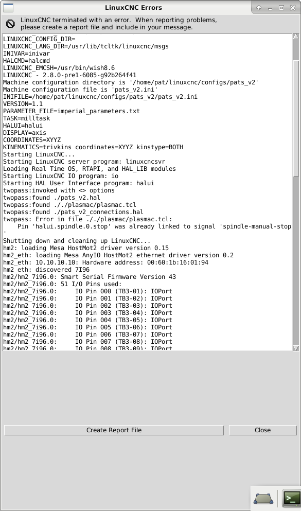

I noticed that my plasmac ver. on this machine was v134. So, I decide to go ahead and update/upgrade and when I go to open linuxcnc/plasmac I get this error. This was not the case prior to the update/upgrade, it opened flawlessly.
The .tcl file (included here as a .txt so it would upload) has a warning at the top saying not to make changes. Can anyone help?
Edt: added txt file of error report

Yes, Phill added that pin to the .tcl to correct some stuff that was going on with Plasmac (fixed some bugs).
Open your <machine_name>.hal and comment out the following line (put a # in front of the line):
While you're in there, comment these out as well:
Should be good to go.
net spindle-manual-stop halui.spindle.0.stopWhile you're in there, comment these out as well:
net spindle-manual-cw halui.spindle.0.forward
net spindle-manual-ccw halui.spindle.0.reverseShould be good to go.

That did it, thanks!
