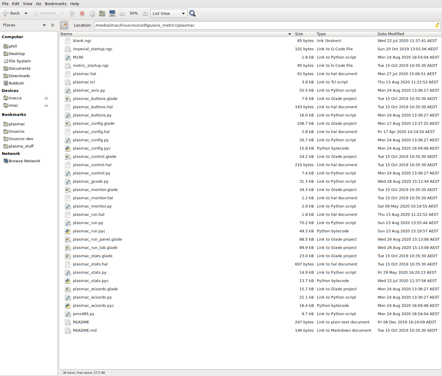

The plasmac directory is incomplete, it only has the pyc files.

- phillc54
- Posts: 5711
- Thank you received: 2100
26 Aug 2020 06:18 #179500
by phillc54
Replied by phillc54 on topic Recent PlasmaC Update and No Motion
