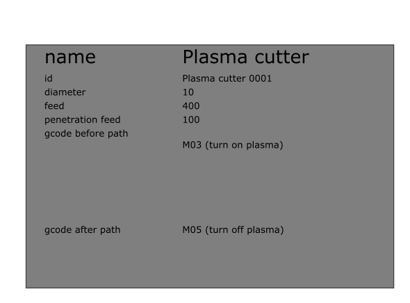

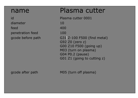

In Inkscape when the drawing is finished go to extensions>gcodetools>tools library, choose plasma and click apply then close, now select that green window and select the text tool, edit the green window by removing lines with G31, G92, Z anything, leave just the lines with feed, tool, M3 and M5.
After that do the usual extensions>gcodetools>path to gcode.
In the folder where the gcode will be saved create a new empty file and name it "header", save it. That will get rid of the first M3 at the top of the gcode so it does not mess up the material.

In Inkscape I've changed from
to
I think I know where I've screwed up :(
The feed rate on my 3mm steel, from tests is 4800!!! I've left Inkscape params unchanged so the g-code was generated for 10mm with feed rate 400...
Am I right?
