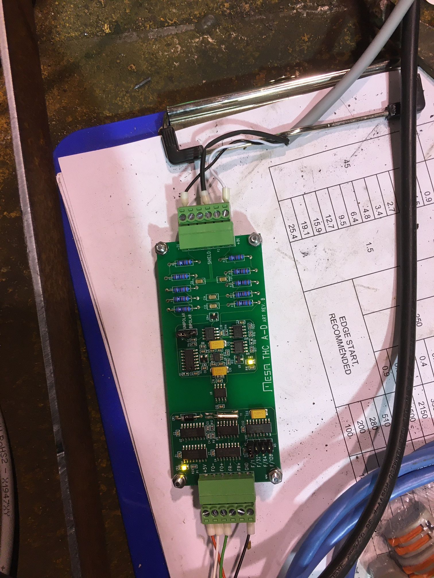

My board arrived and I've connected both sides of the board but I'm struggling with HAL.
My FO+ wire is connected to LPT2 IN PIN 15 (parport.1.pin-15-in), Hypertherm is set to 20:1 voltage divider.
I would appreciate some help or even an example of HAL file with THCAD-10 connected.
I have added my plasma_connections.hal below. I've removed existing UP/DOWN move inpus from my non-functioning DT-115 THC.

30 Oct 2020 22:05 #187843 by PCW
For use with a parallel port, FO- is left unconnected
You need to load an encoder component to use the THCAD's frequency output

30 Oct 2020 22:40 #187847 by radek_marko
Tommylight and PCW - Thank you very much. I will test it tomorrow.
I was searching for the phrase ENCODER and found the following in the documentation:
The limit is in the range of 10KHz to 50KHz, depending on the computer speed and other factors
Then I have spotted the sticker at the bottom of THCAD board
and now with Tommylight's comment
based on that value and the max steps the port can read a calculated decision can be made to use the 1/32 or 1/64 or 1/128 divider on THCAD
It makes perfect sense! I need to find which parameter in the config reflects F/32, F/64 or F/128.

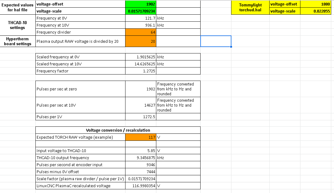

31 Oct 2020 10:29 #187881 by radek_marko
Tommylight - I need your help again...
I'm trying to get my head around voltage-offset and voltage-scale.
I've created my calculation for everyone to use if required: docs.google.com/spreadsheets/d/1dGBwp7ia...UeY/edit?usp=sharing
If I apply frequency divider as F/64 then I'm getting voltage-offset close to one from your config file, but my voltage-scale is way off.
I'm guessing your voltage divider at plasma output must be different than mine (I'm using 1:20).
Please let me know if my logic and calculations are correct.
31 Oct 2020 10:37 #187883 by phillc54
There is an online calculator here:
jscalc.io/calc/NTr5QDX6WgMThBVb
The following user(s) said Thank You: radek_marko
