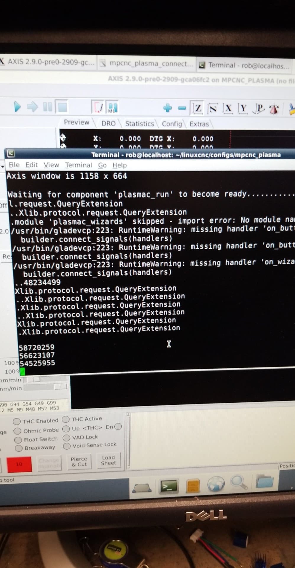

25 Oct 2020 03:44 #187160
by Tesremos
Replied by Tesremos on topic Possible bug, code runs and stalls on Torch on Signal line
okay, a picture!
this is robs machine running from term, this happens on load.
- Posts: 12163
- Thank you received: 4151
25 Oct 2020 03:52 #187161
Replied by rodw on topic Possible bug, code runs and stalls on Torch on Signal line
YOur photo clips off the important stuff. What does "no module named ..." say?
You may be missing a dependency if its compiled from source.
