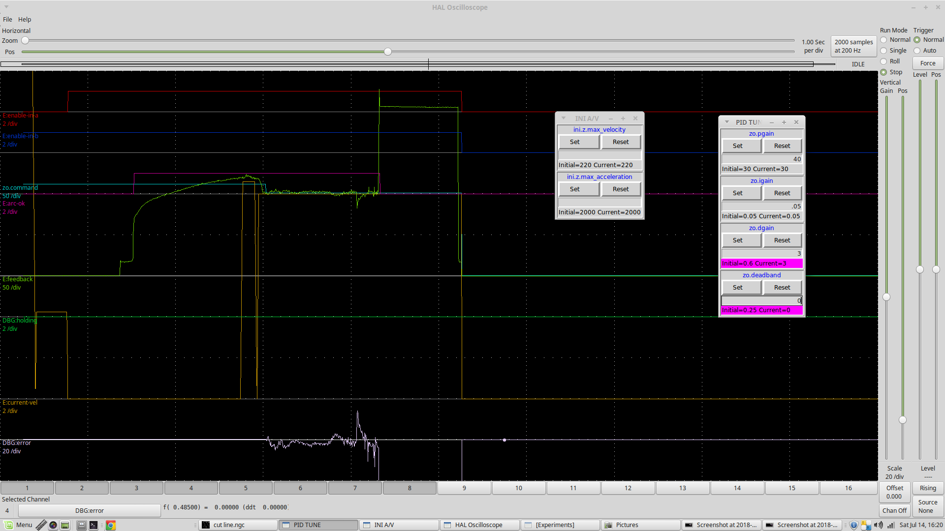

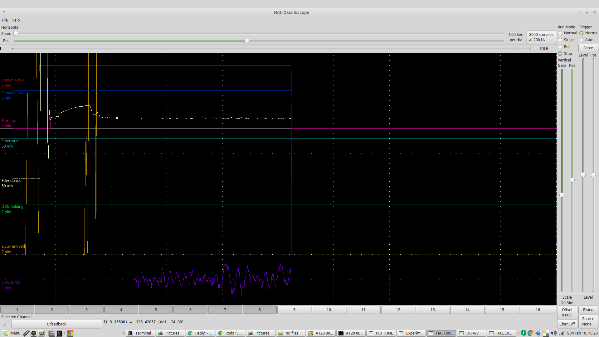

01 Nov 2020 23:24 - 01 Nov 2020 23:32 #188067
Replied by rodw on topic THCAD Configuration Problem
Tommy, I knew somebody would make me trawl through my plot collection! Look for ArcOK signals vs torch voltage. The voltage naturally peaks then falls back to cut volts without a THC.
Thermal Dynamics
About 1 second
Everlast
About 1.5 seconds
I wanted to experiment with waiting for constant velocity because I suspect that is a better indicator of when the arc should be stable than time.
Thermal Dynamics
About 1 second
Everlast
About 1.5 seconds

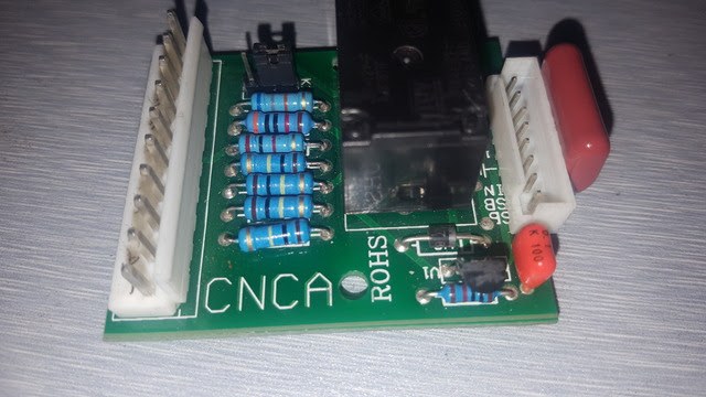

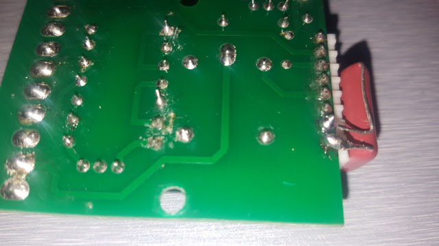

I ended up buying a cheap USB oscilloscope to investigate the noise issue and concluded that most of it was entering by the mains ground wire when the plasma was turned on. The filter made a huge difference and was a 10 minute job to fit.
The other thing you can do (as advised by Everlast) is add a capacitor to the divider board. Sorry but I don't have the capacitor spec anymore. But I don't think this will be necessary.
Rod, I did also confirm the Everlast was set to 16:1 from factory, based on the "Port Erratta" post you linked I adjusted my settings to reflect 24:1 instead which seems to work. I am still receiving some erroneous voltage readings that I attribute to noise within the enclosure, I will install the filter when I receive it and do a better job of shielding all the THC wires while I am in there.
