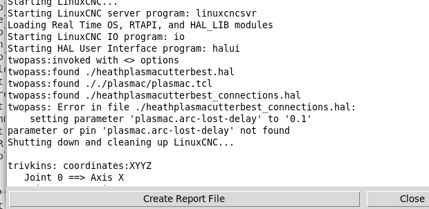

Hi thanks for the help. When I paste it on that file I get the attached error.

Replied by tommylight on topic No Arc after first cut
Might have to wait for the buildbot to update then do a dist-upgrade
