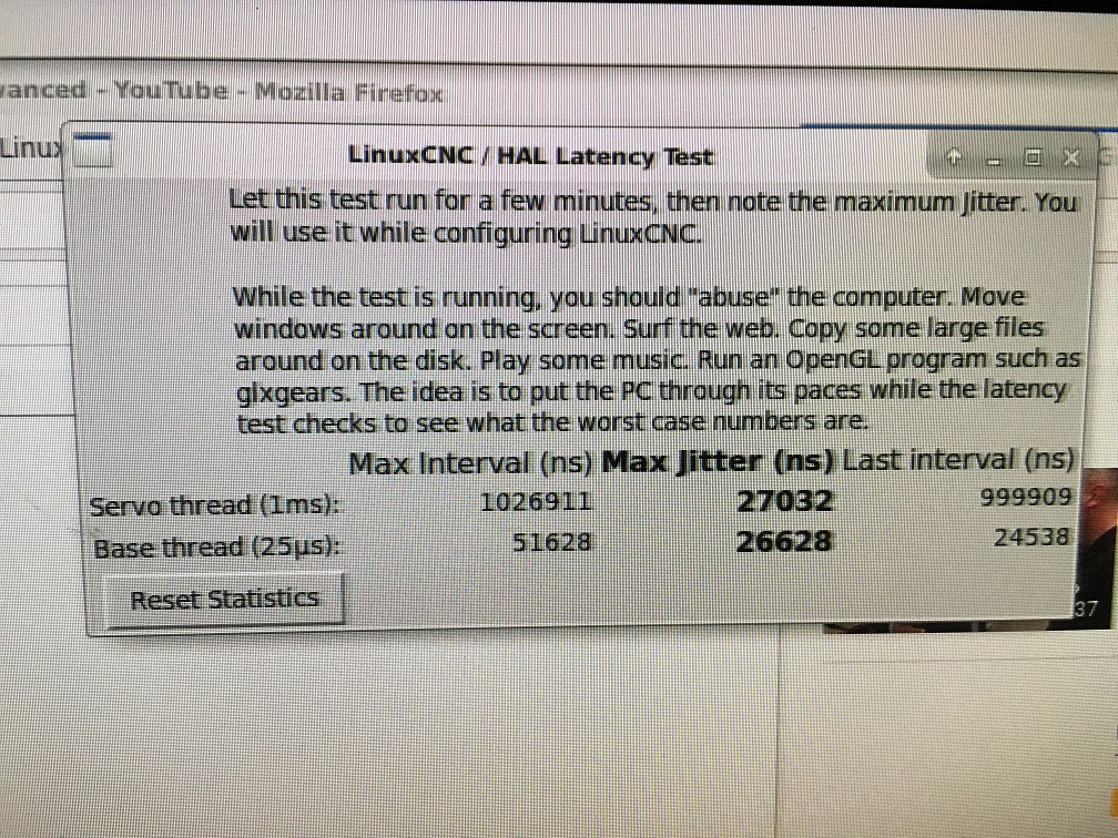

How fast is your base thread?
The base thread frequency will determine the maximum count rate of the software encoder
At a 1/128 division ratio, the maximum THCAD output frequency will be about 7 KHz
For the software encoder to count this reliably you need an absolute minimum of 14 KHz
(~70 usec) base thread but this assumes 0 jitter. Allowing for jitter, a safer base thread rate
would be about 25 KHz (40 usec)

10 Nov 2020 21:36 #188923
by radek_marko
Replied by radek_marko on topic Runaway torch THCAD-10 + PlasmaC + Hypertherm 45XP
- Posts: 21895
- Thank you received: 7465
10 Nov 2020 22:09 #188931
Replied by tommylight on topic Runaway torch THCAD-10 + PlasmaC + Hypertherm 45XP
That seems usable.
Do you get latency warnings while using LinuxCNC?
- radek_marko
- Posts: 73
- Thank you received: 18
10 Nov 2020 23:10 #188936
by radek_marko
Tommylight - no latency warnings now, I used to have latency warnings, but isolcpus fixed the issue.
