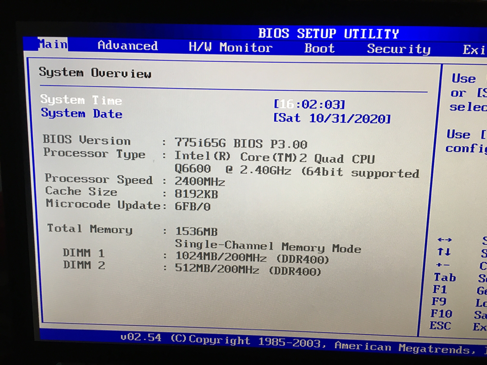

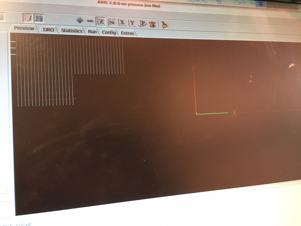

I need to ask for help again. I've updated my system recently and I have noted that on my preview screen I'm not getting correct coordinates. If I load g-code with PREVIEW tab as active, the application freezes, but when g-code loaded on any other tab I can run the machine.
PC is based on Q6600 CPU, AGP graphic card, SSD.

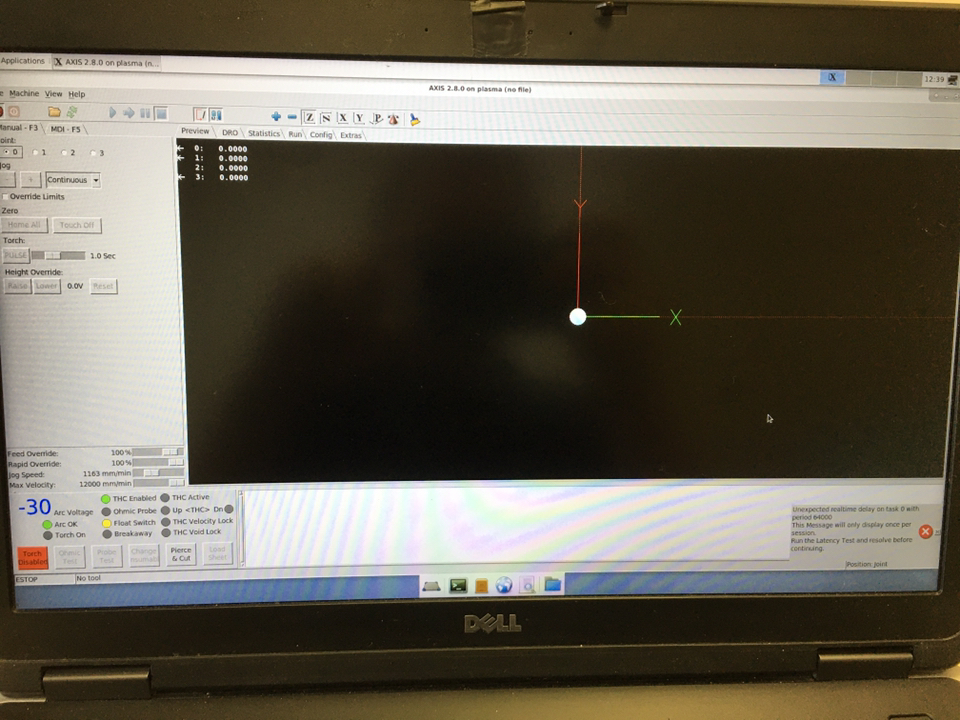

I've loaded the same LinuxCNC image on my laptop (Dell M2800, i7pro CPU) and the preview screen looks OK.

I seem to recall an earlier thread quite some time ago about some locale setting causing issues like this but I can't seem to find the thread.
EDIT: I found the one I was thinking of:
github.com/LinuxCNC/linuxcnc/issues/659
