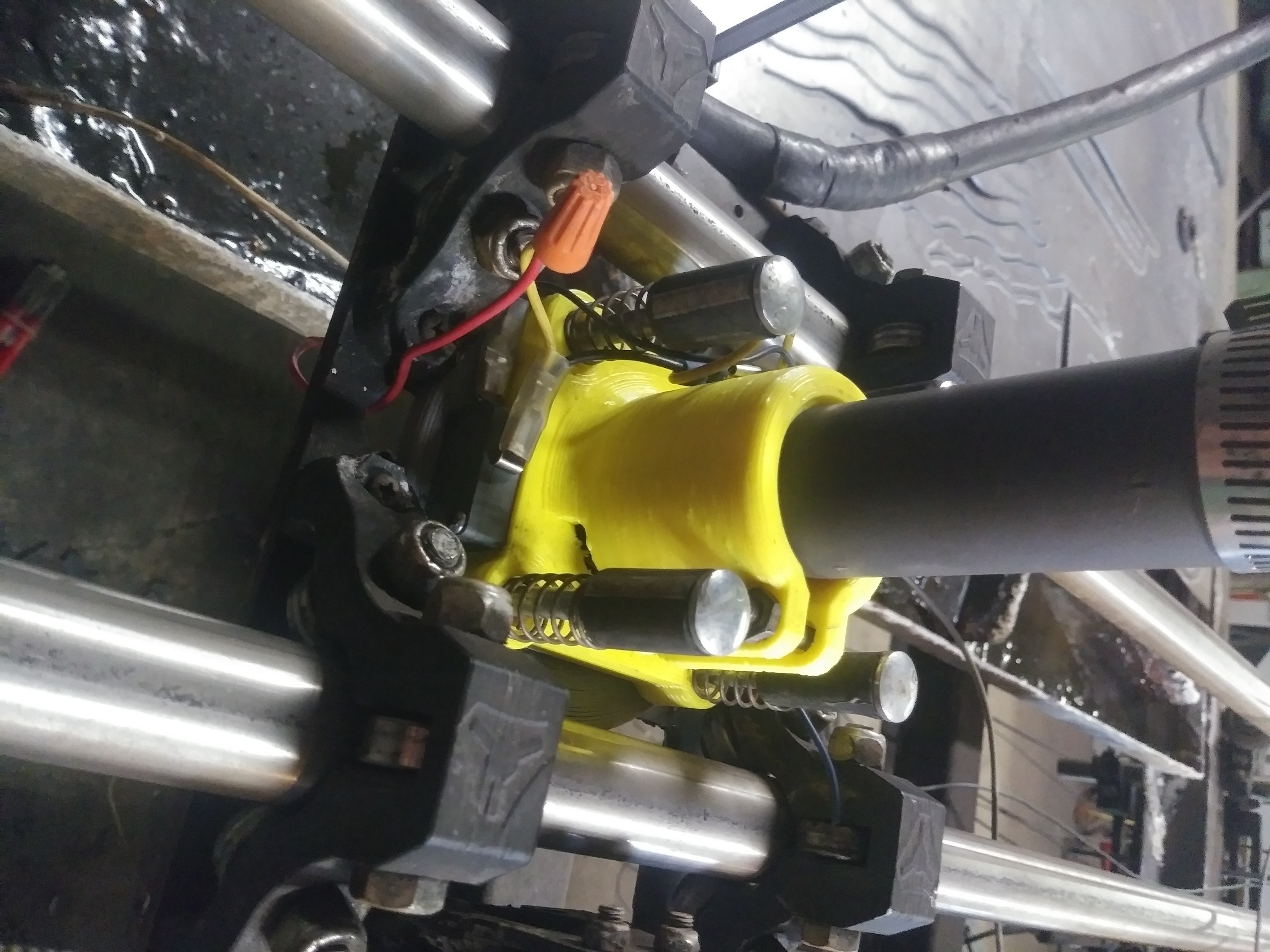

I'm in Linuxcnc 2.8 and using Gmoccapy. I have a Mesa 7i96 and thcad.
I just built a breakaway for my machine and I keep getting an error. It reads: breakaway switch activated program is paused.
It happens right after the probe and the torch fires for less than a second before the error.
The LED and Halshow don't light up. I can get them to light by manually breaking the torch.
Thanks for any help

Without seeing your breakaway design, it's hard to say. Post some pictures of what you've got going on.
Is it possible that the pressure from the torch is causing your switch to become un-tripped?
Is your Breakaway LED lit before you start cutting?
You could do a halplot, but I'm sure it will show that the breakaway switch is tripped some time after the torch fires.
Have you tried wiring the breakaway switch out the equation?
Again, not sure how helpful we can be without seeing anything.

There are two switches that are depressed by the springs and in open mode. When the torch collides to switches are no longer depressed and a 5v signal is sent to the board.
The breakaway LED is not tripped before I start.

That is from EMI interference, so will need shielded wiring and shielding around the switches.

I'll try to shield everything. Thanks Tommy.

I guess I missed the other posts. But one thing I do wonder is why you wired them normally open. Industry practice is to wire these sort of safety switches normally closed, so if a wire ever breaks, becomes disconnected, smashed, etc. the machine will fault out and prevent you from further issue....

First check the grounding, that is the main thing for proper operation of a plasma cutter, then use shielded cable and attach the shielding to ONLY the electronics side or the control box, always do grounding from a single point namely from the main power cord and go from there to other parts of the machine, use a shield for each cable and attach all of them to that single point in the box. No daisy chaining.

I wired it normally closed. It works this way. I think this helps with the EMI noise a little too.

Good, glad to hear! And it’s a wee bit safer too!I wired it normally closed. It works this way. I think this helps with the EMI noise a little too.
