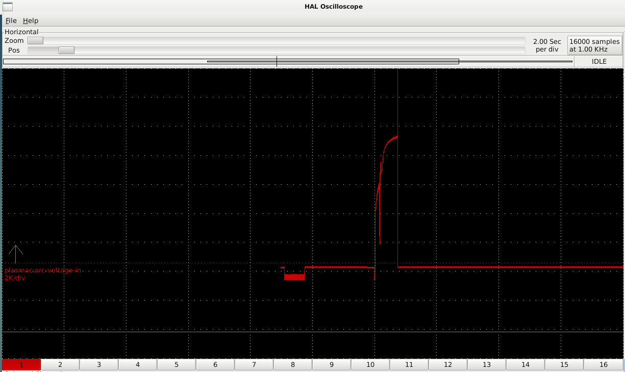

Ok I think I figured out what was throwing me off. I attached a hal scope reading and it looks like the voltage dips at the start of the pierce. Do I need to figure out how to clean up my signal or is this something the software can ignore?

With those spikes you are probably getting a arc ok and then losing it just as quickly. Are you getting a lost arc error message?
You could try the arc lost pin I posted earlier or better solution may be to use a reed relay for arc ok and change to mode 1.

Yeah I'm getting arc lost errors every time.
Reed relay it is. Thanks a million phil!

Don't forget another solution is to buy the Thermal Dynamics Automation interface so the plasma cutter is telling you it really has an ArcOK. Costs a bit more than a Reed switch. The 30:1 divider works well with a THCAD-10 but there is also a raw arc voltage output (but you need to account for the resistance on those wires (2 x 100k) as part of your THCAD scaling resistance.

Ok as Tommy called it the reed switch works great.
Simple 24v amazon reed switch, three lead wire loops around a pvc pipe, connect it into an open input on the mesa control board and run the plasmac configure to setup that input for arc ok with mode 1.
