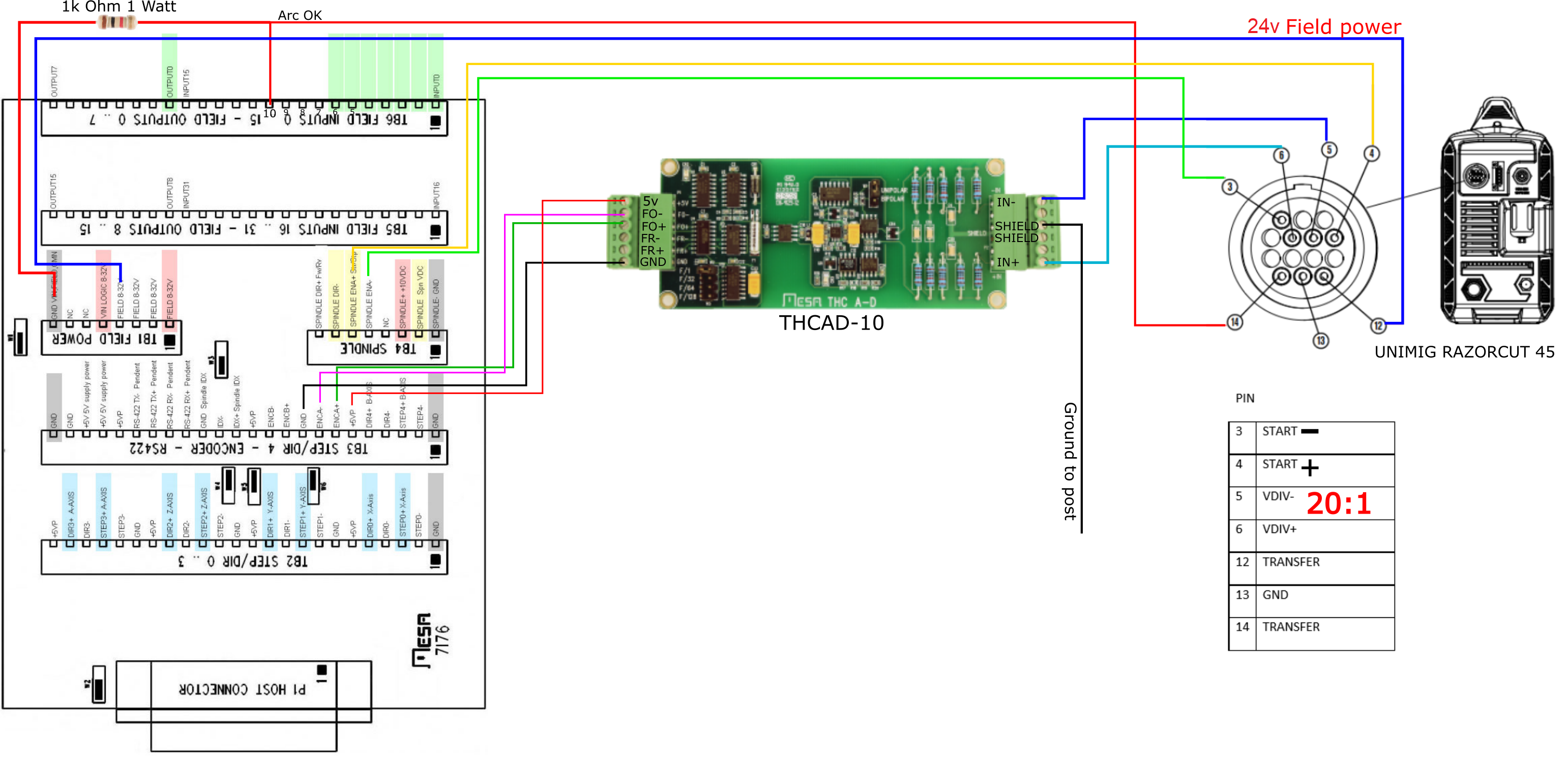

I am fairly certain no ArcOk comes on the GUI, But i may double check tomorrow its gonna be a hard one to catch.

So just confirmed the ArcOK led on the GUI does not come on when this happens, it pierces the metal and the volatgae reading is around 95-110 when doing this with no ArcOK coming back. (starting to think its an internal issue with the plasma cutter unit itself)

- phillc54
- Posts: 5711
- Thank you received: 2100
10 Dec 2020 23:11 #191617
by phillc54
Replied by phillc54 on topic Arc OK intermitent issues on torch fire
So it doesn't get the signal from the plasma machine.
It may be a faulty relay or connection in the machine itself or it may need some contact wetting.

10 Dec 2020 23:15 #191618
by luftlupus
I am thinking the machine also. would this be counted as contact wetting on the arkOK line in this diagram?
Replied by luftlupus on topic Arc OK intermitent issues on torch fire

10 Dec 2020 23:21 #191620
by phillc54
That will give you around 24mA which would "probably" be adequate.

10 Dec 2020 23:23 #191621
by luftlupus
with only around 8hours cut time i wouldn't think i would have oxidization build up on this connection. i can only think bad relay internally.That will give you around 24mA which would "probably" be adequate.
