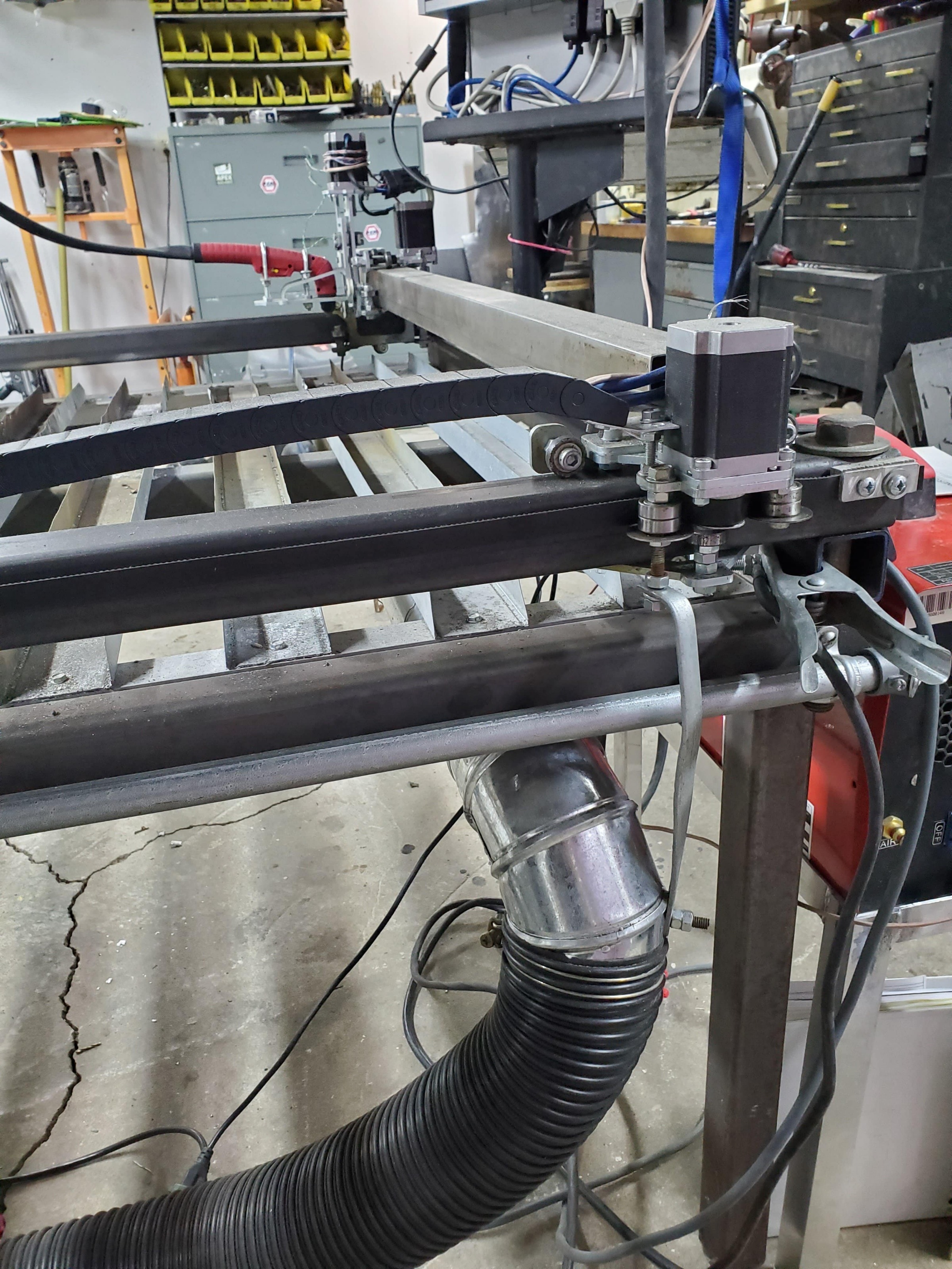

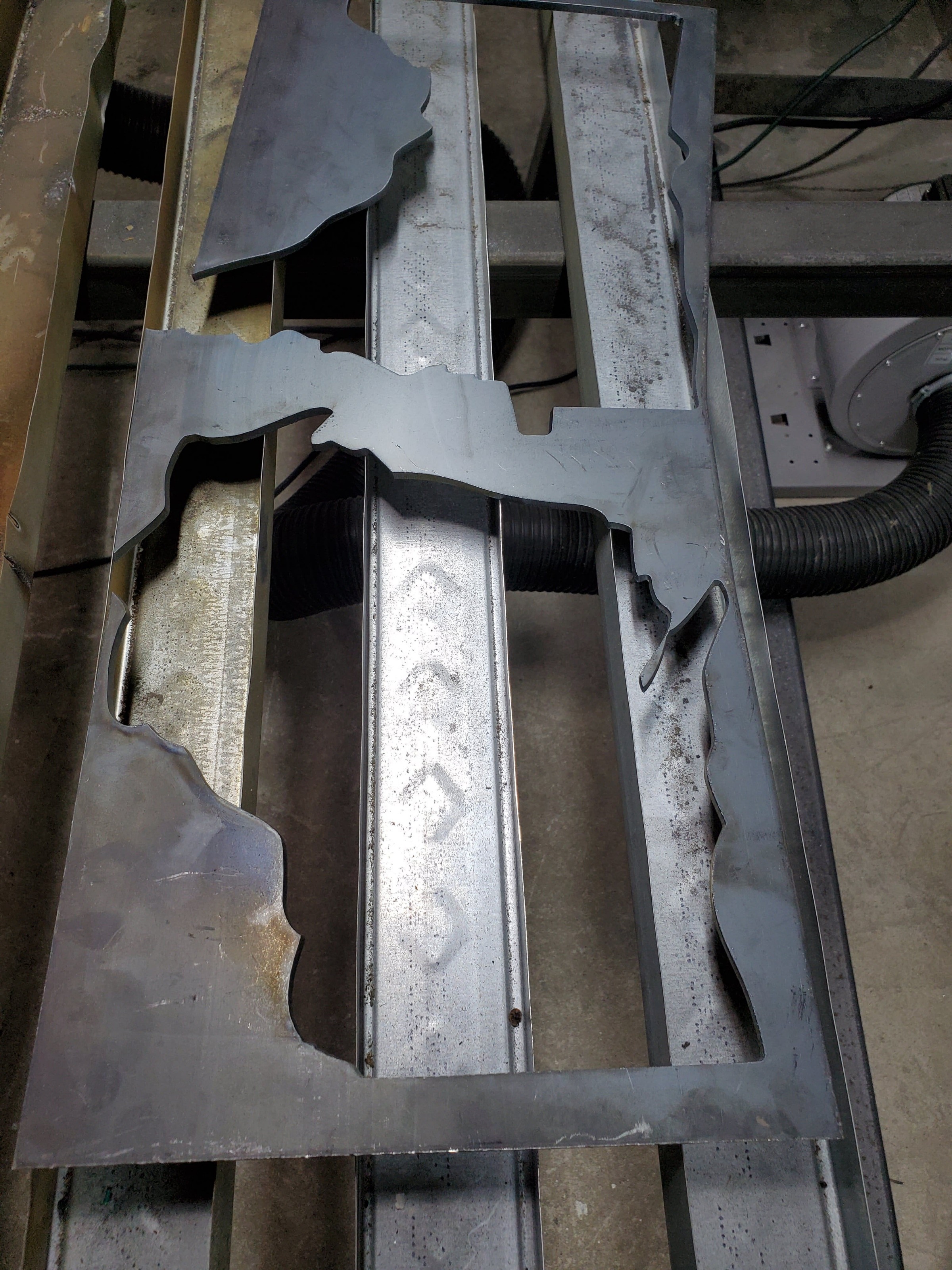

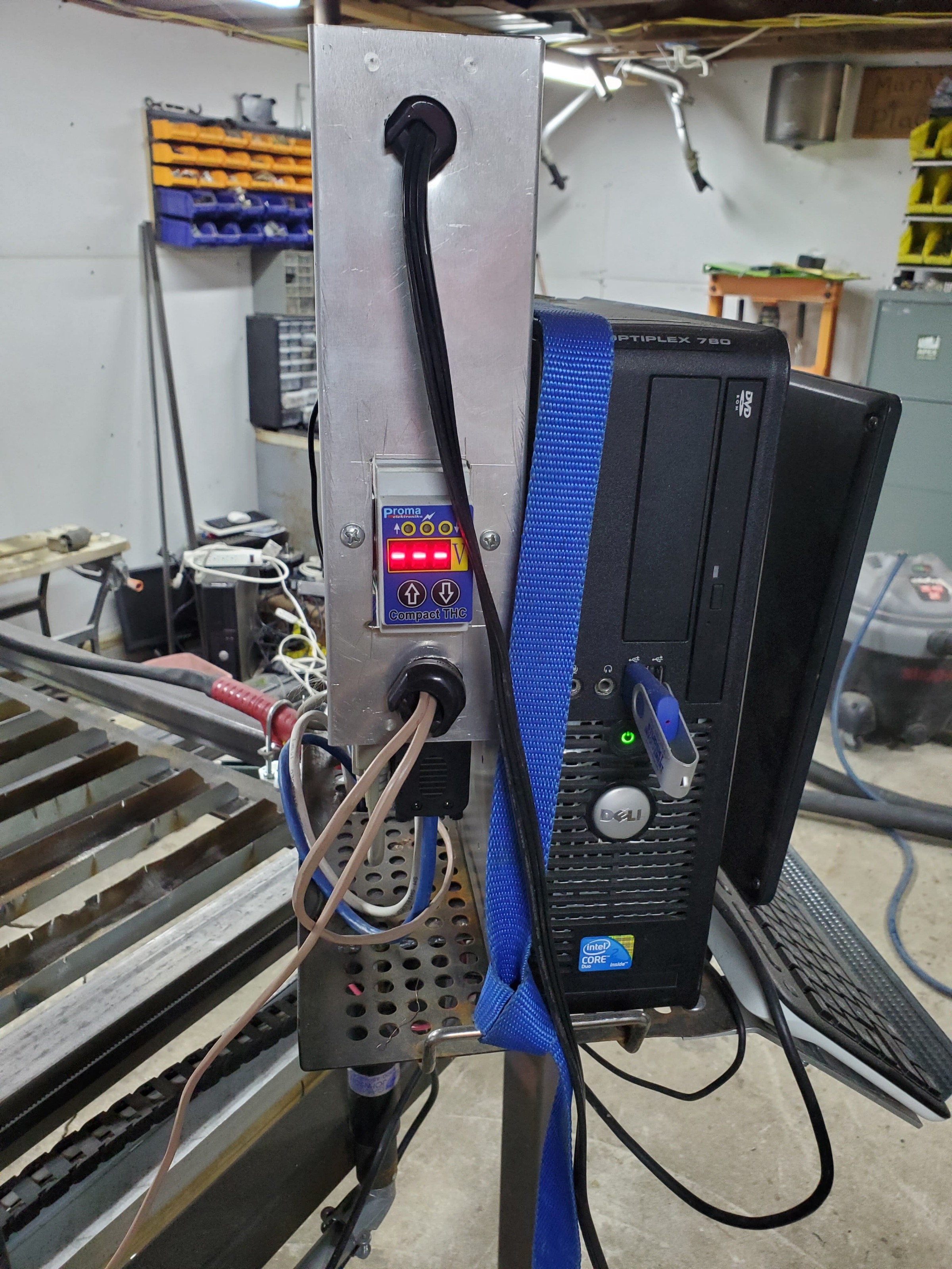

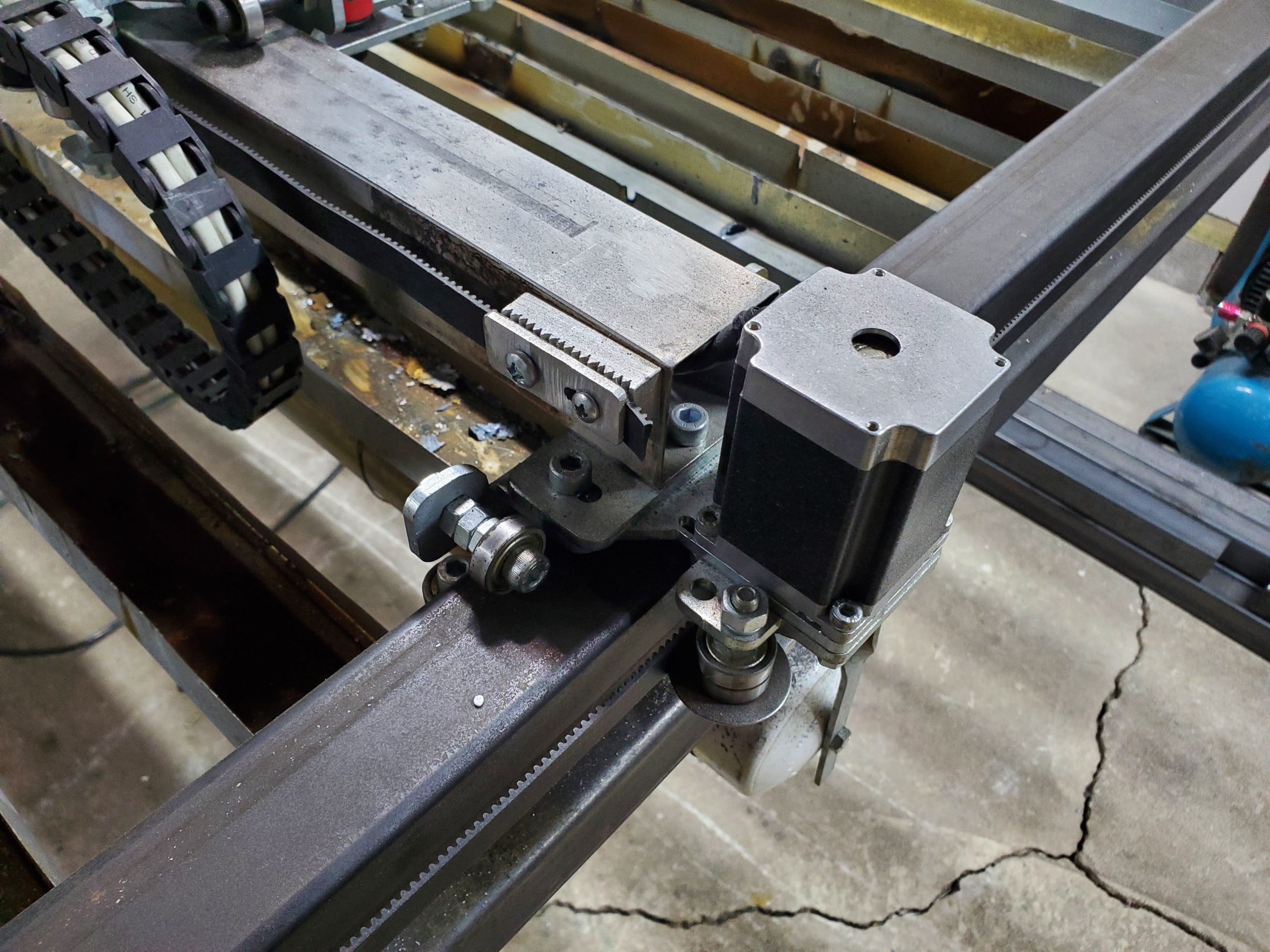

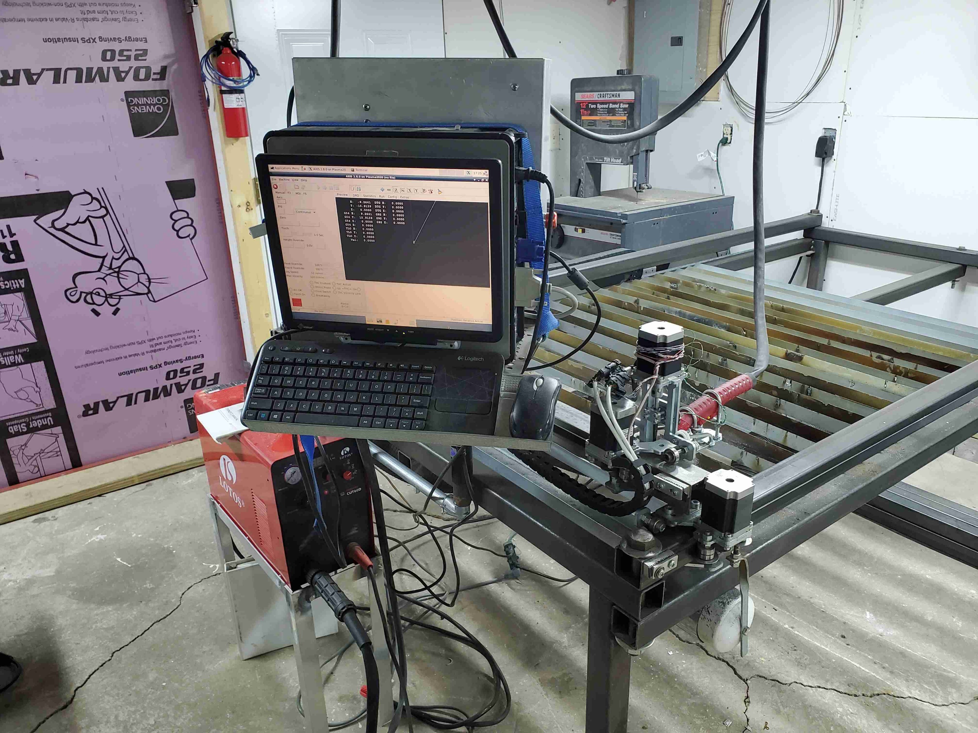

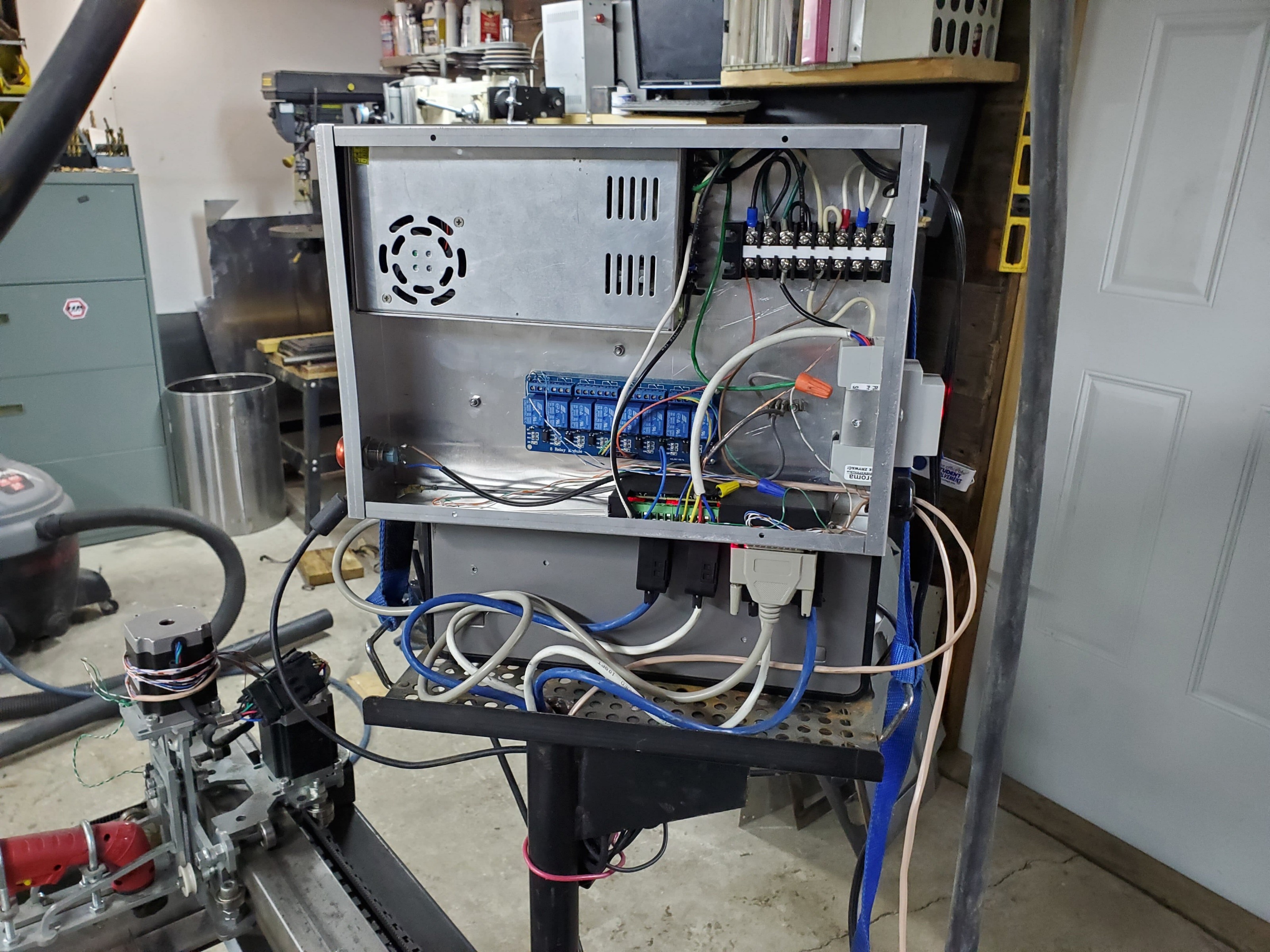

I want to thank all the programmers and developers for the work they put in building this great plasma cutting package. I spent the last year (what else ya gonna do) building and programming and tweaking my table. My daughter, son and I made a bunch of gifts for family and friends on my table before the holidays, They were impressed. I've also got big plans to use my table to cut out gantry parts for my new router table. LOVE open source. Thanks again and happy New Year.
Mark
4' x 8' gantry table made out of 2" x 2" square tube
Nema 23 steppers driving on timing belt
PlasmaC driving Gecko G540
Proma THC and Z axis float switch, other axes manually homed.
Mark

What ? Still no pictures ?

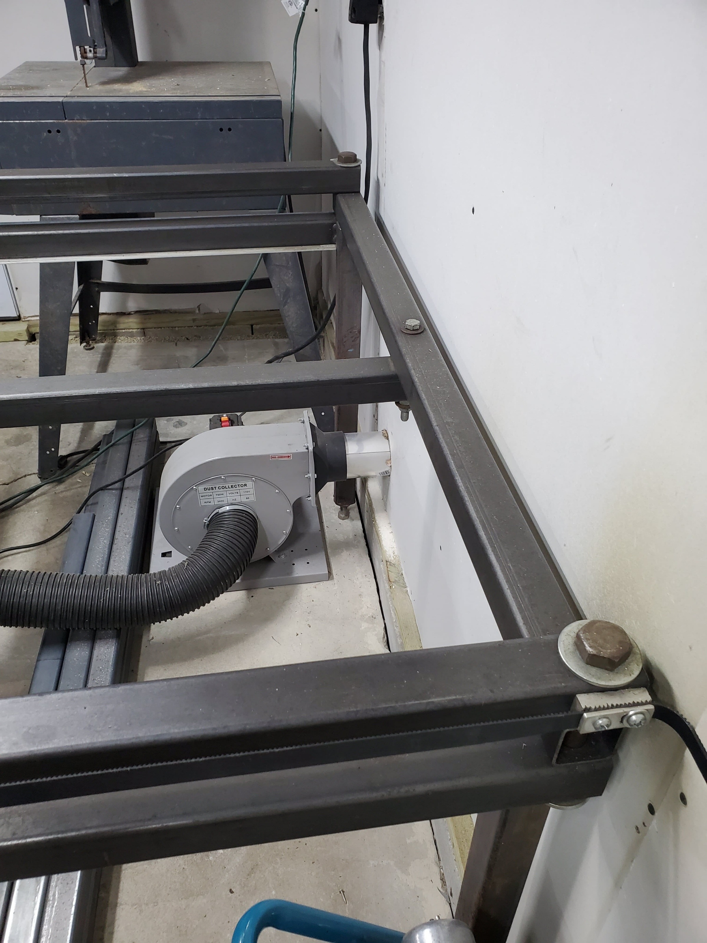

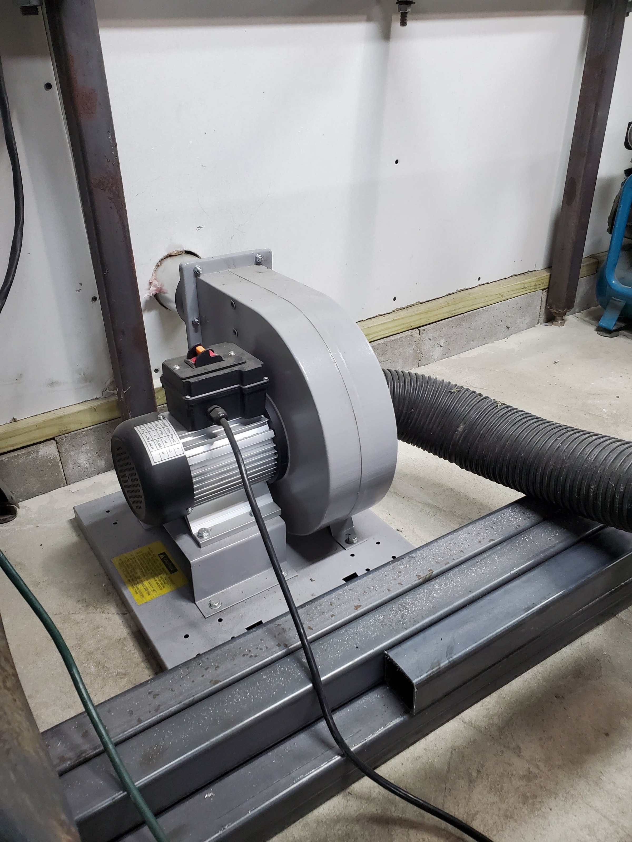

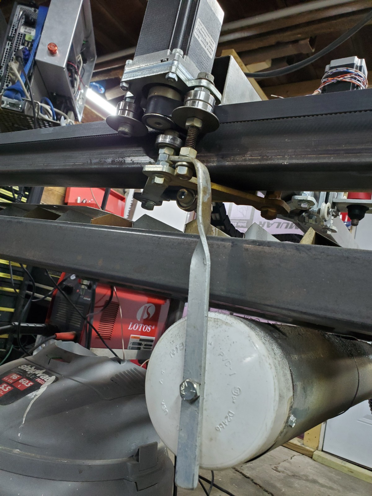

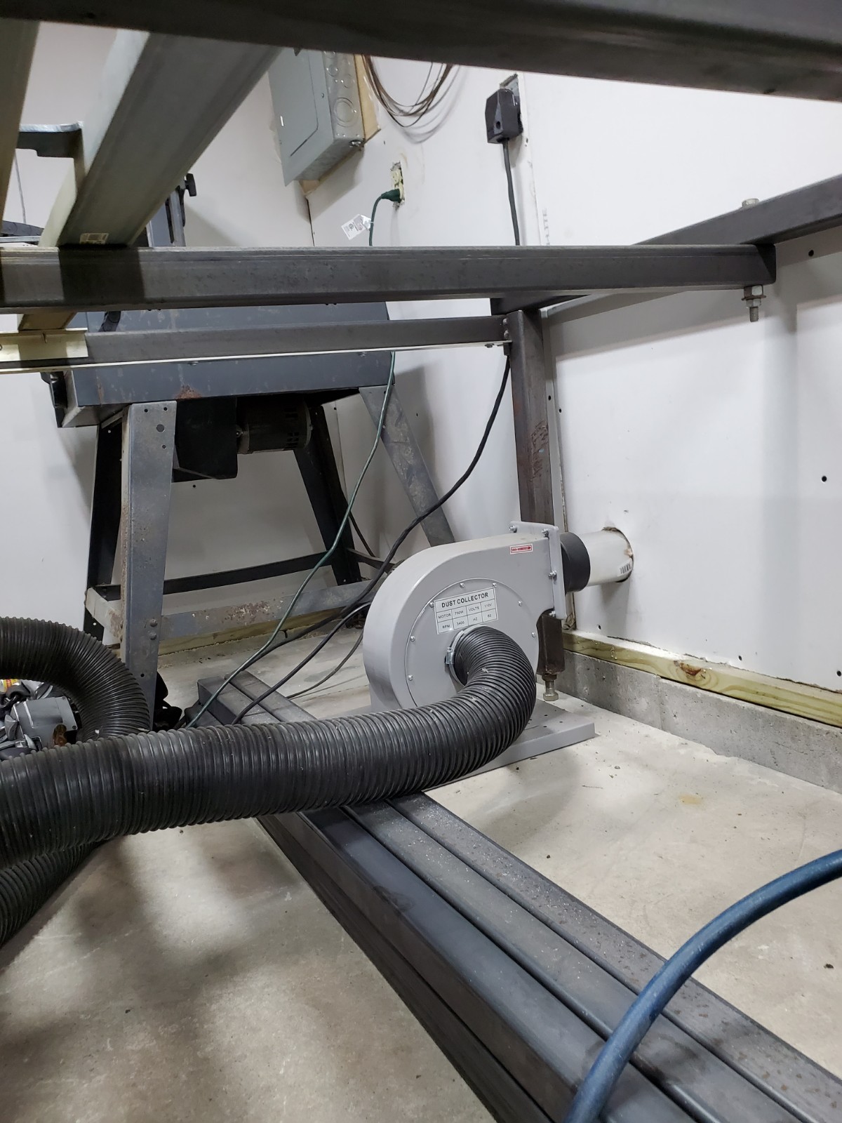

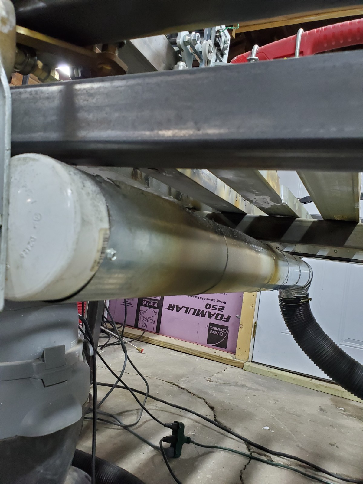

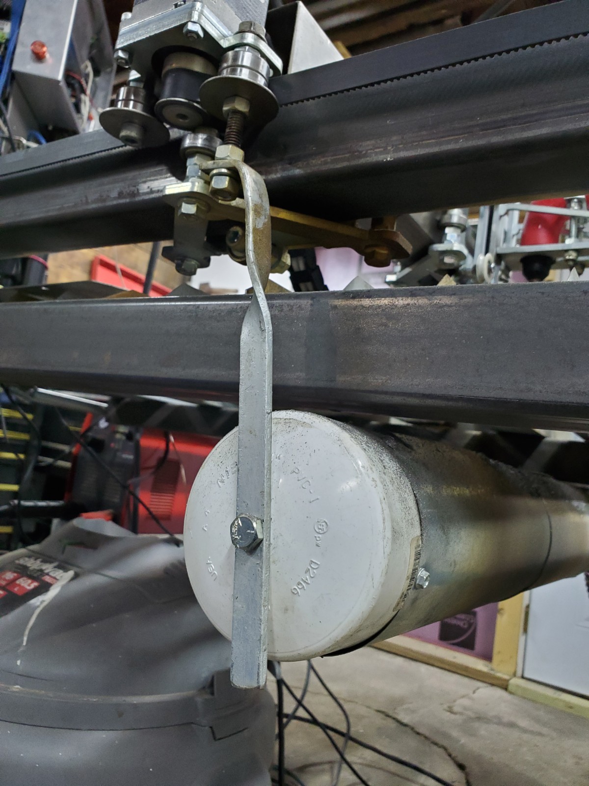

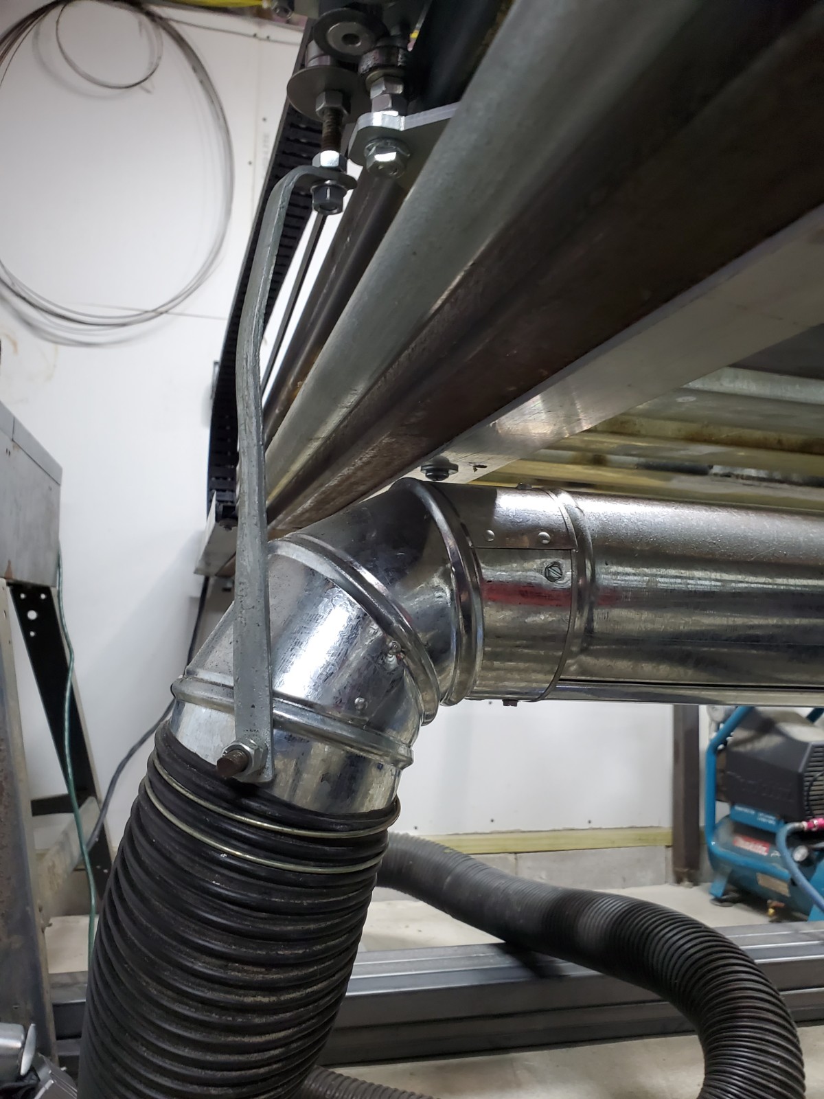

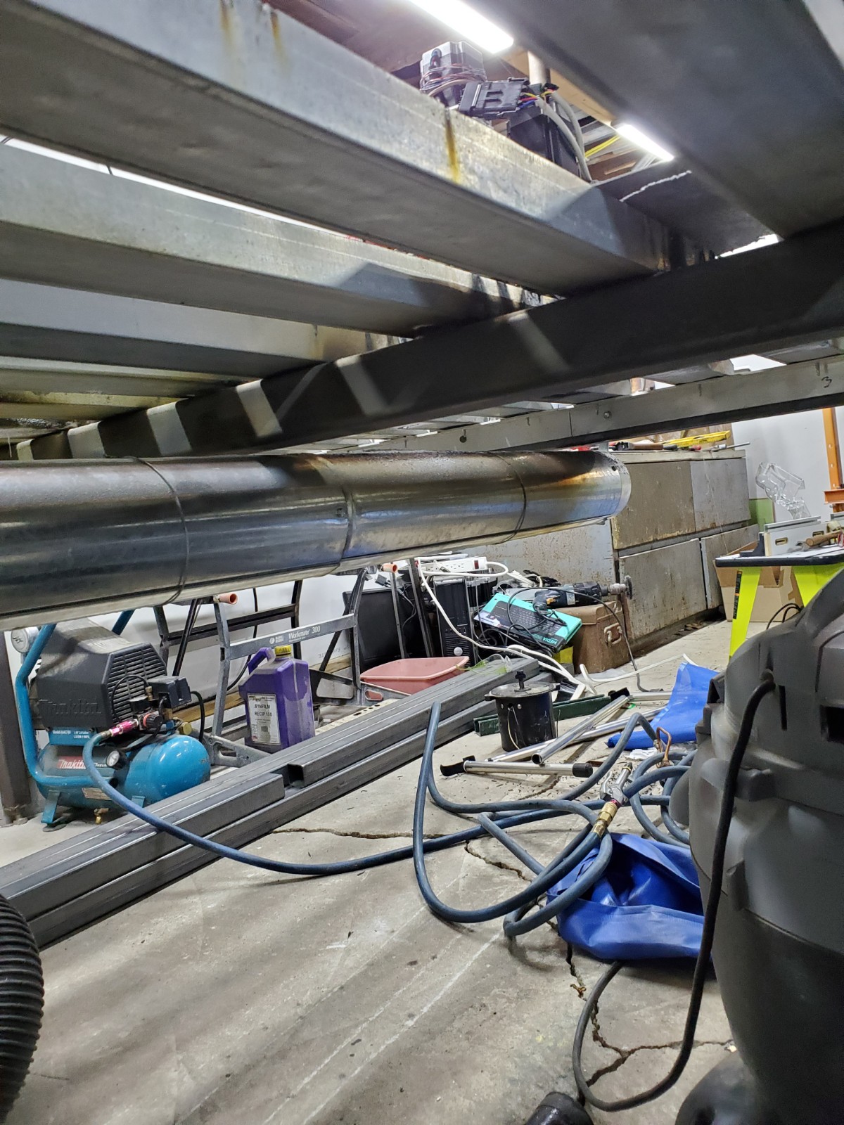

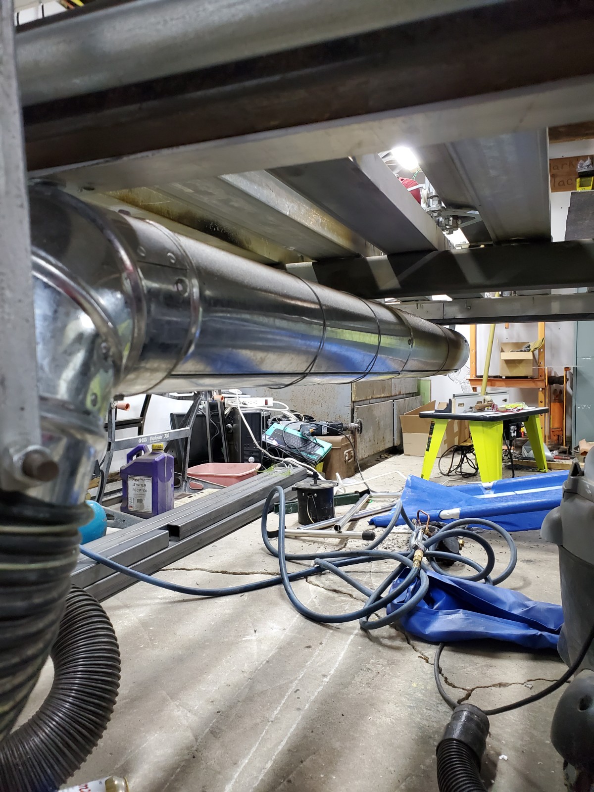

A few tips on saving $.
My bed is 1.5" steel wall studs - very cheap and easy to replace. Can get them in a variety of widths.
Harbor Freight dust collector hooked up as exhaust to 4" hose and 4" ducting that moves with the gantry.
2" square tube is pretty cheap and sturdy. In Wisconsin 20' stick is $40. Perfect for gantry.
- Posts: 12054
- Thank you received: 4114
13 Jan 2021 03:04 #195166
Replied by rodw on topic Thank you so much PlasmaC people
It would be awesome to see more pics of your downdraft below the table. I often thought of doing something like that.
