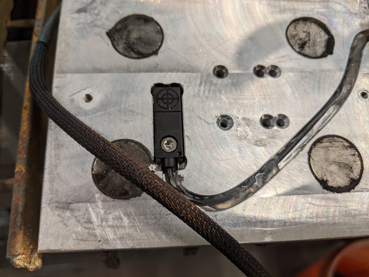

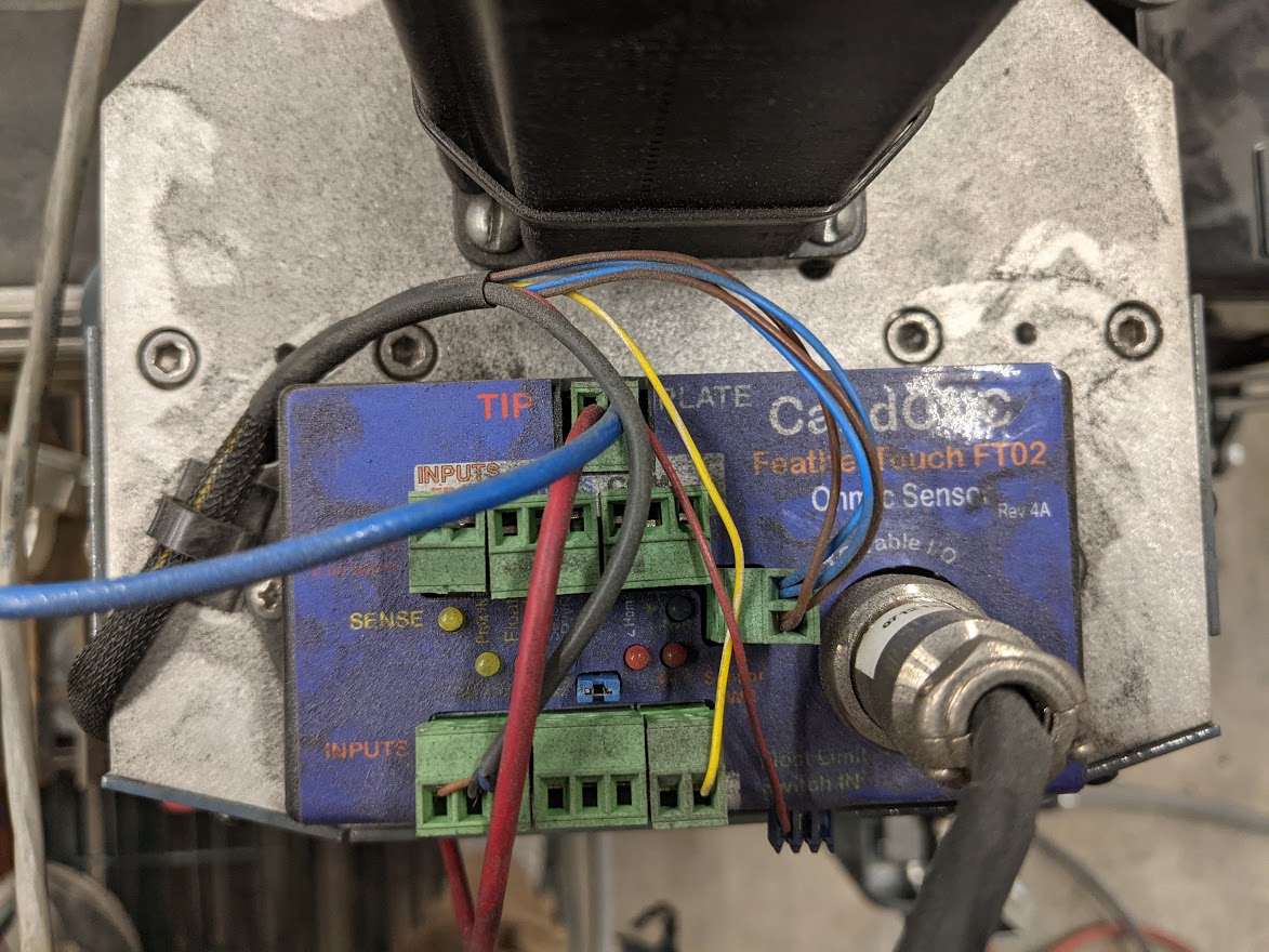

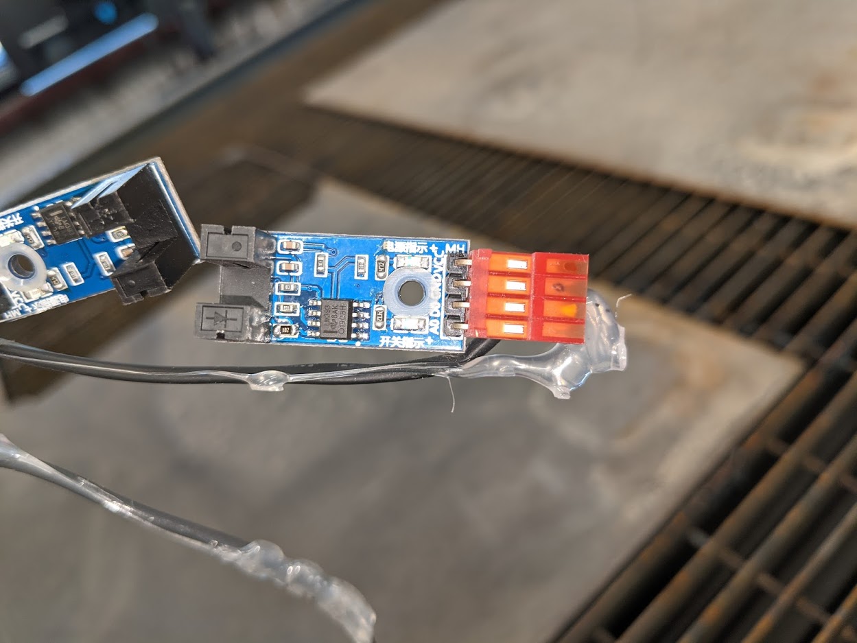

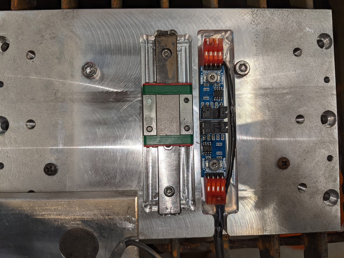

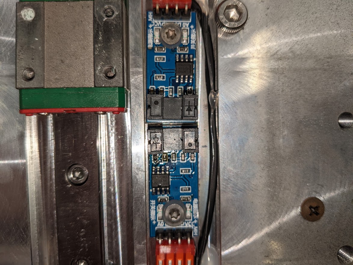

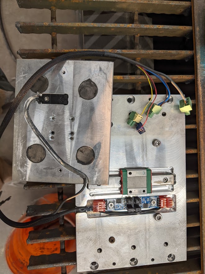

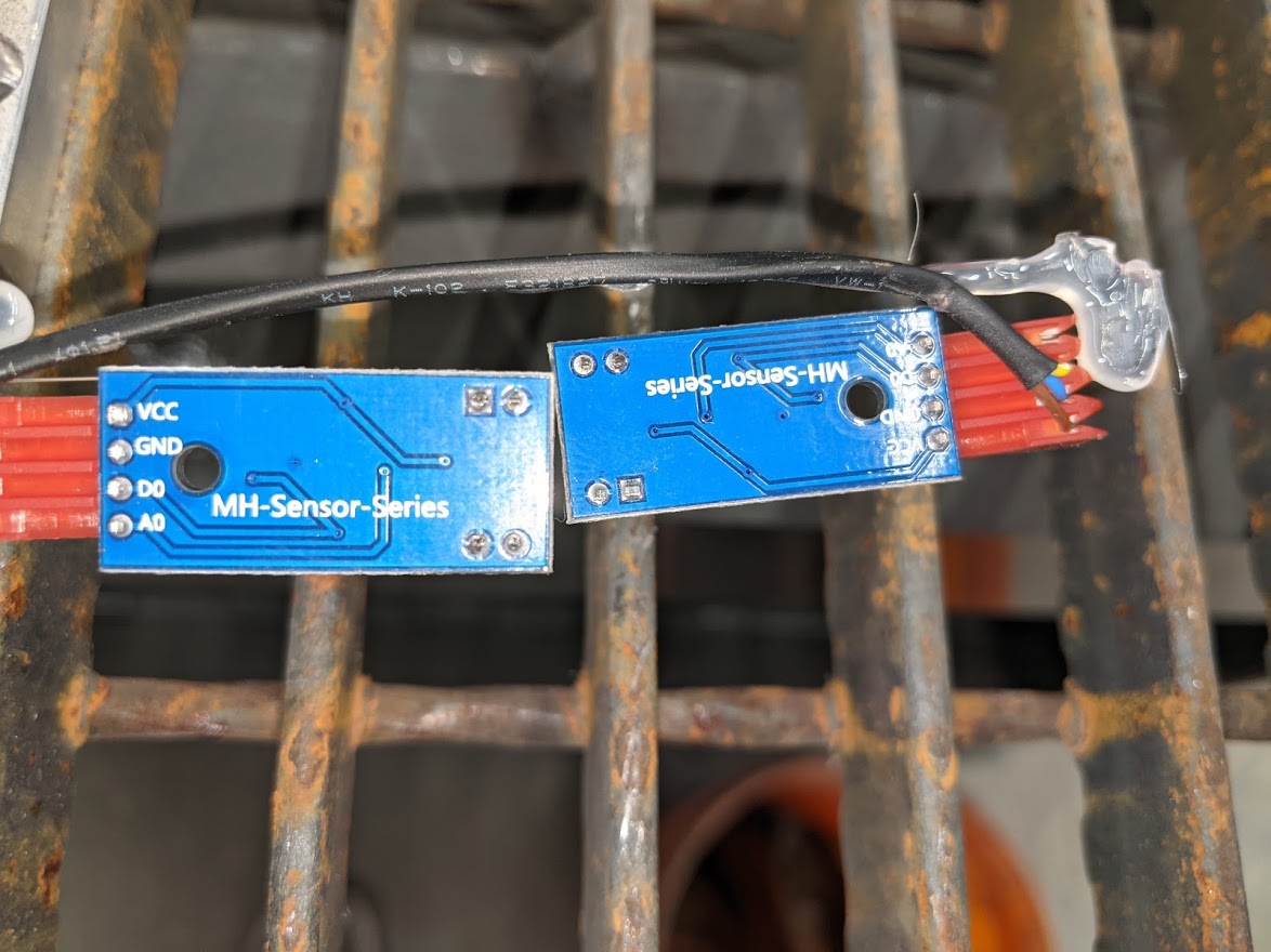

12 Jan 2021 14:36 #195057
by txtrone
Replied by txtrone on topic Z axis - Can I use this with PlasmaC and Mesa 7i76e?
See the photos attached, I don't know which sensor is considered 'optical' .... it looks like two proximity sensors for the Z home and Z float, then (maybe optical) is for the breakaway?? Anyhow, just for now ... could this be wired in directly using a 12vdc psu for those sensors AND still make use of THCAD?
I have many extra wires running from the cabinet up to the Z axis on the gantry... if that helps out.
- OR -
Would I best off to find some 24V proximity sensors for this application and rebuild?
- OR -
- Posts: 19888
- Thank you received: 4647
12 Jan 2021 14:46 #195058
Replied by andypugh on topic Z axis - Can I use this with PlasmaC and Mesa 7i76e?
There are two optical sensors on the PCBs and what is probably a proximity sensor on the metal plate.
See if you can find a part number on the prox. It is probably good to 32V.
Similarly with the optos on the boards. See what the little chip is, and what supply tolerance it has. And, also the opto sensors. They might be OK with 24V.
The sensor boards look very generic. www.ebay.co.uk/itm/322198737844
Those use an LM393 which is OK to 36V:
www.ti.com/lit/ds/symlink/lm393-n.pdf?ts...Fwww.google.com%252F
I would be tempted to buy a few of the eBay ones to test at 24V. They might need some resistors changing for the higher voltage.

12 Jan 2021 15:22 #195065
The prox looks like a chape clone of uk.rs-online.com/web/p/proximity-sensors/3395402/
And those are happy to 30V
- Posts: 19888
12 Jan 2021 15:25 #195066
That's a completely different style of sensor board.
LM393 is just the comparator chip on the board. The data sheet that I linked earlier shows that those are happy to 36V.
The little PCBs that they assemble in China are designed for 5V operation, but that is just set by the size of the current limiting resistors that they use. The major components will be fine at 24V.
In fact all the components _might_ be OK at 24V, but the LEDs will glow a bit brightly and have shorter lives.
I believe this is the optical sensor model... which is 5vdc.
www.mysensors.org/build/light-lm393

12 Jan 2021 15:29 #195068
Looking more carefully, I would hazard a guess that the sensor boards are 5V eBay parts with a resistor or two swapped by hand. The end resistor adjacent to the Opto emitter looks to have been hand-soldered.
