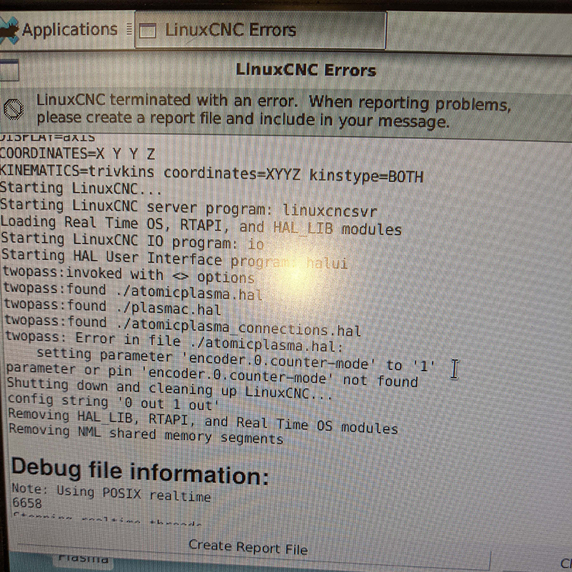

Hi everyone,
I built a CNC plasma table a few years ago and it has been working well overall. I finally decided to get the THC up and running. I have been using it without. I have an Everlast 50 with the CNC port that is a few years old. I purchased a Mesa THCAD10 board and believe I have it wired correctly to the Everlast. I am getting a changing voltage to the THCAD10 while cutting. I should add I am using a Gecko G540 and have added a second parallel port. Also using the PLASMAC GUI.
I cannot for the life of me figure out how to get the HAL and INI files setup. I have read every manual and forum post I could find for a few weeks now and I am about ready to just live with the plasma table the way it is without THC.
I have attached the HAL and INI files along with a pic of an error I am getting. If I comment out the "setp encoder.0.counter−mode 1 and
setp encoder.0.position−scale -1" I can get Linuxcnc to load but the THC doesnt work. Shows 0 volts.
Thank you for any help.

1. The THCAD output frequency will be too high to read with the software encoder
unless you use the /64 or better /128 division setting on the THCAD
2. You have a strange character (wrong dash) in your setp command:
setp encoder.0.counter−mode 1 (Has a UTF-8 minus sign between counter and mode)
should be
setp encoder.0.counter-mode 1 (Has a standard ASCII dash between counter and mode)
This can happen if you use something other than a text editor
to edit the hal/ini files
should be
Last edit: 10 Apr 2021 16:47 by PCW.

EDIT: Finally home, realized you are working with a paraport.
In addition to what PCW said, it looks like you commented out the second half of your encoder assignment. Remove the # from this line:
#net plasmac:arc-voltage-in => plasmac.arc-voltage-in
Or you can do it all on one line:
net plasmac:arc-voltage-in encoder.0.velocity => plasmac.arc.voltage-in
Last edit: 10 Apr 2021 19:22 by snowgoer540.

Idk. but never had a problem with using it for any of my g-code. But I just opened my HAL files in notepad++ with ANSI encoding on. I see what you are saying about those two lines. I have corrected them and will report back. One of the things I am not sure about....Am I correctly telling Linuxcnc to look for the arc.voltage.in at the parallel port 15?
