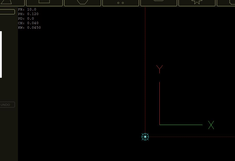

18 Apr 2021 21:01 #206338 by snowgoer540
Replied by snowgoer540 on topic Conversational Bug
AgentWD40, v1.0.20 fixed the conversational bug you reported. Thank you for the report!
Additionally, I added the materials overlay to the conversational preview window. Looking at the parameters tab for material information was one of the only reasons I could think of to leave the conversational tab and come back.
It will now show if you have "View Material" checked on the Parameters tab, similar to how it does on the gcode preview on the Main tab. For the conversational only, it will also show the Kerf Width for the currently selected material. I figured that value may be of some help to a user trying to piece together a program.
I also updated the docs to add some details, including a warning that leaving the conversational tab will cause any unsaved/unsent work to be discarded.
Here's a screenshot of the material overlay in the conversational tab:
