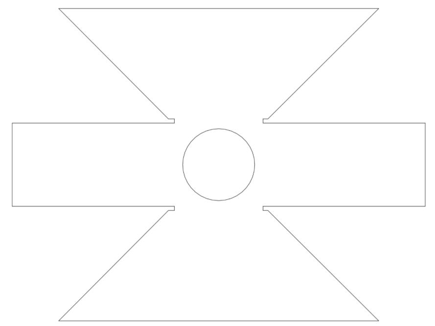

I'm sure it wasn't. You can get quite reasonable performance out of steppers but it does come at a cost for quality motors and drivers.
I can get 35 m/min rapids and 5 m/s/s acceleration out f steppers. The acceleration makes a huge difference to cut quality. I can even cut pointy corners now. In fact, I cut this yesterday and got perfect corners
Suction end for a welding fume extractor which worked a treat cutting wire reinforced rubber hose with a chop saw today!

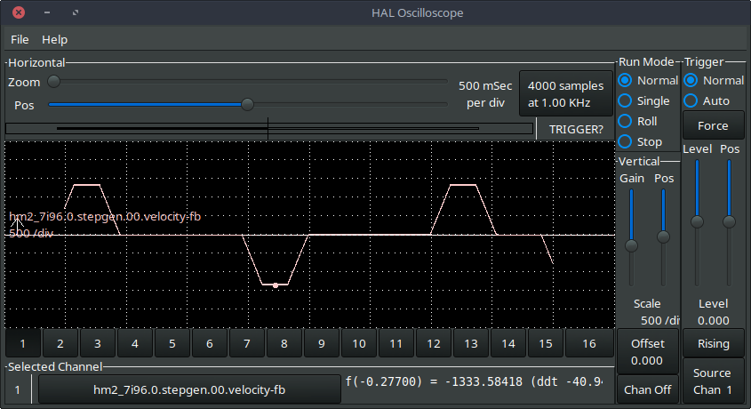

Or you can get a baby table with a Gecko G540 and Chinese motors and run 80 m/min @ 8 m/s2 ;)
Warning: Spoiler!
Full Disclosure: That is only the X axis, I haven't played around with the tandem Y yet.

21 Apr 2021 10:30 #206623 by rodw
Yeh, I think the Y is the leveller. I could get >60m/min and 8/m/s/s out of the X with a 2 amp Nema 24 motor but marked it back to agree with the Y.
But the real question is can you sustain that performance for say 30-40 minutes of hard cutting? My guess is you don't know if you can or not on a small table cos you run out of material to cut well before then!
What I found is one side of the Y (NEMA34) would loose steps when it got hot which was not a pretty sight! When I got the plasma cutter overheating and faulting before my drivers or motors faulted. i was pretty happy!
21 Apr 2021 10:52 #206626 by phillc54
Yes, I can't imagine the Y being as quick. I did get 100 m/min in X but I can't remember if it was 5 m/2s or 6 m/s2. It is academic anyhow, I only cut with the table at 30 m/min @ 3 m/s2 because there is a bit of slop in torch float.
Haha, yeah nothing I have cut would come anywhere near that.
My motors hever never got much past warm, but I do only run it conservatively.
