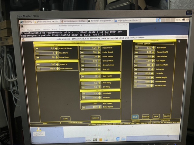

Hello ,
no reaction to signals from THC during cutting. I checked the plasmac.move-up and plasmac.move-down pins in the Halshow settings, when THC is up then plasma.move.up is true, when THC is down to plasma.move.down is true but the torch does not respond.
I have thc in qtplasmac turned on, I changed the thc speed, changed the VAD parameters and no reaction. The torch does not go up and down, the THC Proma 150 of the ferry shows up and in GUI Qtplasma is also up but there is no reaction. I use google translator, sorry for english.

I see the same here on a sim. I will have a look at it later today or tomorrow.
EDIT: Oops, I forgot to have the torch enabled. It does work in sim.
What value do you have for THC Speed%

Replied by phillc54 on topic qtplasmac does not respond to THC PROMA 150
I see that I have the THC velocity for mode 2 running 100 times faster than it should be but I am not sure whether that would cause your issue. I cannot see anything else wrong. I have pushed a fix so you can pull the change or wait for Buildbot to finish depending on your installation type.
