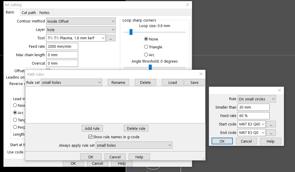

Ok I am a bit confused .
In SheetCam there are two pp's . one Revision: F - May 15 2020 and one LinuxCNC PlasmaC
Which would be the correct one as I have seen that the first one is no longer in the list forum.linuxcnc.org/plasmac/38438-plasmac-post-processors#158267
From the manual linuxcnc.org/docs/devel/html/plasma/qtpl...c.html#_hole_cutting it shows
I have set up a test hole and slot from SheetCam with this result :-
Should the PP alter the code to make the feed-rate lower ie. M67 E3 Q60 (reduce feed rate to 60%)
or is that done manually ?
What is the correct way ?

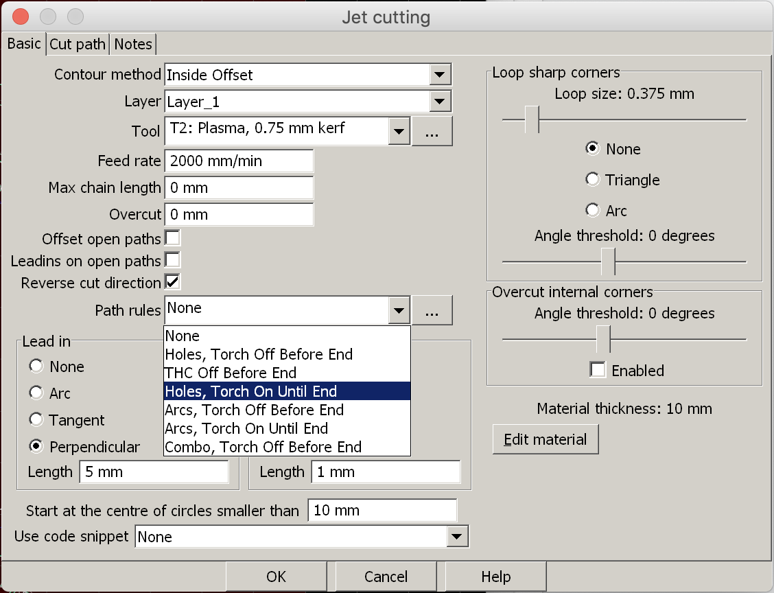

You need to apply the Path Rule for holes when you are creating the Operation.

04 May 2021 05:53 #207816
by Clive S
Thanks, Is that in SheetCam ?

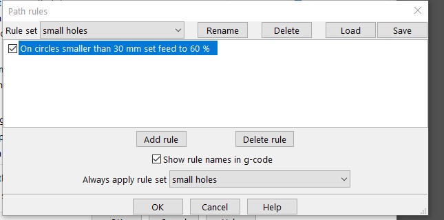

I am still stumped (or thick) on that screen in SheetCam I don't have any rules in the dropdown box it says none.
I don't remember any rules being supplied I have only seen the post PlasmaC.spost I have tried this
Am I putting the correct code M67 E3 Q60 in the correct place. . I still don't see any change in the feed rate.
Not sure where I am going wrong
Edit: Its late here but I think I have solved it. The gcode seem to look good if I use the SheetCam pp and not the PlasmC one

Yes. There were some rules supplied with the PP.

I don't think its possible to share cutting rules in a post processor. You need to create them yourself. They may be saved with the toolset though.

They were in a separate file...

Ok if I have it correct above by putting M67 E3 Q60 in start code and M67 E3 Q0 in end code (SheetCam)
Then is the THC locked as from the manual (If Velocity Reduction is invoked in the middle of the cut, the THC will be locked.)
If not how is that achieved ?
Also does all of the above apply to PlasmaC as well or was that done differently ?

Yes, so long as the velocity is below the threshold set by VAD Threshold in the parameters tab.Ok if I have it correct above by putting M67 E3 Q60 in start code and M67 E3 Q0 in end code (SheetCam)
Yes, they are identical.Also does all of the above apply to PlasmaC as well or was that done differently ?

I have seen similar behaviour also. I have rules in and when selected to slow the feedrate with radius smaller than x, it doesnt do it.
I cannot get the rules to work. It is not in the gcode either so the post is not using it.
