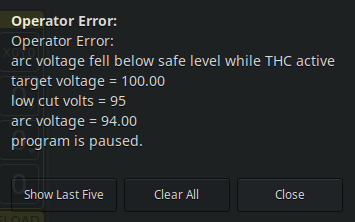

Tom, I managed to cobble something together and have pushed it.
There are three additional pins:this is an input, you can set this so that if the arc voltage is lower than this while THC is active then the machine will pause and give an error message similar to this:
The next two you may not need:This is an output that shows the target arc voltage for THC.
This is an input that defaults to 6. You can change the number of samples needed to set the target voltage for THC.
plasmac.low_cut_voltsThe next two you may not need:
plasmac.target_voltsplasmac.target_samplesAttachments:

29 May 2021 08:11 #210603
by phillc54
If the target was 130 and the arc voltage was heading down to around 80 then it should have raised the z axis, not lowered it.
Replied by phillc54 on topic Is this QTPlasmac Expected behaviour - Cycle Start and Jog disabled.
Tommy, I seem to remember you always set your voltage manually. Have you ever tried auto sampling voltage? What if your set point of 130 volts is wrong so Plasmac starts off on the wrong foot?
Try using halscope with the THC disabled to see what the voltage settles to naturally to set your desired voltage.
