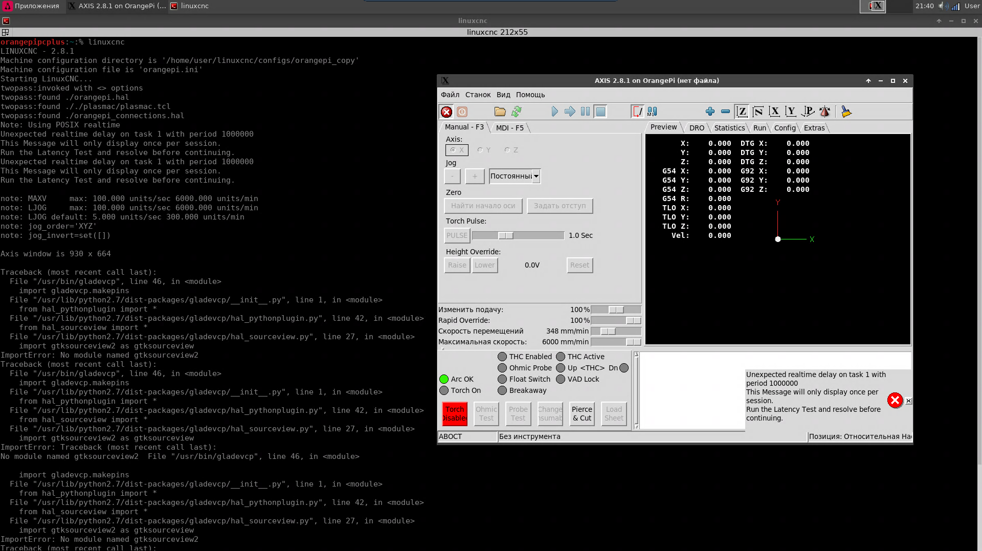

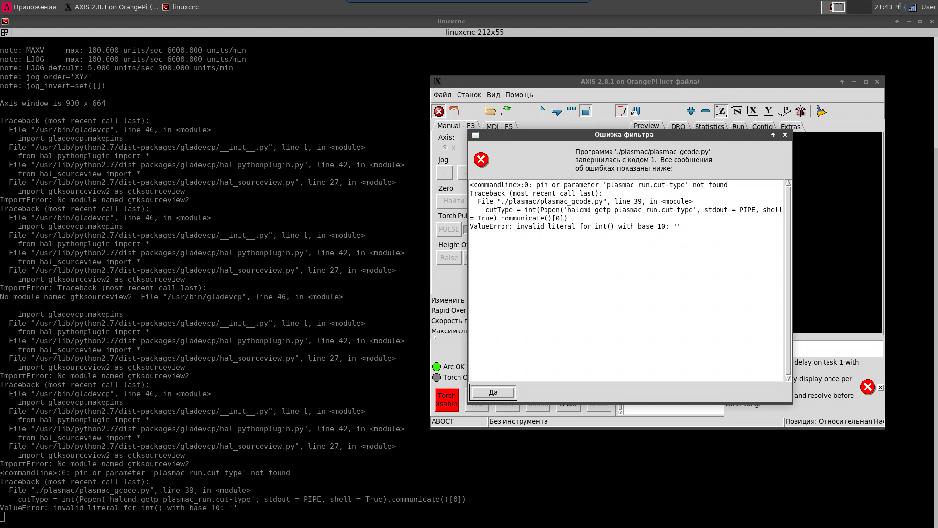

Errors after PlasmaC start and load file *.ngc

I will add the INI and HAL files

Thank you! Took the package at this address: packages.debian.org/stretch/python-gtksourceview2
