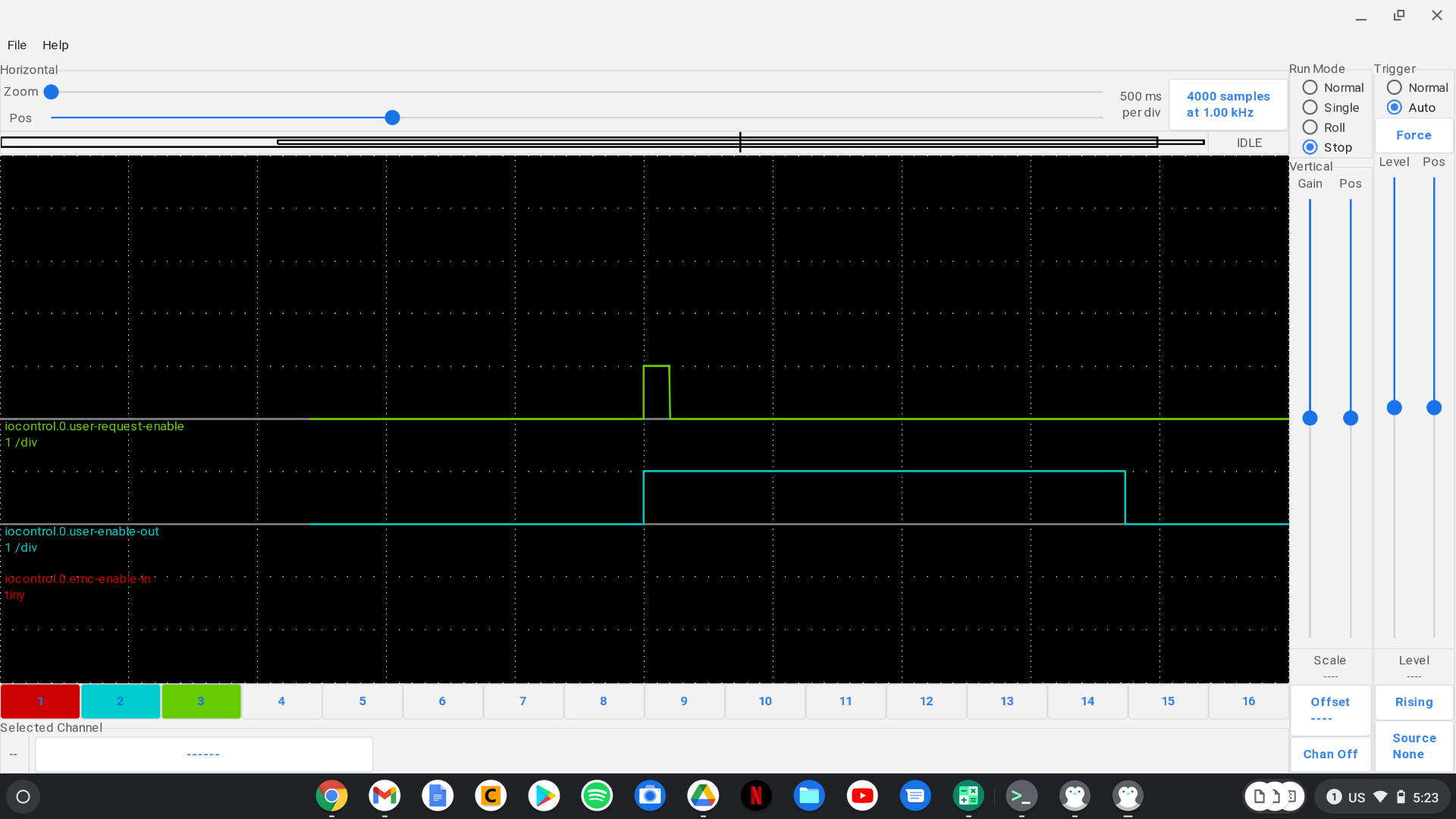

- Posts: 12094
- Thank you received: 4132
24 Jul 2021 06:58 #215742
Replied by rodw on topic QTPlasmac and estop-latch broken (no iocontrol.0.user-request-enable)
Chris, I think it needs a diagram, See attached with 3 estop buttons each with an estop latchHere is my take on how it works
1. Starts with Linuxcnc in a software estop state, the last estop-latch.n.fault-out is true so drives disconnect relays are enabled and warning lights turned on.
2. User enables software estop button.
3. iocontrol.0.user-request-enable goes true and;
4. it is connected to the first latch in the chain (say estop-latch.0.ok-in) and;
5. iocontrol.0.request.enable sends a pulse which is read by all estop_latch-reset components
6. each estop latch checks its does not have an error condition. If all is good, estop-latch.n.ok-out goes true and is passed along to the next latch in the chain.
7. if all estop-latches are error free, the last estop.n.ok-out in the chain goes goes true
8. the last ok-out (estop-latch.2.ok-out) is connected to iocontrol.0.enable-in so the machine comes out of estop, screen button unpresses.
9. If any estop is pressed (including the GUI one), the chain is broken, estop-latch.n.ok-out goes false, the chain is broken and Linuxcnc goes into an estop condition again.
10 Start again at point 2 after estop condition is resolved and relevant fault-in input is cleared (goes false)
- Posts: 12094
24 Jul 2021 07:07 #215743
Page 2 of this thread is what it all looks like in hal.
forum.linuxcnc.org/10-advanced-configura...and-latches?start=20
Estop-latch is not well documented. Itr really needs a worked example.
I had no idea about the pulse on iocpotrol.0.user-enable-out until I fired up halscope a day or so ago.
I think this could be useful to trigger a safety relay. I'll save that for another experiment

- Posts: 12094
25 Jul 2021 07:28 #215841
I've been using a multiple estop latch setup for 5 years with that setup and I've never seen a problem.
If you press the GUI button and an external estop is enabled, it refuses to go out of estop and an error message is displayed.
I've been playing with a safety relay today and that a whole new learning curve and I have not even got to the hal file!
I have to order a different estop switch as it requires a dual terminal normally closed switch!
Looks like the user-request-enable signal is 100 ms long. I don't think it would wait

Based on a bit of work I did last night with a safety relay, I think the state changed as you release the GUI button. If an external estop was enabled at that time, the GUI button did not unpress.
I don't think anything with estop is going to wait around for a few seconds. Its pretty much instantaneous. Get it ready before you take it out of estop or nothing will happen.
I kind of ran out of time last night. I got the safety relay engaging on a GUI estop press but I can't yet see a way to turn the machine off from the GUI. I suspect when I look at my press brake control behaviour, this is pretty normal. On It, I either have to turn off the physical power switch or press the estop to turn off the hydraulic pump (which is in the estop circuit). I'm still thinking about that!
