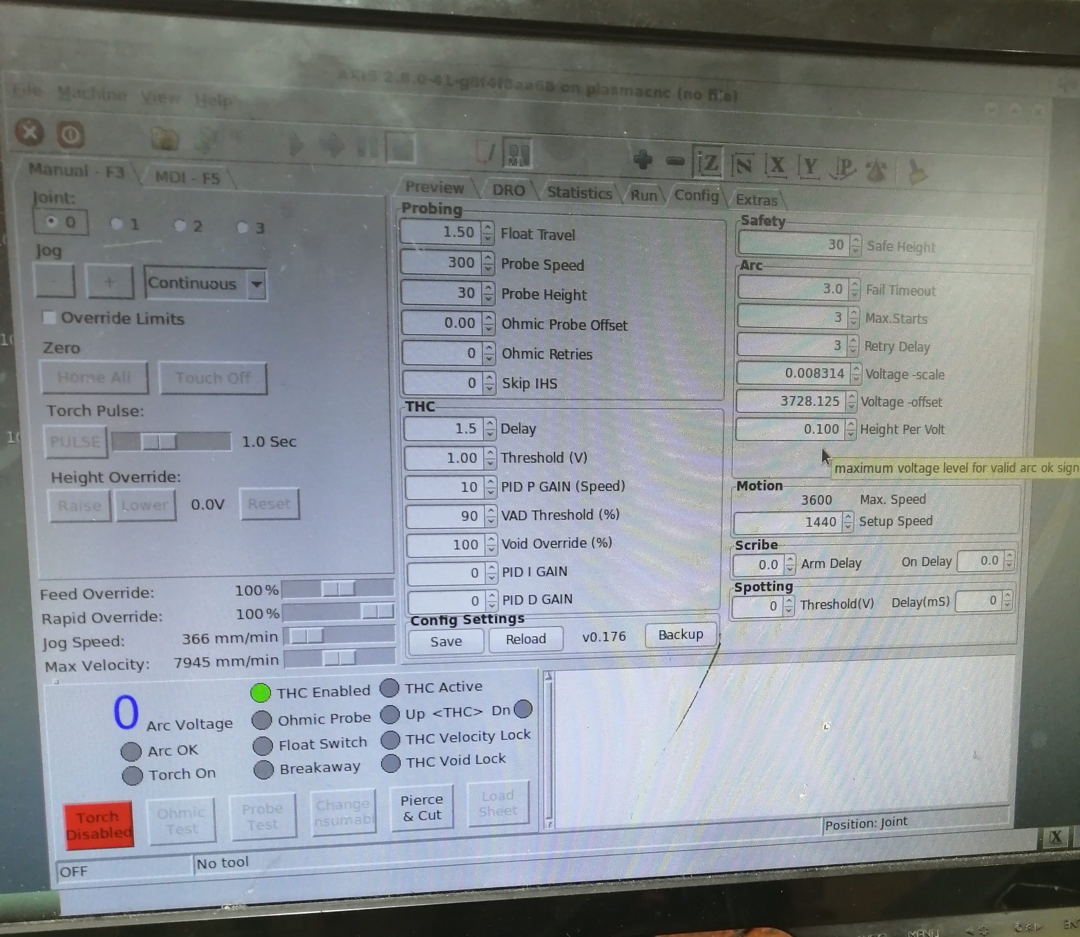

Can someone help me please? I am doing tests with my thcad 10. I see that there are readings of 80 volts when it cuts, but the thc velocity look lights up and the UP and Dn LEDs do not light up at any time. I read about speeds, but it doesn't work anyway.

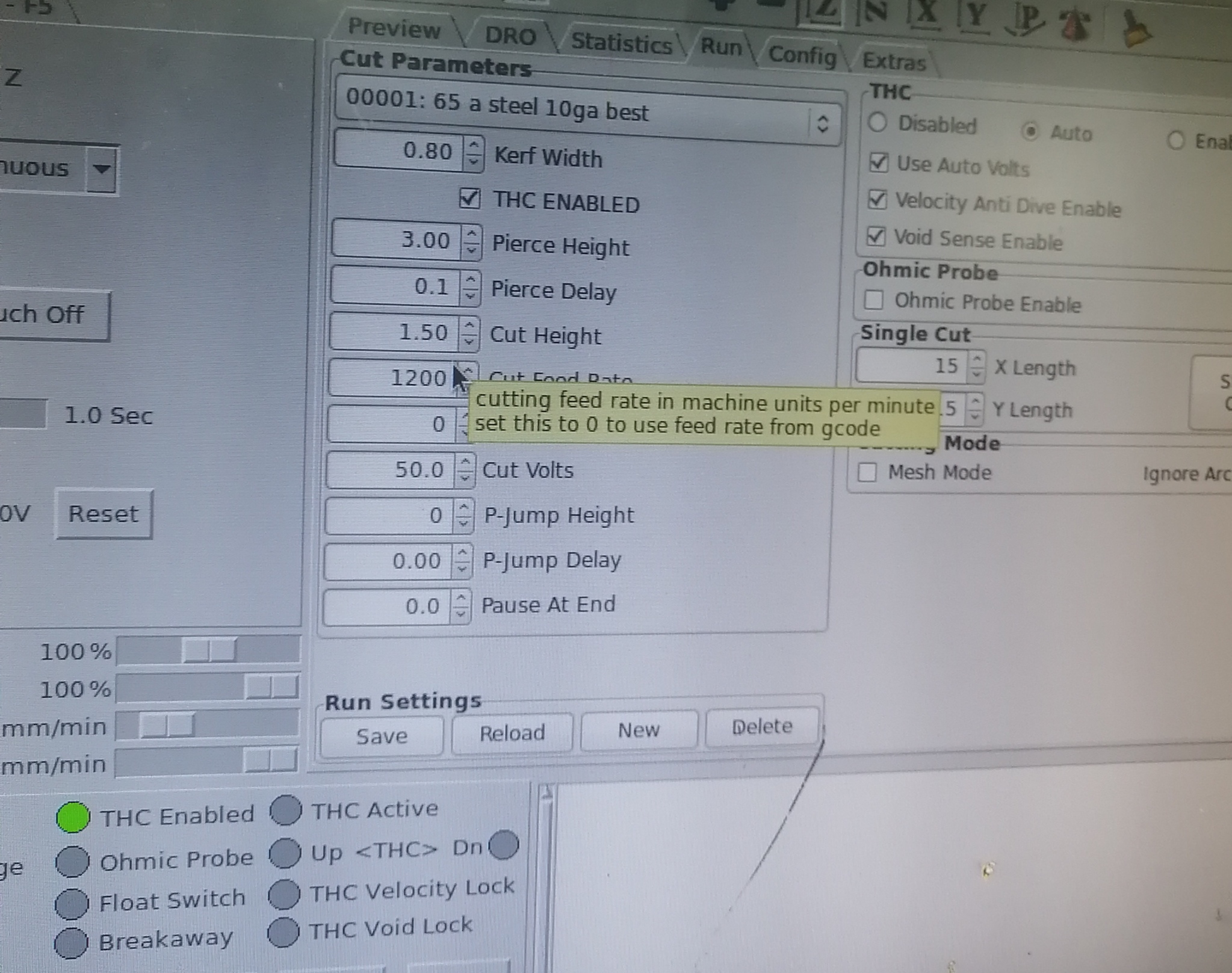

If the Velocity Lock LED is on then it means that the cutting velocity has not reached the Cut Feed Rate that is set in the Cut Parmeters of the Run tab.

Small circles from the wizard are done at 60% feed so the corner lock will be on all the time.
Test with squares.

Like Tommy says, the small holes are set at 60% feed rate so THC is disabled by the velocity. That is normal behaviour.

This line in the code slows the speed to 60% of the cut feed rate:Then this line in thresets the speed to the cut feed rate:You need small circles to be cut at a slower speed, that is standard practice in plasma cutting. If you really want to cut them at full speed then you would need to change the postprocessor to do that.
PlasmaC move the Z axis automatically at the end of the cut. If it hits a physical limit switch then that means you don't have the soft limits set correctly. In the ini file the MAX_LIMIT should be less than the physical maximum limit switch and the MIN_LIMIT should be more than the physical minimum limit switch.
