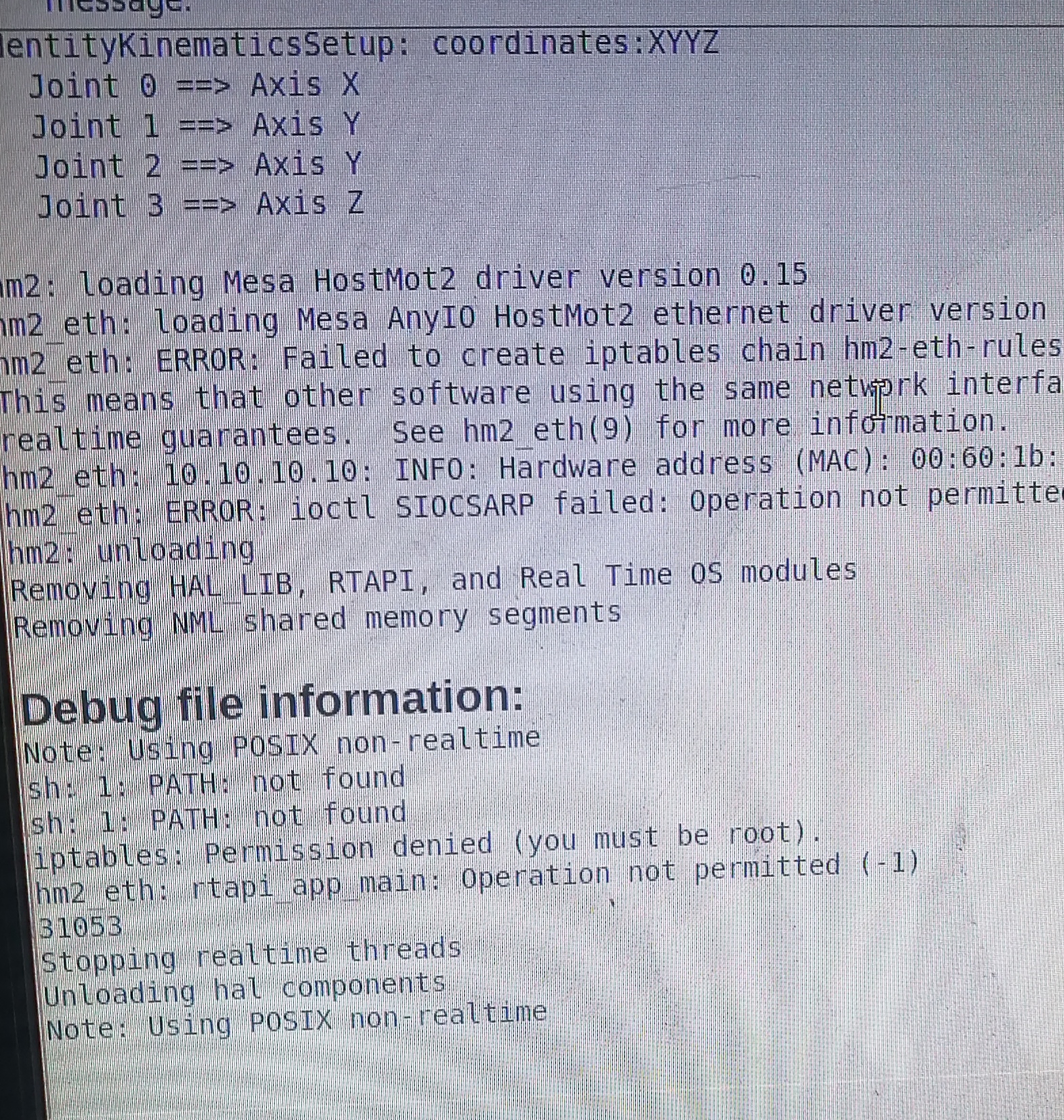

I just updated to version 10 I had it in 9.9 install everything correctly but at the time of executing linuxcnc my configuration I have this error.

The IP address on the PC is wrong, set it to whatever, just not 10.10.10.10 as that is the Mesa board address>

I changed the ip and I have the same error, atualize must be 9 to must 10 and now that I put in the terminal 7i96 I get that it does not recognize I think I have to install the package again but now the configuration tool?

If you fetched a recent LinuxCNC package, there was some breakage
that disabled setuid mode, leading to the type of permission problems
shown. Refetching should fix this.

I'm not sure this is the issue but if you installed a very recent version of LinuxCNC master, you need to re-install LinuxCNC

Reinstall debian 10 buster again and it worked, thanks for your help, also qtplasmac was already updated to the latest version, the configuration backup was a great help without that it was dead.
