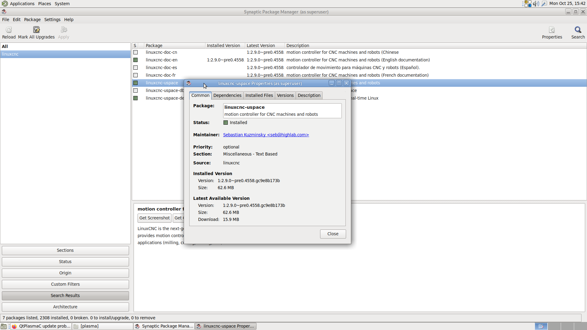

Well, that looks OK, I am stumped...
If you run linuxcnc in a terminal what version is reported in the terminal?
- CFE
- Posts: 193
- Thank you received: 35
25 Oct 2021 04:33 #224195
by CFE
Replied by CFE on topic QtPlasmaC update problem
This one : LINUXCNC - 2.9.0-pre0-4558-gc9e8b173b
- CFE
- Posts: 193
25 Oct 2021 04:34 #224196
by CFE
And that's exactly the same as when I use the icon on our desktop to open linuxcnc

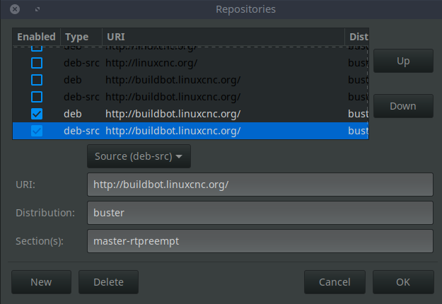

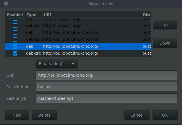

- CFE
- Posts: 193

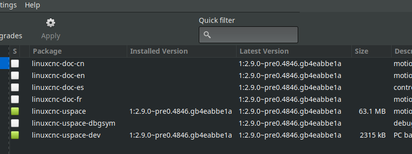

25 Oct 2021 04:45 #224198
by CFE
- phillc54
- Posts: 5711
- Thank you received: 2100
25 Oct 2021 04:51 #224199
by phillc54
Replied by phillc54 on topic QtPlasmaC update problem
- CFE
- Posts: 193
25 Oct 2021 04:58 #224200
by CFE
Hi Phil, done that, and they are as per your image. Try update and dist-upgrade again ?
