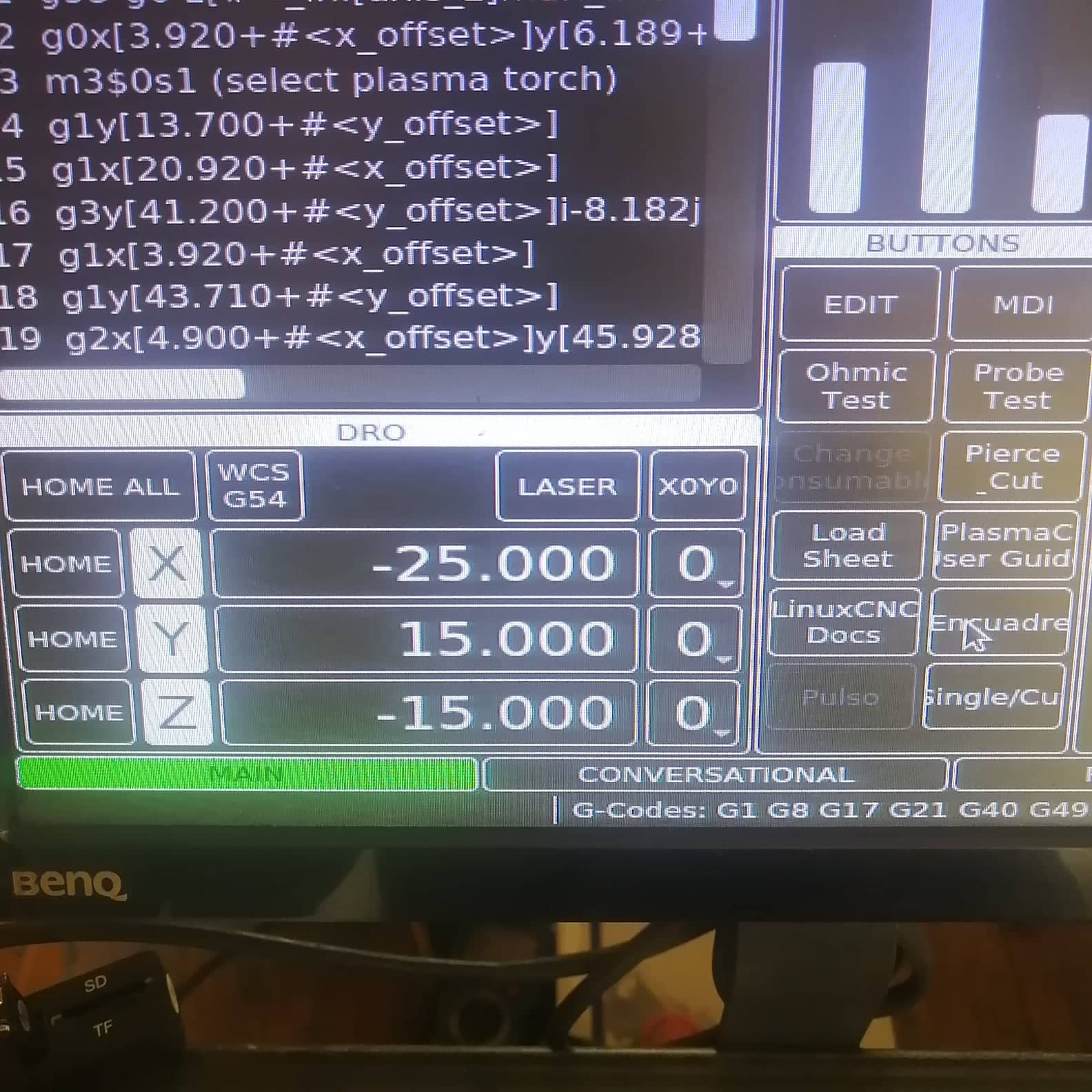

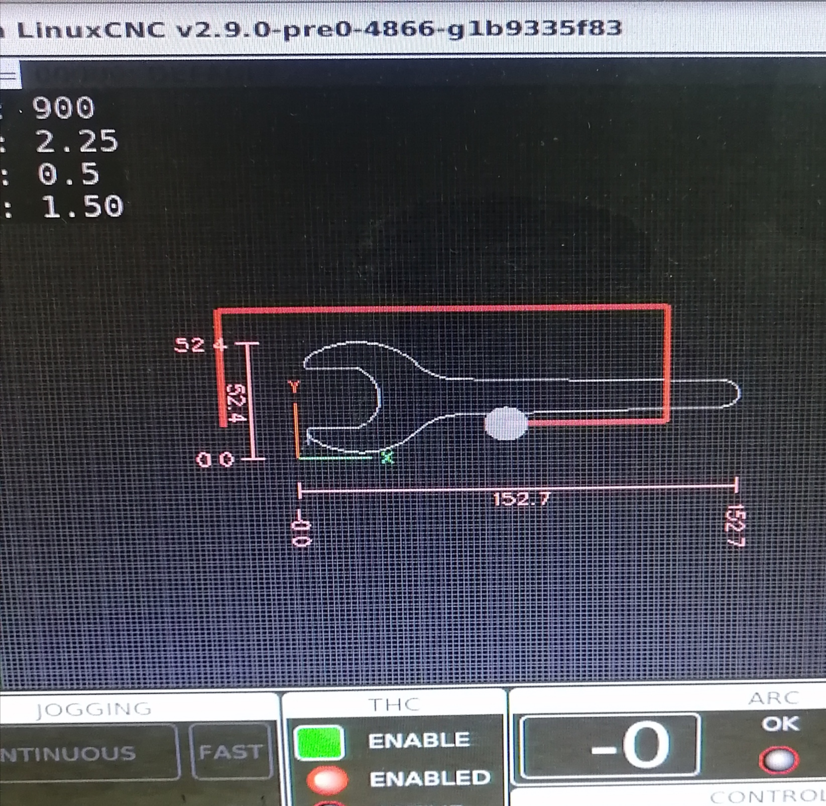

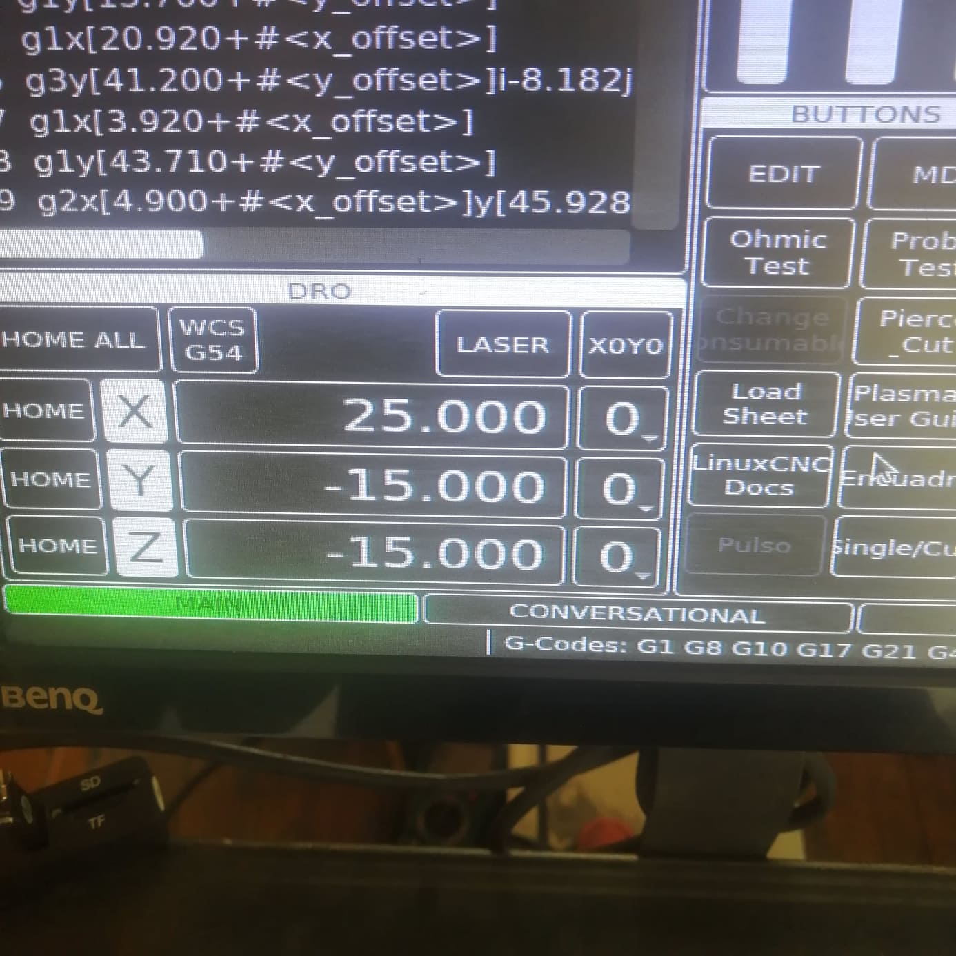

03 Nov 2021 17:36 #225123 by paulsao
Replied by paulsao on topic Framing set origen
Well this is what is happening: the x and y offsets from my laser to the torch are:
x = 25 y = -15
(they are already configured in the .ini file).
The first image shows the coordinates after having pressed the laser button, marked the axis and marked the new origin, right at the point where my torch is located.
x = 25 y = -15
The second image shows the coordinates after using the Framing button, it is seen that the new coordinates are:
x = -25 y = 15
(x = -x and -y = y, they change sign, and I think that here you should go to x = 0 and y = 0 and make the frame from this point since when you press CYCLE START the torch goes to this point x = 0 and = 0).
03 Nov 2021 18:25 #225127 by snowgoer540
Replied by snowgoer540 on topic Framing set origen
x = 25 y = -15
x = 25 y = -15
x = -25 y = 15
This all looks correct to me.
I think you are confused because the framing moves are shown on the plotter with relation to the torch, so they look offset. The whole thing needs to be offset -25 in X and 15 in Y because that's where the laser is. The finish point of X-25Y15 is correct, because that is the coordinate when the laser is over top of the zero point that you set earlier.
I think it might make sense to you if you cut the part out, and then run a framing move to prove to yourself that the laser makes a box around the part that was just cut out.

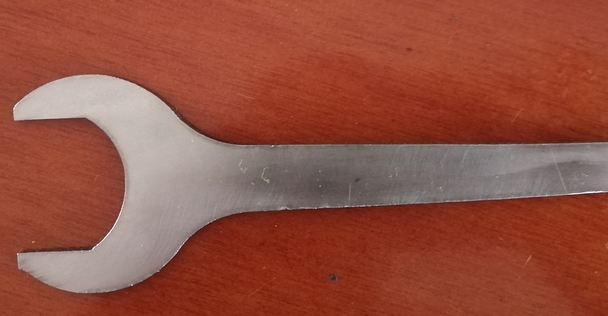

03 Nov 2021 18:57 #225134 by paulsao
Thanks, I just cut the example piece and then tested the framing and it doesn't indicate where the cut should be, this goes through the offsets. Perhaps I am using this function incorrectly, but I indicate that first with the laser I position myself in any part of the sheet and I say my origin where it begins to cut and from there verify if the piece occupied that framed place of use.
