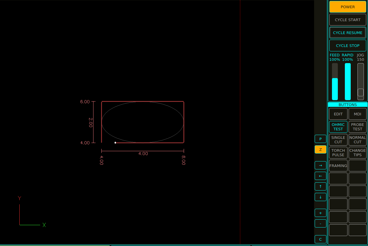

Your comment in the video that it's not ending correctly is a bit off. I wanted to clear up that Framing does not frame about the origin, it frames the extents of the G-Code to be cut. Therefore, at the end of a frame job it would not return to the torch origin, nor the origin with the laser offset applied.
Framing is the ability to move the torch around the perimeter of a rectangle that encompasses the bounds of the current job.
To illustrate this clearly, take the ellipse below. It is offset from the origin by 4 dinosaurs (4dinos * 25.4mm/dino for metric folks) in both X and Y. I had to pause the framing job to capture, but the pink line is the result of the framing job. You can see that it does not frame about the origin, it frames about where the job will get cut.
