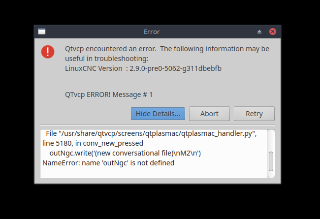

Text from error message. Doesn't matter what i press, QtPlasmaC just shuts down.
File "/usr/share/qtvcp/screens/qtplasmac/qtplasmac_handler.py", line 2089, in <lambda>
self.w.conv_ellipse.pressed.connect(lambda:self.conv_shape_request('conv_ellipse', CONVELLI, True))
File "/usr/share/qtvcp/screens/qtplasmac/qtplasmac_handler.py", line 5278, in conv_shape_request
module.widgets(self, self.w)
File "/usr/lib/python3/dist-packages/qtvcp/lib/qtplasmac/conv_ellipse.py", line 262, in widgets
W.xsEntry = QLineEdit(str(P.xSaved), objectName = 'xsEntry')
AttributeError: 'HandlerClass' object has no attribute 'xSaved'

Start linuxcnc from a terminal and look for any error messagesn in the terminal. From your other thread you seem to be connecting to a pin multiple times.

This one's on me, sorry about that, this was the result of a copy/paste error on line 5179 of the handler.
I submitted a pull request to fix it; thank you for the bug report!
In the meantime, you can work around it by pressing "CLEAR" on the main tab before going into the Conversational

Fix was submitted about 6am my time (PA, USA). I am sure when Phill wakes up and gets to it he will commit the fix.
I assure you I’m more annoyed with myself for missing it than you could be with me.
edit: No real need to revert. Pressing CLEAR before entering the conversational negates the need to press NEW in conversational
