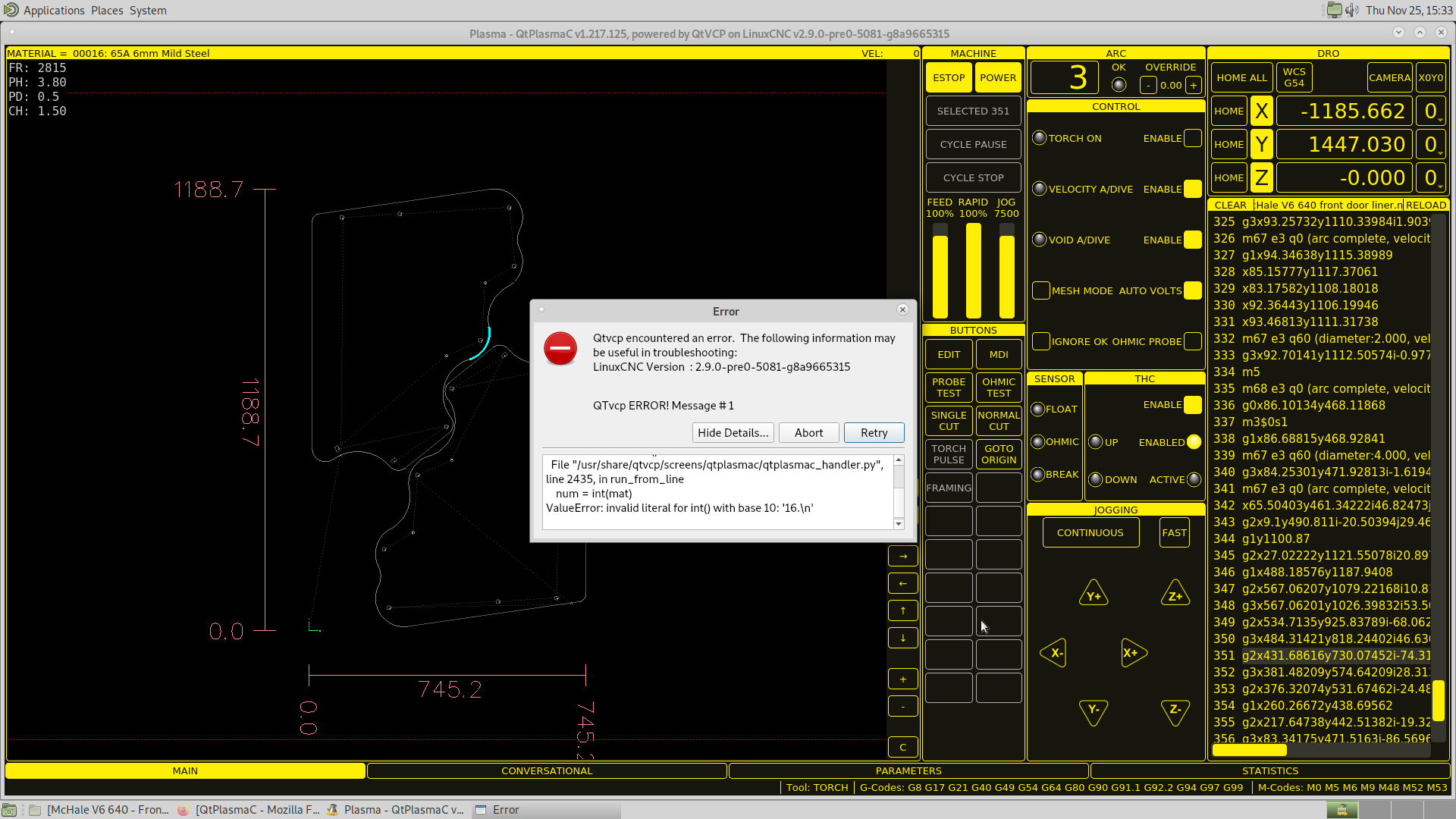

Hi All,
I am having issues with 'Run From Line' command. Every time i try to use this it comes up with error 'QTvcp ERROR! message #1 see photo attached.
Run From Line check box is enabled in the parameters tab. I have read this section in the manual and i have tried both selecting the line in the preview screen and than after restarting QtPlamacC selecting line in G-code window. Then cycle start button changes to 'selected line 351' than i click the selected line button, but rather than the run from window dialog box appearing the following error in photo attached appears, than QTPlasmaC shuts down!!!. i have tried this multiple times, at different positions, on straight lines, on arcs, etc. Every time the same error message shows up than QTPlamaC shuts down when i try and get rid of the message

Can you post your gcode file.
This should be in the PlasmaC section of the forum, we do run from line a bit differently.

Replied by phillc54 on topic Run From Line
No, it is OK, hopefully Tommy will see it and move it.
I can see what is wrong, I have it partially fixed now and I will push it tomorrow.
Try editing this line N20 G17 G91.1 by removing the G91.1 and see if that works for you

I removed the G91.1 from the G-code and tested it as per manual. The same error still shows up than QTPlasmaC shuts down when you remove the error screen.

I see another issue, can you remove the period from the end of this line N50 M190 P16.
Edit: if you click Retry on the error message it may not crash QtPlasmaC
Edit2: I have the fix ready to push if you can confirm that removing the G91.1 and removing the trailing period allow you to run from line correctly.

Success!! once i removed the period as requested, 'Run from line' worked perfectly,

I forgot to try the Retry button this morning but I did try it yesterday and QTPlasmaC seemed to stall, sitting there thinking
