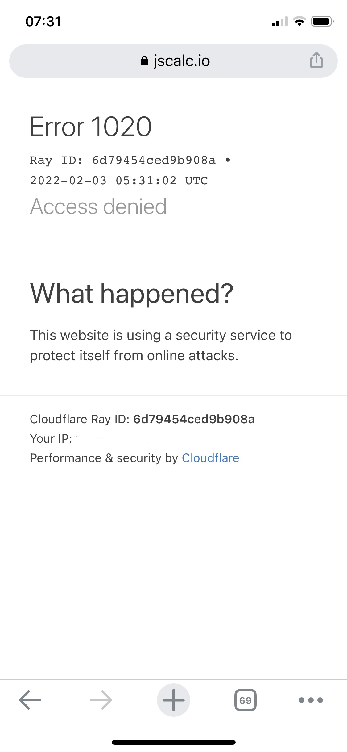

Hi there) I continue working with my cnc plasmas cutter. The problem I faced is can not reach the website jscalc.io/calc/NTr5QDX6WgMThBVb to get coefficient for linuxCNC. Someone have access to that site? Could you please calculate values for my THCAD-10. Factory sticker has info:0 V - 121,3 KHz10 V - 937,7 KHzThanks)

You have not provided enough information, need to know which jumper setting you intend to use (mesa card vs parallel port), and need to know the voltage divider ratio of your plasma cutter.
At any rate, the calculator is just a convenience, the formulas are here: linuxcnc.org/docs/devel/html/plasma/qtpl...c.html#qt_mesa-thcad
