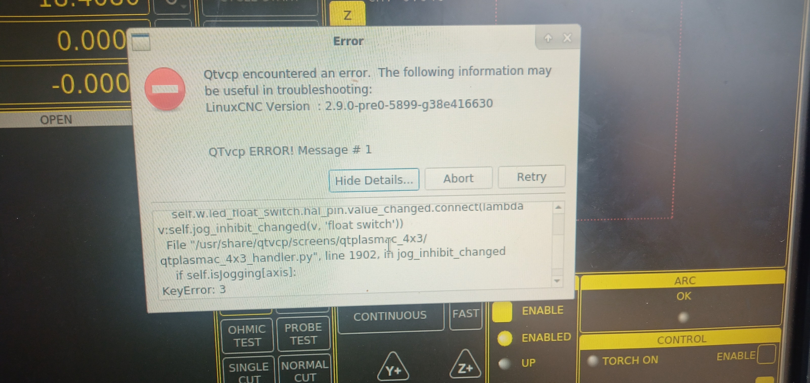

This is a bug in Linux 2.9 QtPlasmaC plasma float switch
see the image below.

27 Feb 2022 08:58 #235898
by phillc54
Replied by phillc54 on topic Qtvcp
Can you describe what you were doing when the error happened.
What version is your QtPlasmaC?

I have the same problem with version 1.221.165 with rip and debian built on machine!
Linux MX21 (Debian 11) The Error comes when you press the float switch and break away!

I have not been able to replicate this issue. Could you post a backup of your config from the BACKUP CONFIG button on the PARAMETERS tab (or SETTINGS tab if using a 4x3 GUI).

Here are the parameters! Converted by plasmac

I was able to replicate this using your config files and push a fix.
Version 1.221.166 should solve your issue, you will have to wait for the buildbot to do its thing though.

It was the float switch when you press it
Give you error message but it has been
Solved by the new update version.
Thank you very much.
