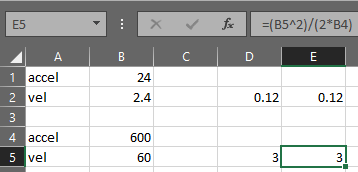

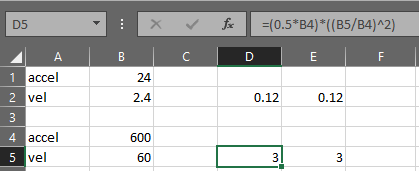

can someone just check the metric math behind the floating head over run
simplifying the formula it is
o = v^2 / (2 x Accel)
think someone forgot to square v/a in the metric calc.
