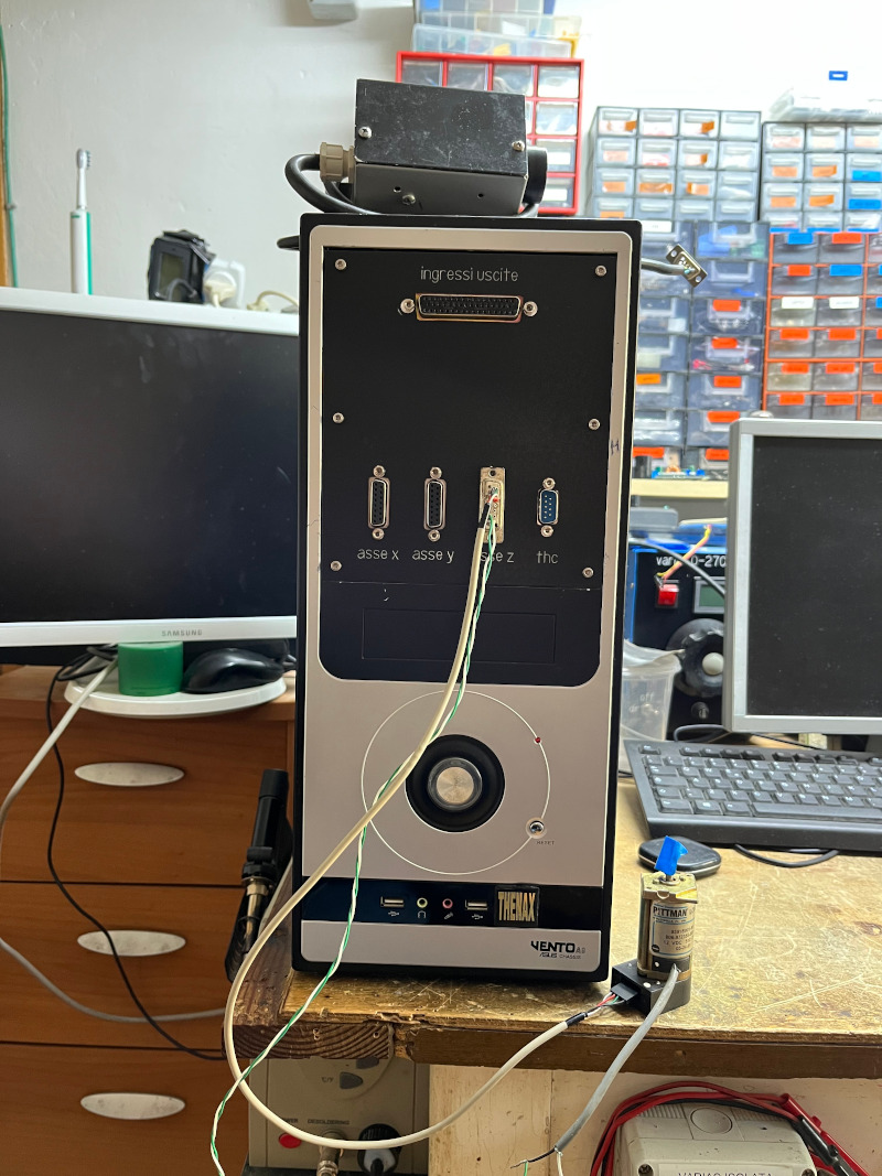

hi, I re-installed qtplasmac for the pci mesa, everything works but the workspace disappears as soon as I move the mouse. I can't explain myself well but the video helps.

I am unsure on the bounding box, that looks like it might be a graphics/driver issue or something like that to me. I don't see that here.
But I do see an "issue" with your X and Y coordinate separating. From memory, to fix that, do the following:
In your INI file in the [KINS] section, remove the following from the KINEMATICS = entry:
You should be all patched up then.

unfortunately I don't have that line ...

Can you post a backup of your config? Made from the parameters (or settings) tab in QtPlasmac.

Here it was for the 7i80 now it is for the 5i23 pci, I only changed references to the card but also the computer.

Sorry, this fell off my radar a bit. I was able to simulate your config (thanks to help from Phill). I don't see either the coordinate system issue, or any issues with things in the preview window disappearing here.
I think the graphical issues with things disappearing can be attributed to the new computer's hardware. Perhaps it's driver related? Sorry I cant be of more help at the moment.

first of all thanks to you and Phill. now I have not tried anymore because I am running out of wiring. could it be a localization problem? I use Italian, once there was a problem.
even turning the z axis encoder after a few counts causes the problem.

I am not sure on the localization, but if it worked on the other computer and your localization was Italian on that one, then I would suspect it's not the issue.
If it's not too difficult you could switch over to English and give it a try.
