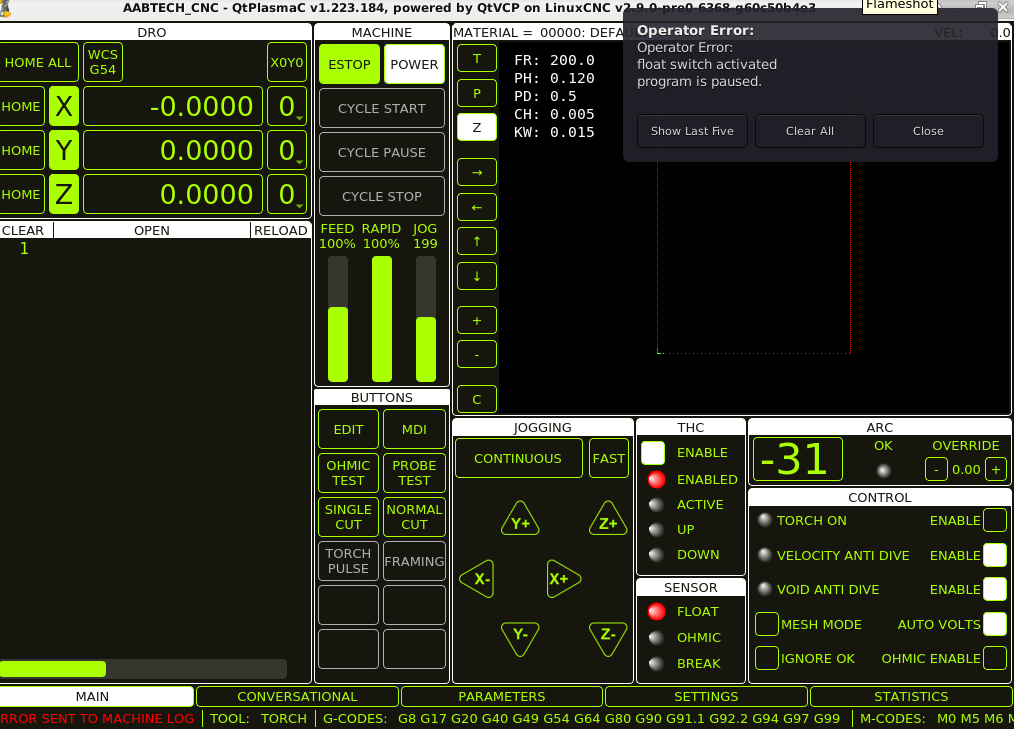

Float switch has disabled jogging
- aabtech
- Posts: 114
- Thank you received: 16
26 Apr 2022 17:40 #241313
by aabtech
Float switch has disabled jogging was created by aabtech
- snowgoer540
- Posts: 2580
- Thank you received: 907
26 Apr 2022 18:01 #241316
by snowgoer540
Replied by snowgoer540 on topic Float switch has disabled jogging

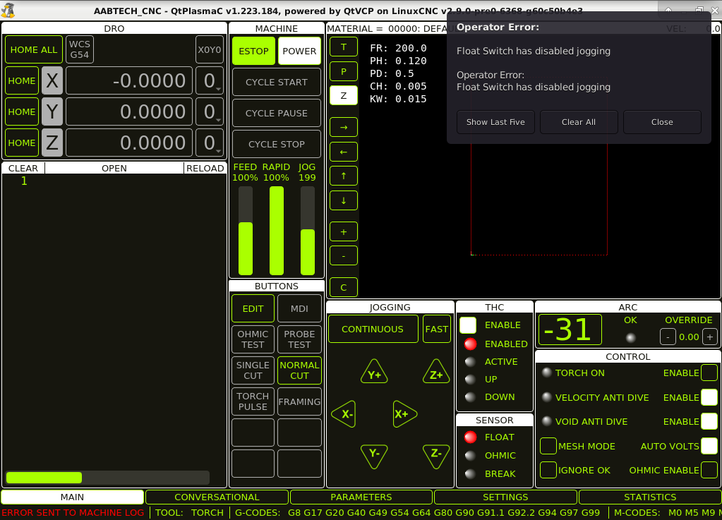

The float switch indicator is indeed active in both pictures. When you disconnected the switch if you have the input inverted it will expect to have a closed circuit. You may have to invert the input again, or just disconnect it in Hal.
- aabtech
- Posts: 114
26 Apr 2022 20:39 #241331
by aabtech
Replied by aabtech on topic Float switch has disabled jogging
Which means I can't use the float switch?
- Posts: 21990
- Thank you received: 7487
26 Apr 2022 20:55 #241333
You CAN use the switch, just invert it in HAL.
Replied by tommylight on topic Float switch has disabled jogging
No.Which means I can't use the float switch?
- snowgoer540
- Posts: 2580
26 Apr 2022 21:53 #241340
by snowgoer540
Sorry I may have misunderstood your first post.
To invert the input just add -not to the end of the input. Or if you used pncconf you can go back in and just click “invert” next to the input.
