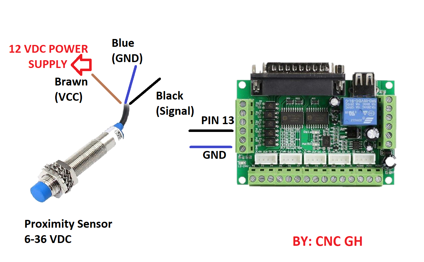

- aabtech
- Posts: 114
- Thank you received: 16
04 May 2022 15:39 #241986
by aabtech
Replied by aabtech on topic Mesa 7i92 to BOB all home switch
Yes the pin is working correctly .
I tested each switch with BOB pin 15 and it was working but if I add all together it doesn't work.

- aabtech
- Posts: 114
04 May 2022 18:41 - 04 May 2022 18:47 #241992
by aabtech
Last edit: 04 May 2022 18:47 by aabtech.

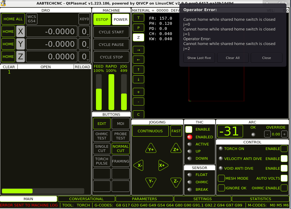

- Posts: 12156
- Thank you received: 4149
04 May 2022 19:09 #241995
Replied by rodw on topic Mesa 7i92 to BOB all home switch
you need HOME_IS_SHARED=1 in your ini file for all shared homing joints
Ref: linuxcnc.org/docs/devel/html/config/ini-...html#_home_is_shared
- aabtech
- Posts: 114
23 May 2022 14:50 - 23 May 2022 15:04 #243618
by aabtech
It is working, my HOME_IS_SHARED=1 in the INI was 1 and I made it 0.thanks very much.
