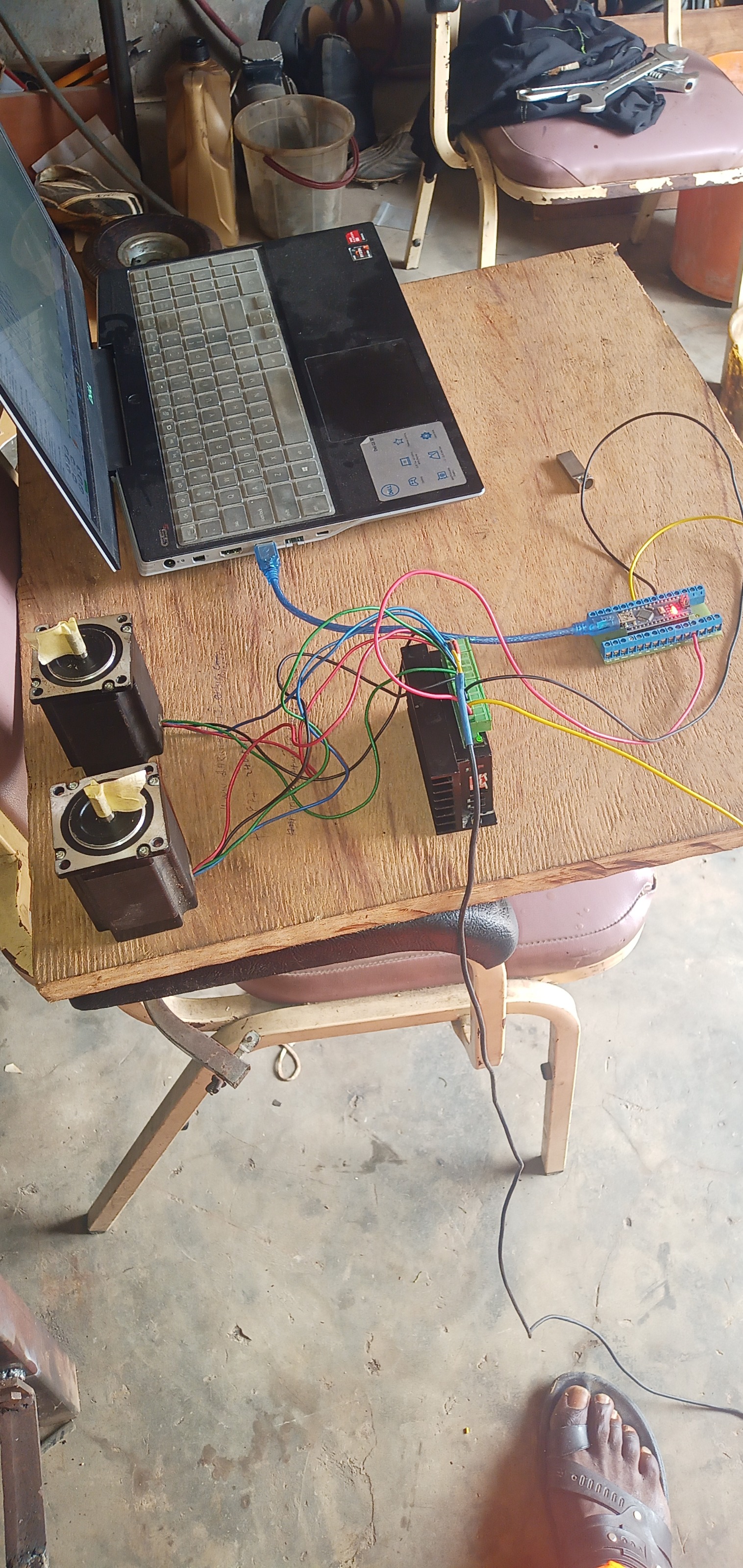

Hi, my question is, is it advisable to use one stepper driver
with two stepper motor for your Y Axis.

But Linuxcnc makes it easy to use two motors and keep them in sync and is arguably easier to design as you don't need a cantilevered gantry or a shaft spanning the table.
Replied by rodw on topic Using one stepper Driver with two stepper motor
It depends.. If your design criteria can be met with one motor why not?Hi, my question is, is it advisable to use one stepper driver

Would not recommend. Will probably seem fine without load, but torque under load will be uneven.

Important note, wires must be same type and same length for parallel wiring. For serial it does not matter.

I would definitely be wiring the motors in series. It's the only way to keep the current equal.

How to use Linuxcnc to use two motors and keep them in sync?
30 May 2022 00:50 #244169
eg
loadrt trivkins coordinates=XYYZ
Replied by andypugh on topic Using one stepper Driver with two stepper motor
The preferred way (assuming that you are talking about using two motors on one machine axis) is to use two drivers and two sets of step-dir pins and set up two joints in the kinematics.How to use Linuxcnc to use two motors and keep them in sync?
eg
