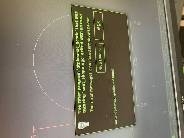

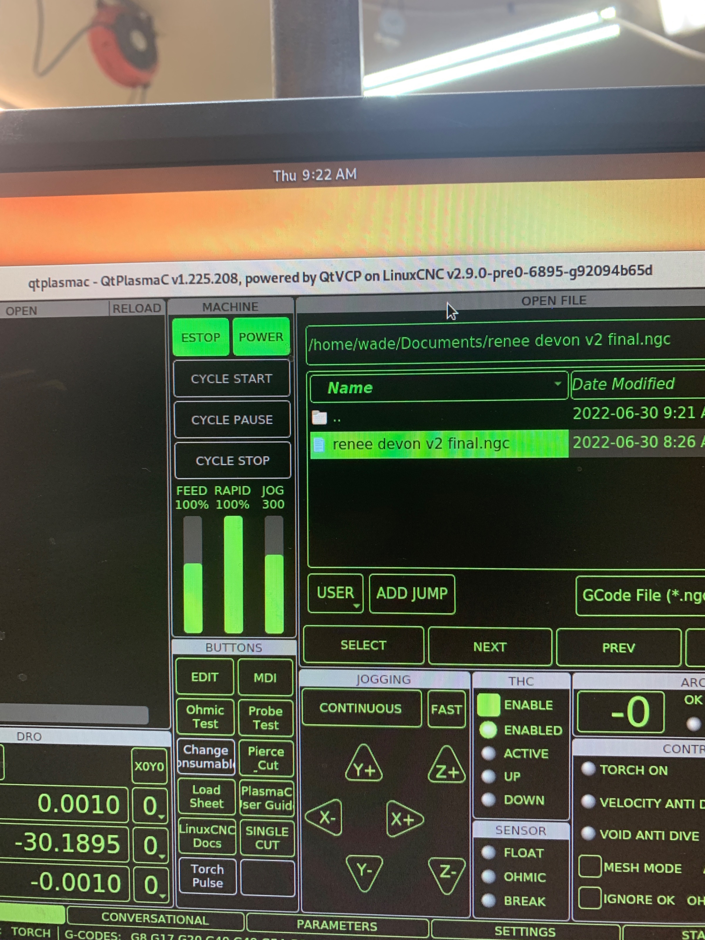

Hi all, I tried my machine today and I get the error gcode not found. I get this error using conversational or uploading a file from sheetcam.
Everything else appears to be working.
Traceback (most recent call last):File "/usr/share/qtvcp/screens/qtplasmac_4x3/qtplasmac_4x3_handler.py", line 2501, in <lambda>self.w.main_tab_widget.currentChanged.connect(lambda w:self.main_tab_changed(w))File "/usr/share/qtvcp/screens/qtplasmac_4x3/qtplasmac_4x3_handler.py", line 2026, in main_tab_changedself.CONV.conv_setup(self, self.w)File "/usr/lib/python3/dist-packages/qtvcp/lib/qtplasmac/conversational.py", line 76, in conv_setupCOPY(P.filteredBkp, P.fNgc)File "/usr/lib/python3.7/shutil.py", line 245, in copycopyfile(src, dst, follow_symlinks=follow_symlinks)File "/usr/lib/python3.7/shutil.py", line 120, in copyfilewith open(src, 'rb') as fsrc:FileNotFoundError: [Errno 2] No such file or directory: '/tmp/qtplasmac/filtered_bkp.ngc'

It looks like a recent update did not go to plan.
In the .ini file for the [FILTER] section it should read:
Do you have a package installation or run in place?
EDIT: Could you try restarting LinuxCNC to see if that fixes it.
EDIT2: See next post.
PROGRAM_EXTENSION = .ngc,.nc,.tap GCode File (*.ngc, *.nc, *.tap)
ngc = qtplasmac_gcode
nc = qtplasmac_gcode
tap = qtplasmac_gcodeEDIT2: See next post.
