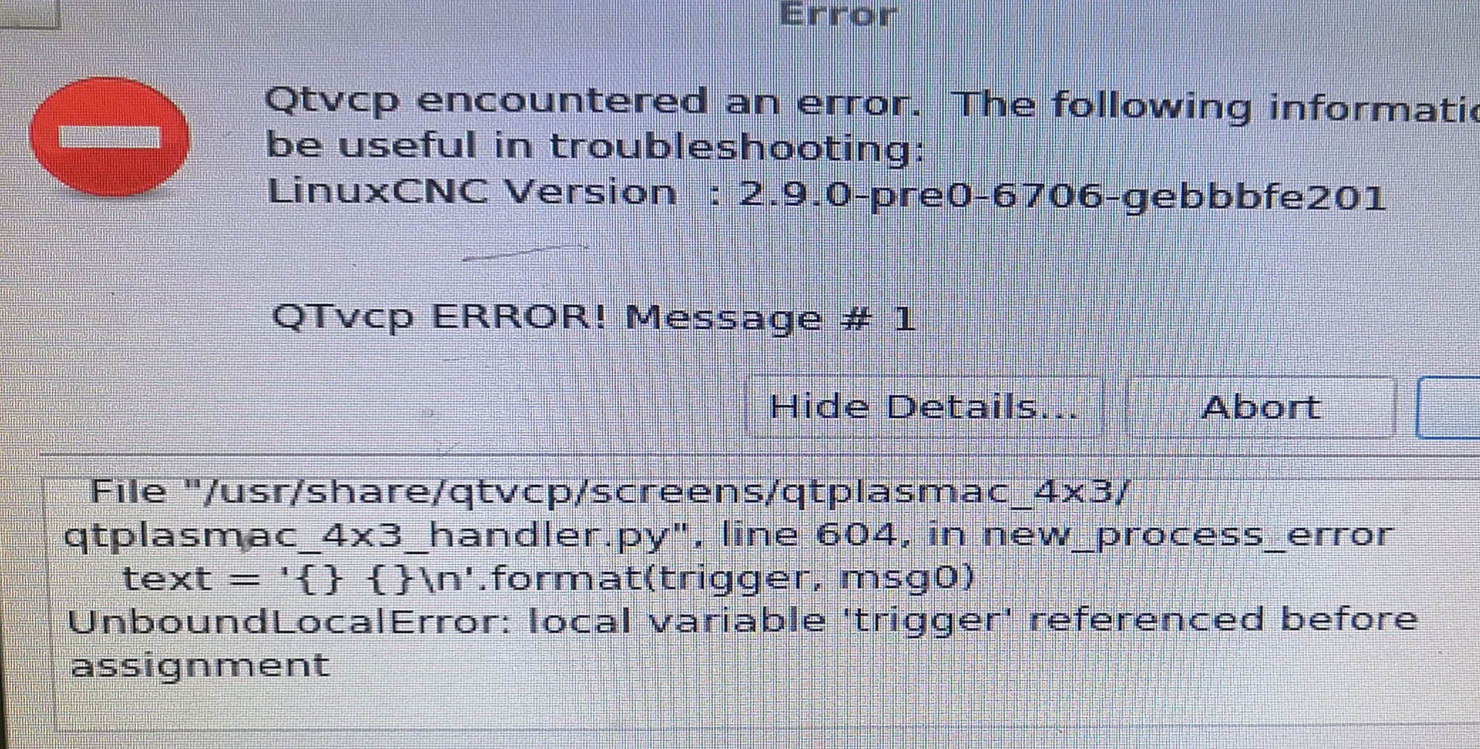

Greetings to all can someone help me see why I have this error in Qtplasmac v1. 224.206

I am guessing it doesn't happen all the time, and also that you get the error on startup?
I have seen this in testing I was doing recently, but thought it was related to the changes I made (that are not pushed yet).
I understand what is causing the specific error, but assuming that you get it on startup, I have to lock down where the jog-inhibit error is coming from that early in the process.
Just out of curiosity, have you done any other linking to motion.jog-inhibit pin?

Actually I never have the error when I'm cutting, but now I realize that the error comes when I try the float switch and it exceeded the value of z min (since I don't have a limit switch that indicates the minimum but the float switch helps me in that haha) then that error appears when I move the jog at that moment.

That is the exact info I needed; I’ll post back when I’ve submitted a fix.

Should be fixed whenever the buildbot is done building v1.227.213
