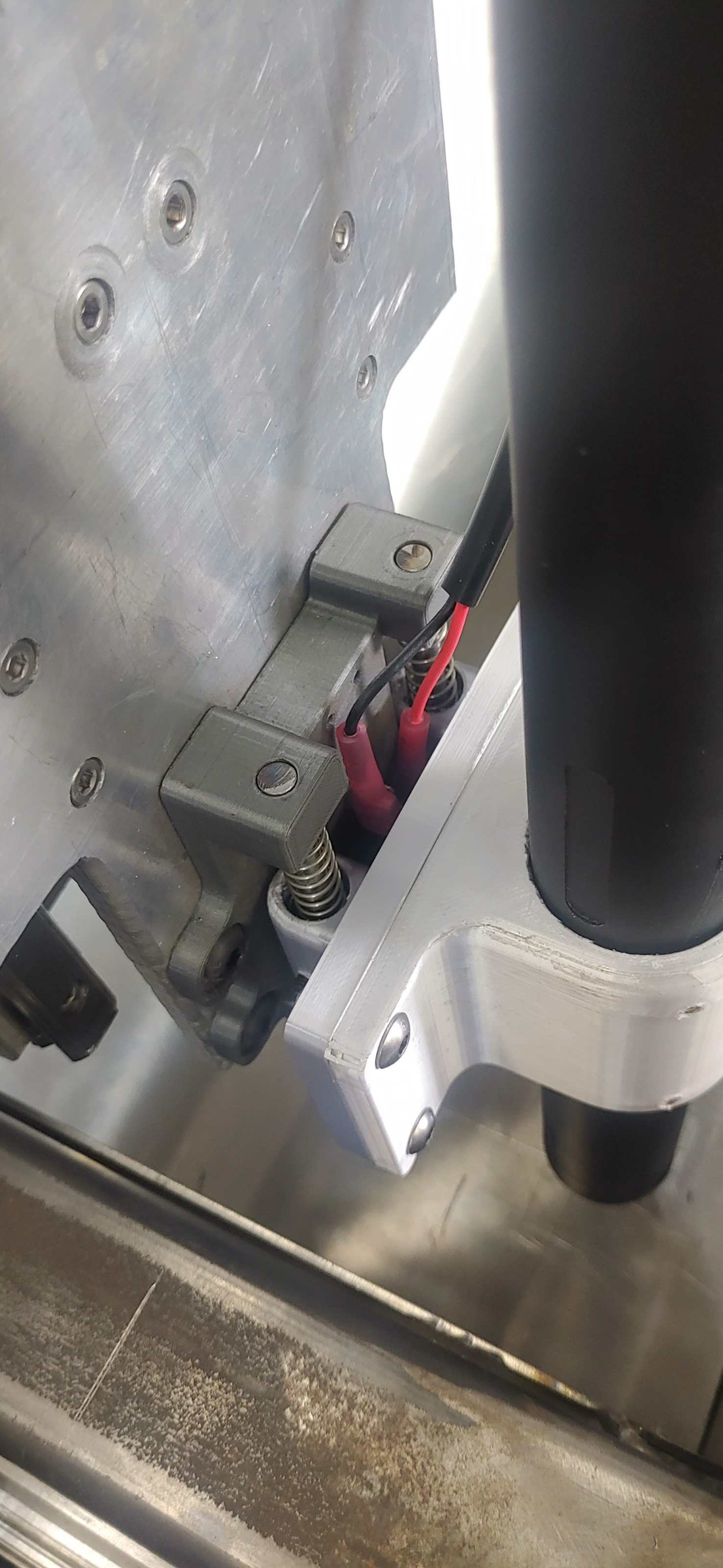

I have a floating head and it is working properly with the home offset configured and such. I thought I was ready to go through the PlamsaC config and everything in the docs made sense but once completed it gave me an error when I tried to launch saying my Z input was already used for home/limit. It would seem to be redundant to put another switch on the Z axis

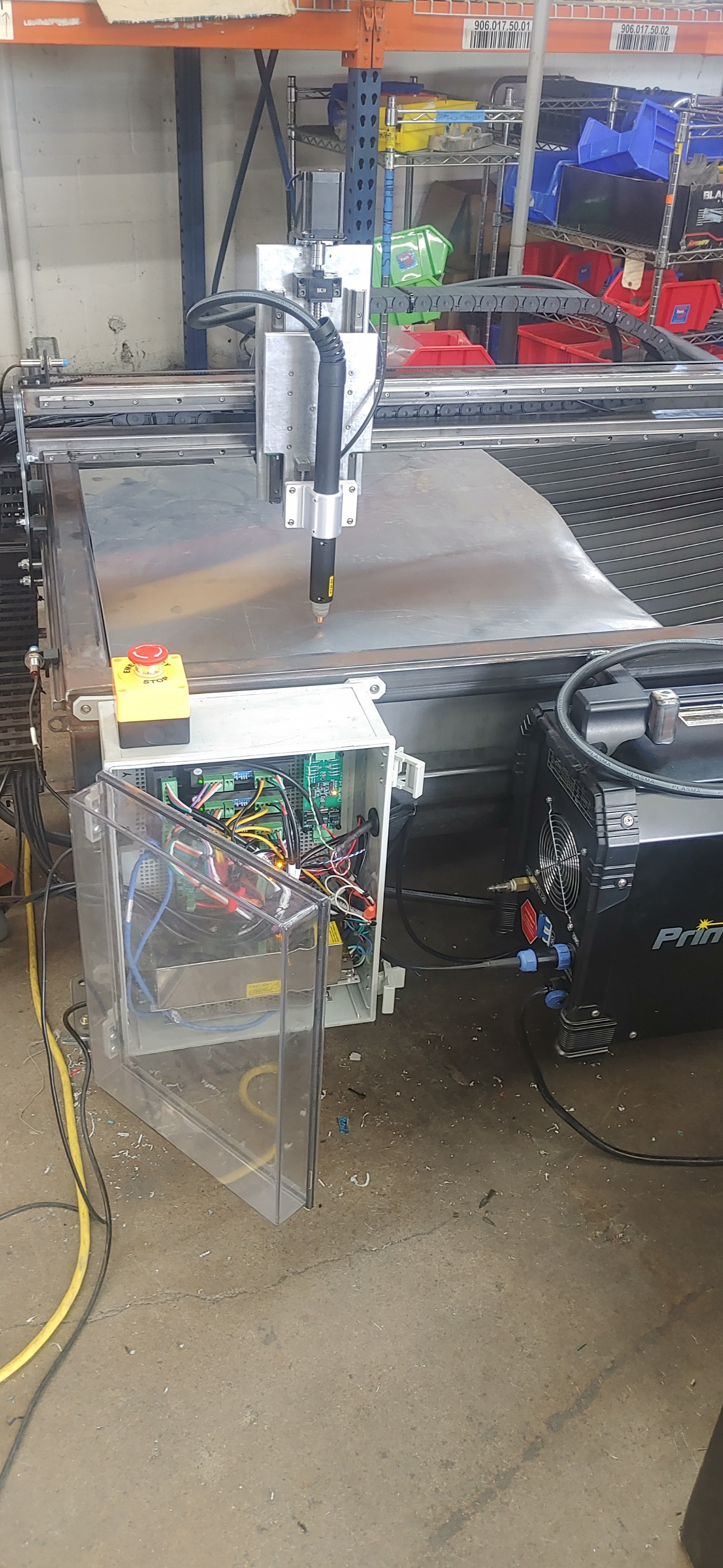

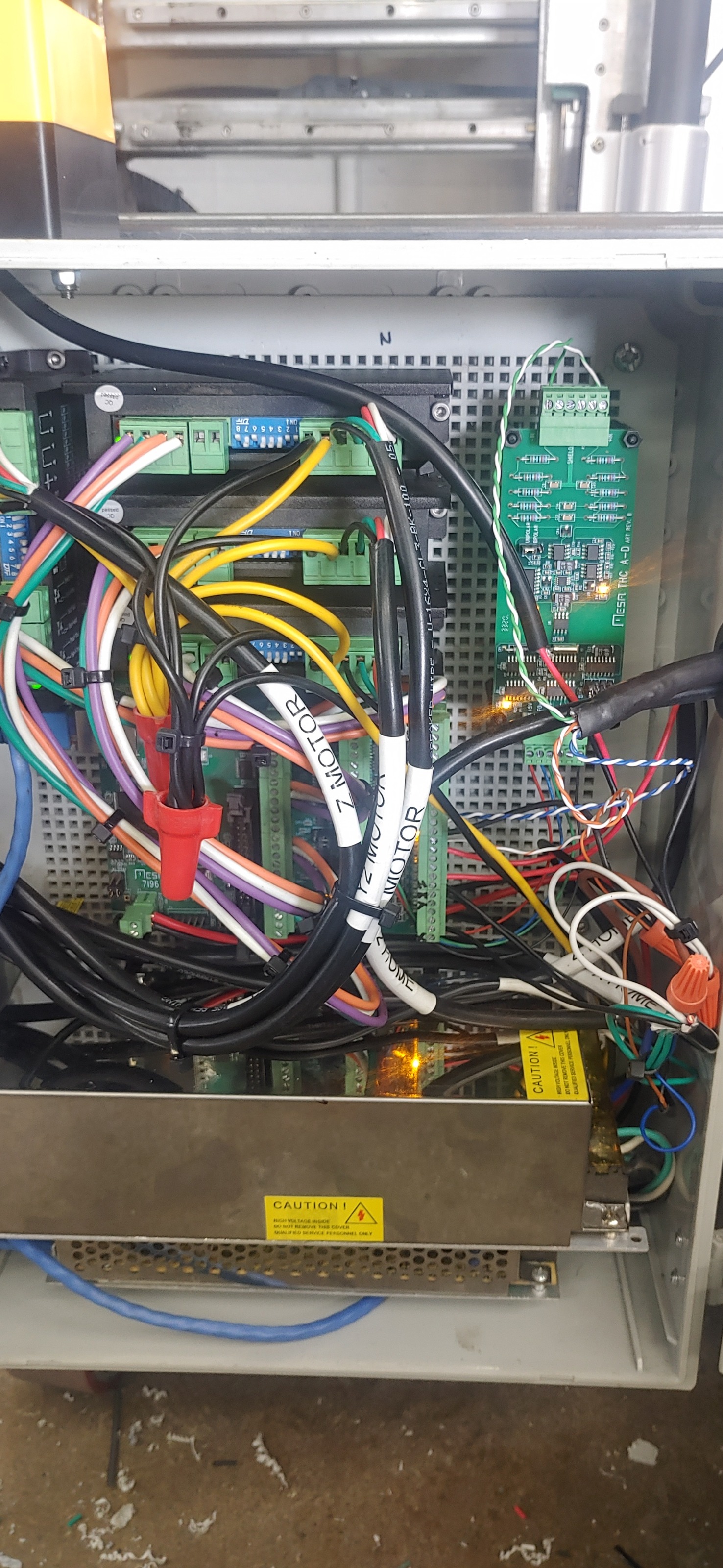

Here is some pictures and a quick video of where I'm at with it. I've been stuck at this point for two days now trying to get the PlasmaC GUI to launch!

Home/limit switch has nothing to do with the float switch mechanics, it should be mounted at the top of your Z axis so it is triggered by the moving Z plate/torch holder.

Did you see the picture of my torch mount and the switch inside it?

Home switch = top of z axis, not where the float is.

I understand now. Thank you for your patience! So basically what I built is a float switch and I need to add a home/limit switch.

Replied by tommylight on topic Float switch must be different than Z home switch?
Yes, exactly.
