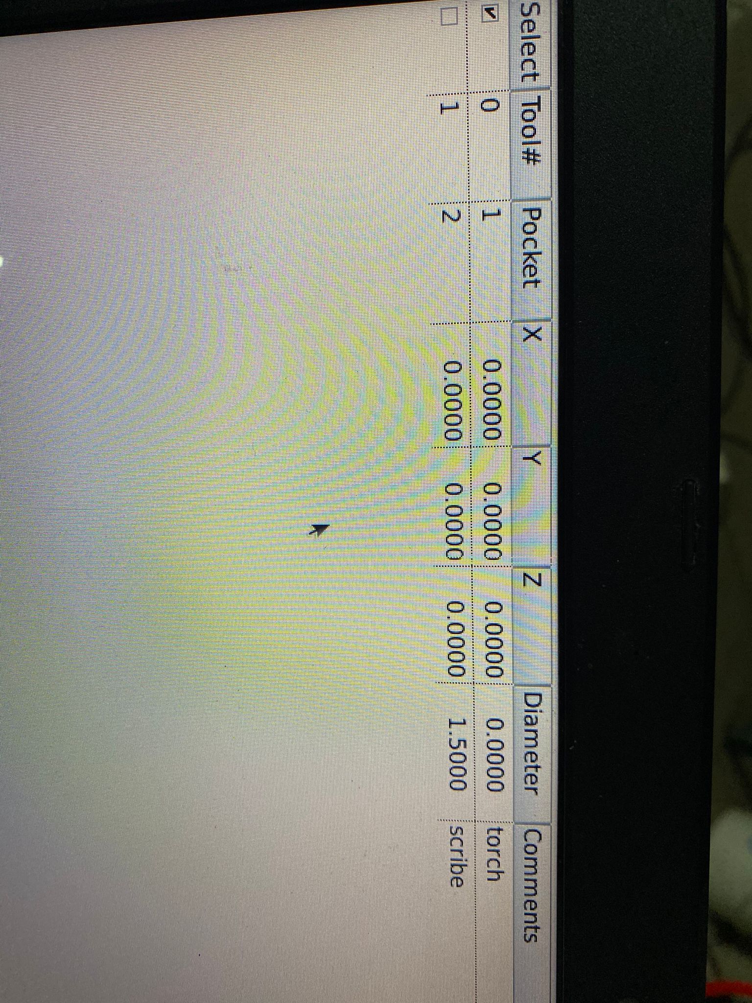

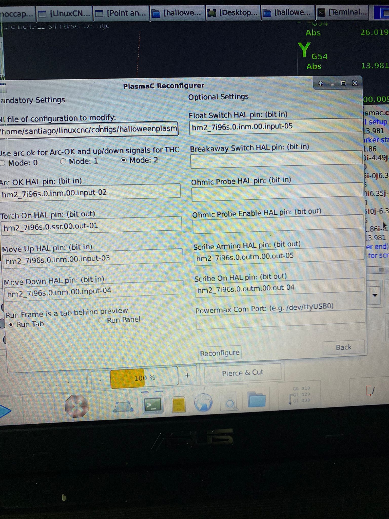

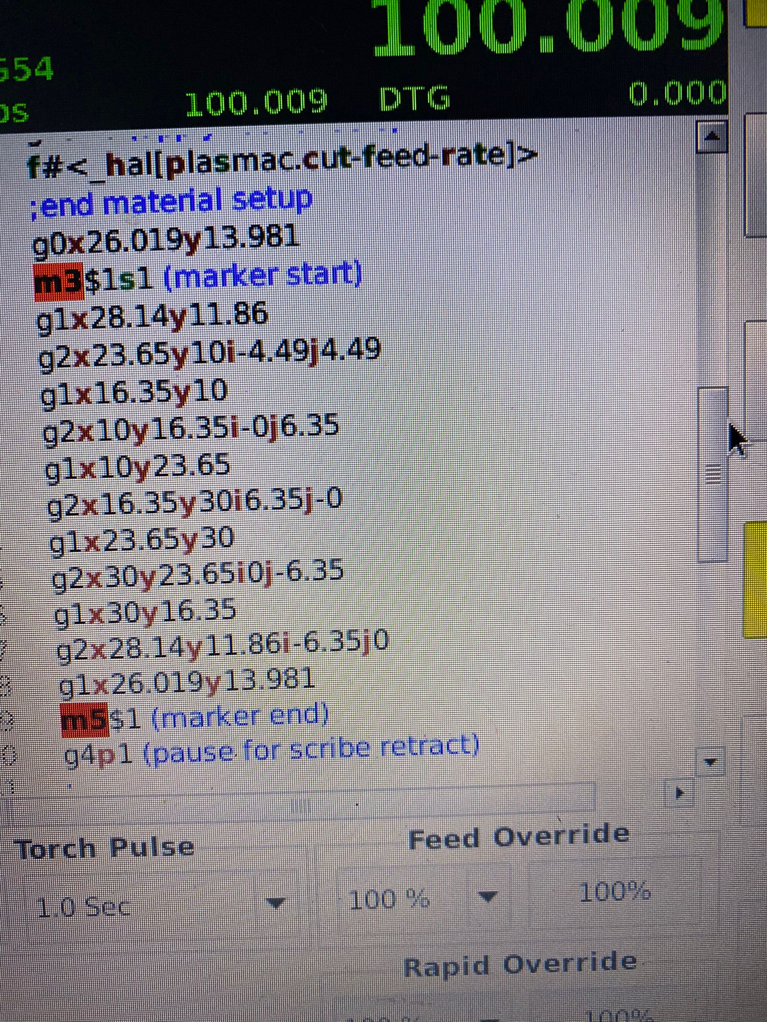

Hello.
I have been trying to set up the scribe in PlasmaC. I have the M3 $1 line of code from the post processor, and a #1 tool defined, but it doesn't translate into the activation of the correct outputs. i have tested the outputs with a mill config, associated with mist/flood buttons, and they work. but not while reading a gcode file in PlasmaC. What is it i should do?
here are my config and gcode files.
PS: Btw, this board ( 7i96s) has 5 outputs. i can use the 2 last outputs (4, and 5) which im currently using as relays to trigger the scribe piston and scribe ON, but i can't use the #1, #2, #3 (ssr outputs also), any tips on wiring them? should i use lower voltages?

Replied by phillc54 on topic Can't use scribe in PlasmaC + Sheetcam.
You also need a tool change command to switch to the scribe and apply the offsets.
linuxcnc.org/docs/2.8/html/plasma/plasma...er-guide.html#scribe

Replied by santy on topic Can't use scribe in PlasmaC + Sheetcam.
thank you so much. you solved my problem right away, i can now use the scriber!
