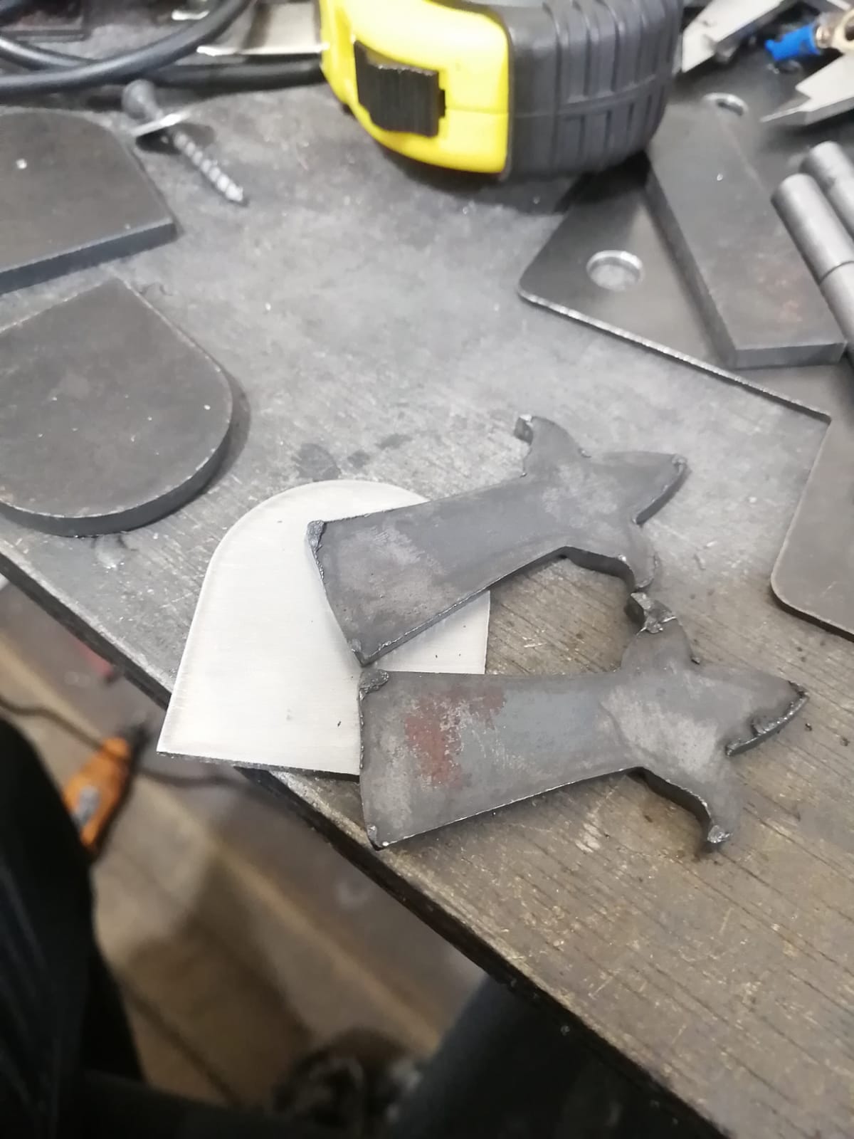

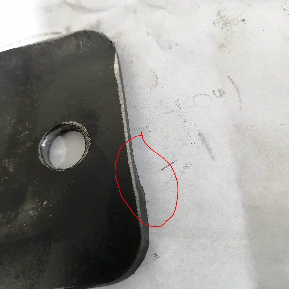

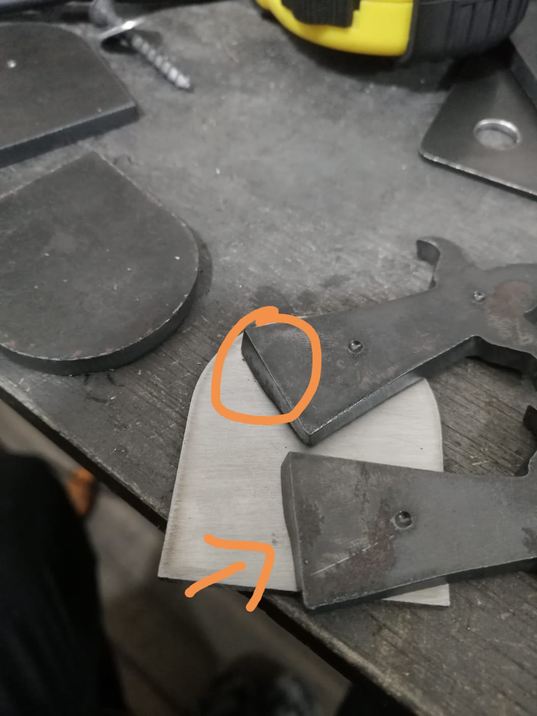

Greetings to all.
If anyone has experience or has gone through this, the question is why does this lag occur in the cut?

-cutting to fast
-air pressure low
-current low for given thickness
-vorn nozzle
Should have posted a picture of the under side also, before cleaning.
-air pressure low
-vorn nozzle
